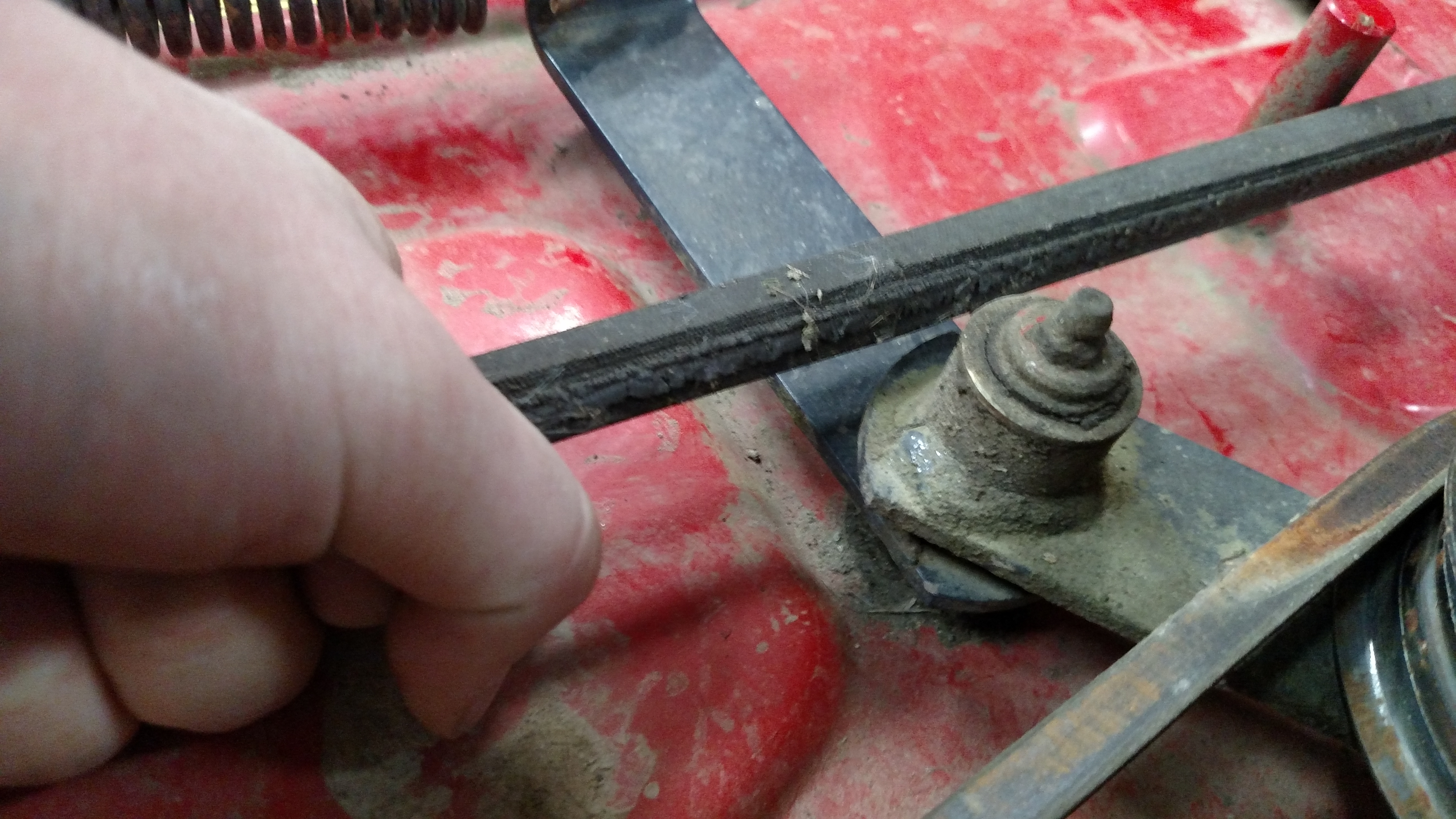

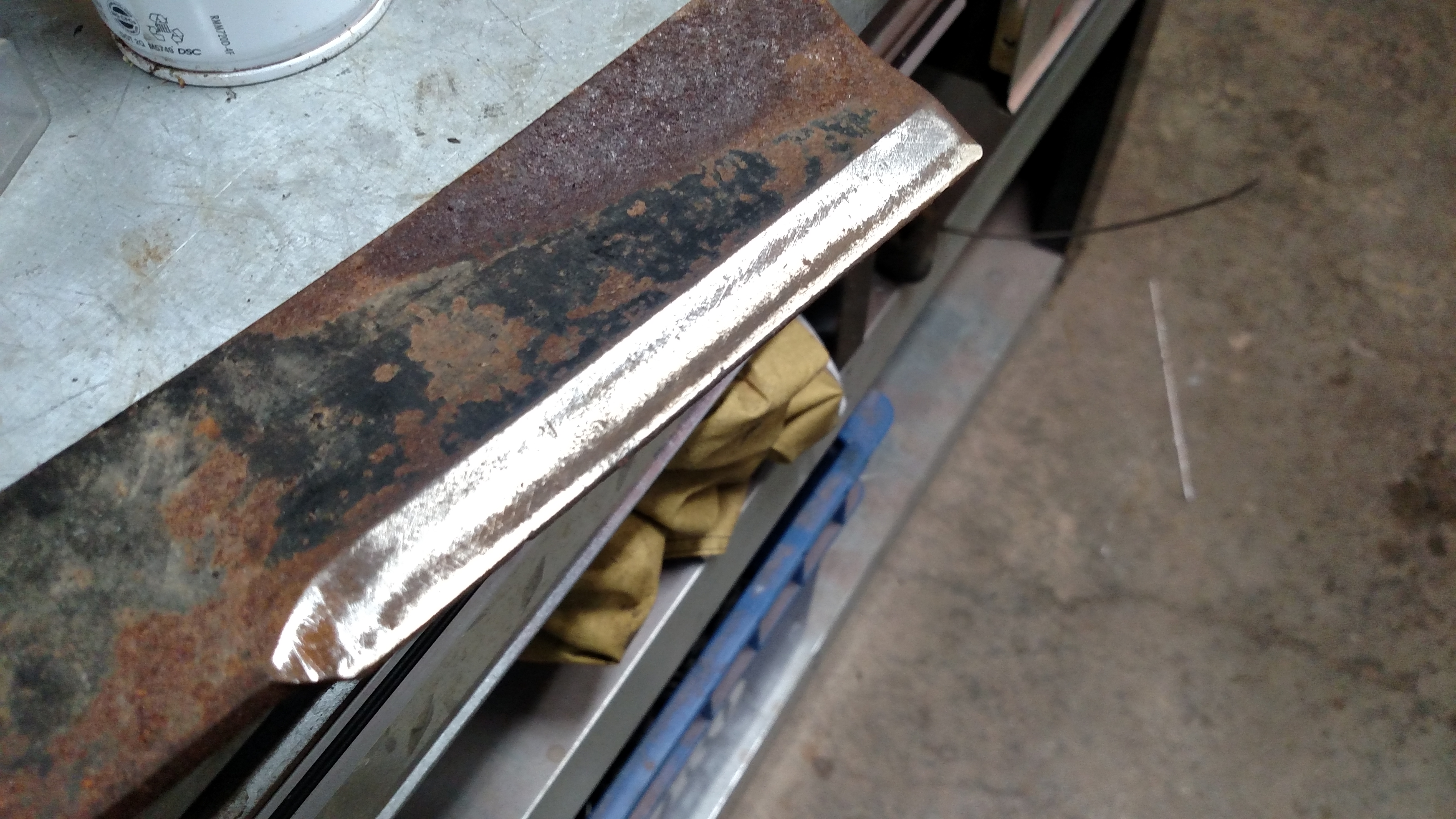

Just a FYI thread... I bought a barely used MMM for $1000 yesterday. The bottom of the belt was slightly damaged as if it was rubbing on something - upon futher investigation i found that as the belt vibrated it would rub on the idler pulley bracket ever so slightly. The sharp corner was damaging the lower part of the belt. I simply broke/ "rounded" the sharp edge amd tightened the belt a bit more. Also sharpened the blades, greased, checked gearbox oil, and ordered a spare belt to have around. Seems like a good quality deck.

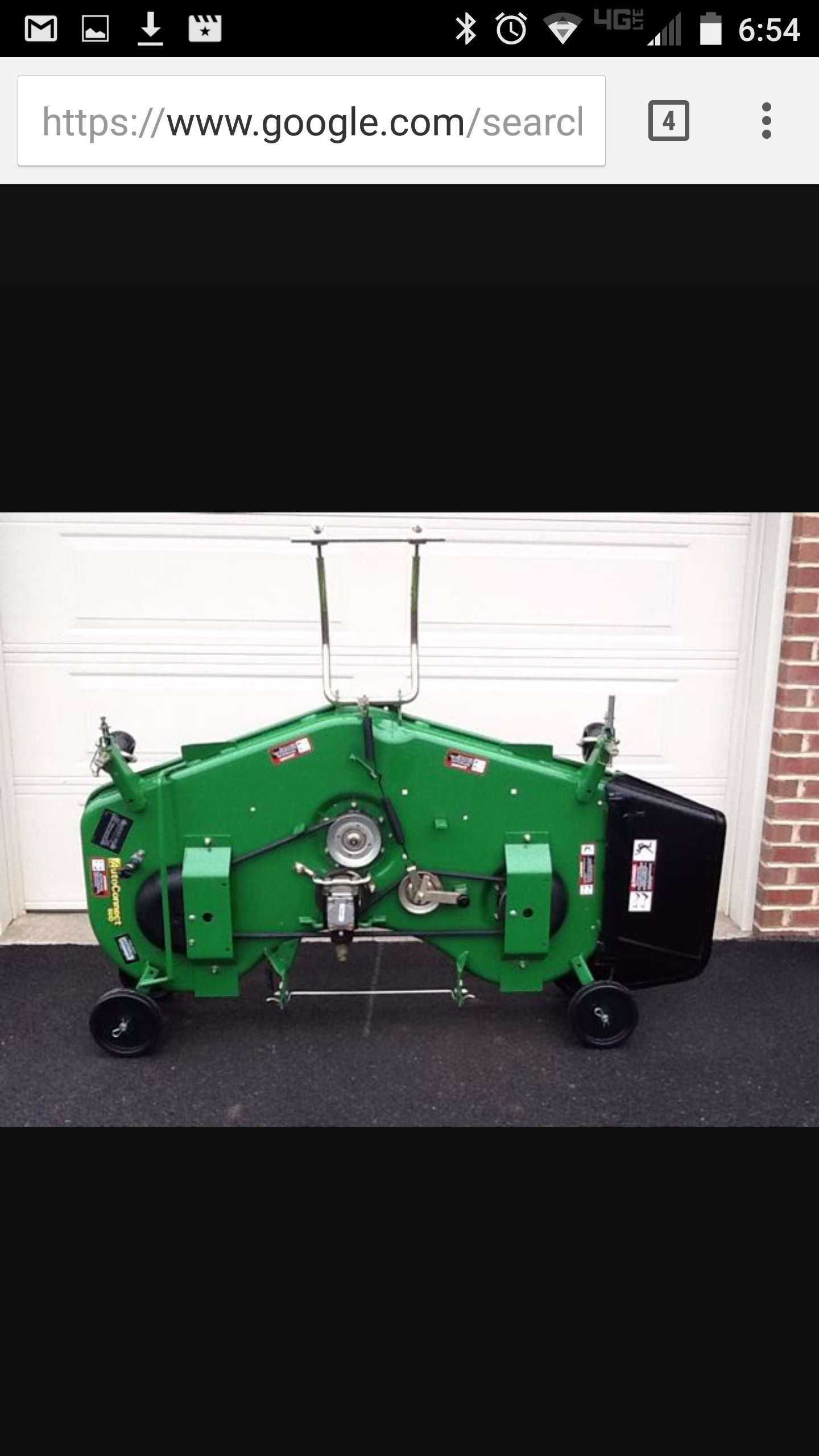

What do you mean by wheels for storage??
Like this?
   / MMM Mid Mount Mower 2325 60" #5

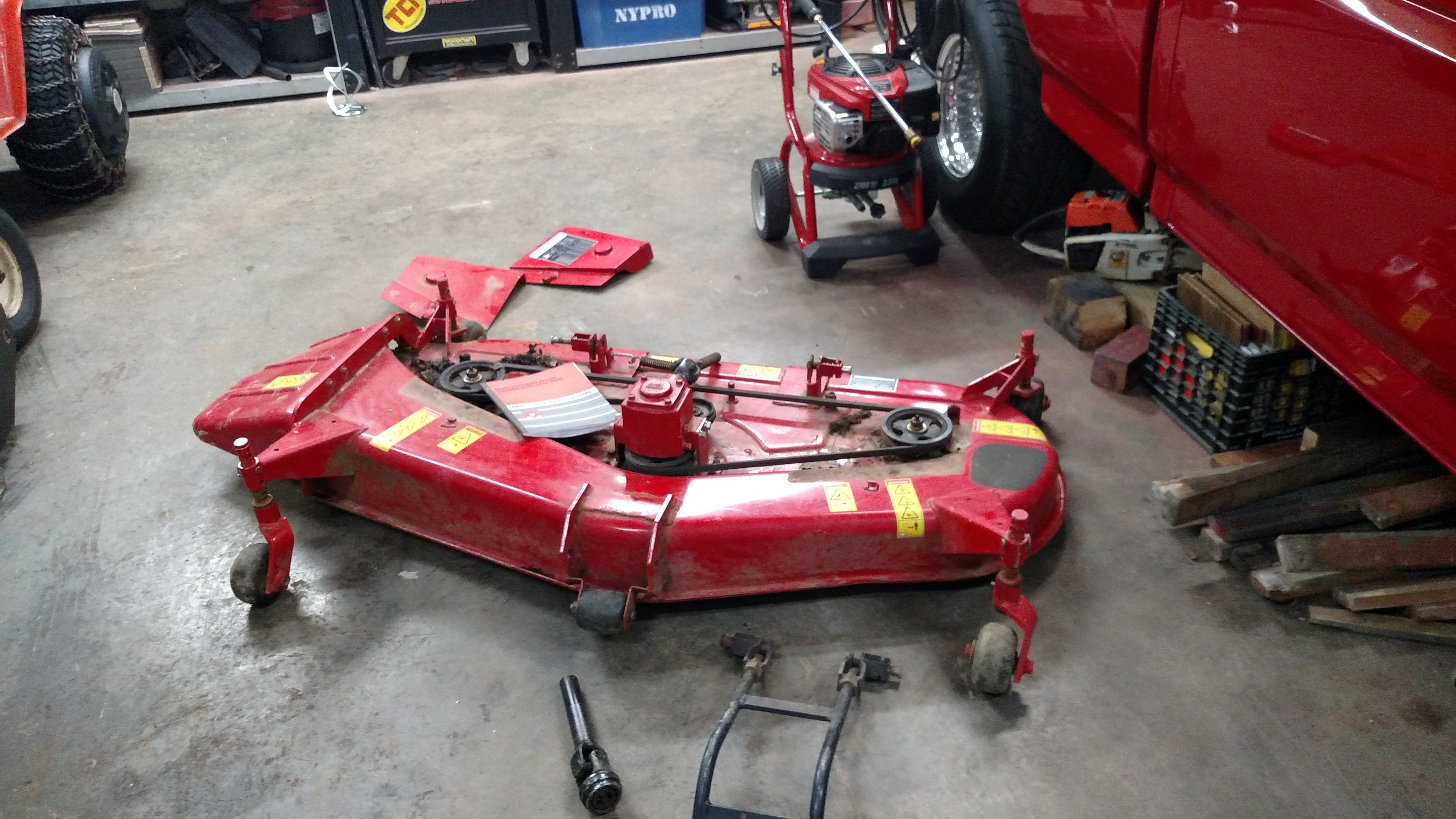

Yes, precisely. The axles/wheels replace the MMM rear non-swivel wheels. The ones I bought were made commercially, but some have made their own. MMM rear wheels removed, slide in the axle, then put the wheels onto the axle. After that, the MMM can be stood up on its rear edge. While in storage, I use a pice of 1" rubber heater hose to slip over the driveshaft to protect it & keep it clean.

Reviving old(er) post here... where did you get the wheel set you use for vertical storage of the deck? This is a fantastic idea I could really see taking off
