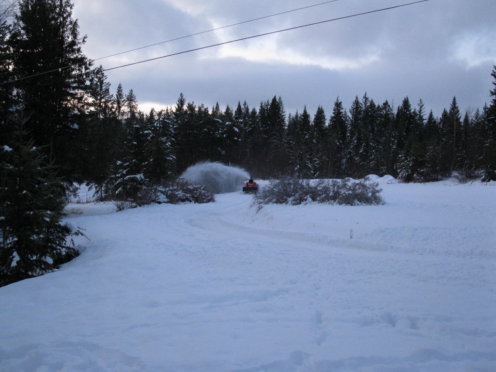

I have a MK Martin 7' blower and I find it does not blow very far (5 of 6 feet), even with dry snow. How many RPMs should I be running at? If anyone has a blower similar, what hole do you put the chute adjustor at? What usually causes a blower to no shoot snow far? Are these supposed to be a good blower?
Thanks
   / MK Martin Snowblower not shooting far?? #2

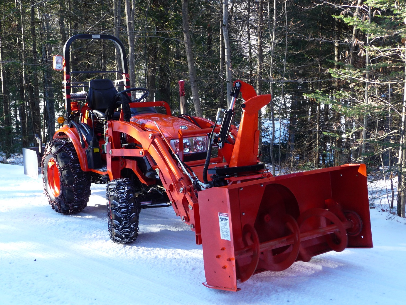

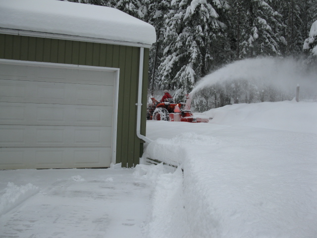

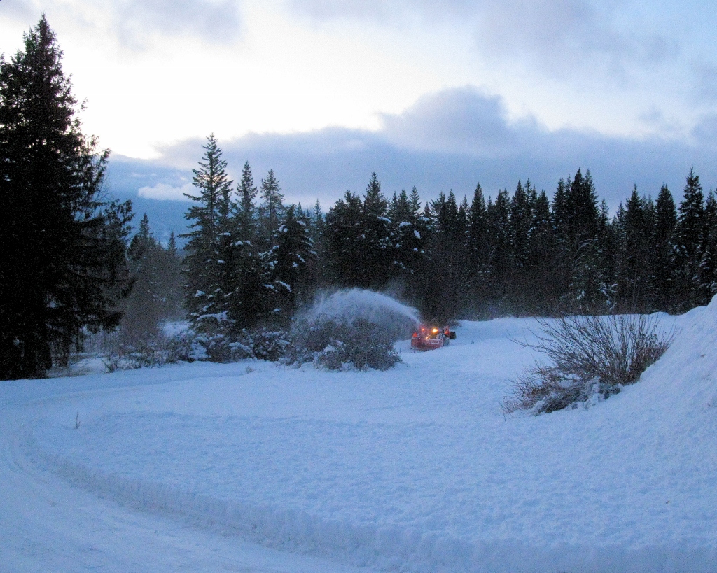

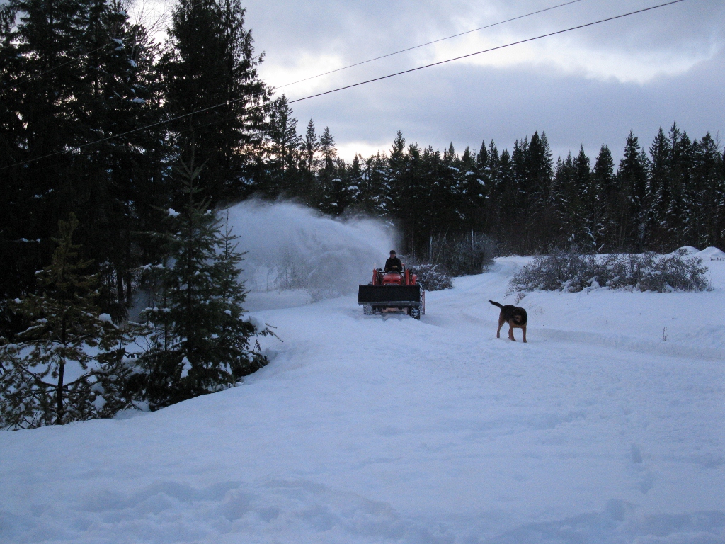

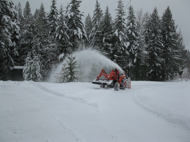

I have an MK Martin 75" pull-type which looks to be the similar to yours, only reversed for pull-type. I normally run it at the rated 540 RPM. It throws the snow a good 30' to 40' in virtually all snow conditions, even very wet, cement-like snow. My tractor is a DK35HST with about 28 PTO hp. I usually have the chute set one hole shorter than the straightest setting.
My 4-blade fan is 23" diam x 8" deep. It looks like your 87" blower fan would have a 27" x 10" deep.
I think it is best to keep the RPM's at rated PTO speed.
Here are some photos of mine in a fairly light, dry snow--but it works as well in wet snow:
EDIT: Here are a couple more from this year in wetter snow:

Keep it up at the rated 540rpm and make sure there is not any rust in the chute and the impeller clearance is no more them 1/4" to 3/8".
On my Meteor snow blower there is a 3/4"-7/8" gap around the impeller. When I get time I plan on bolting on old heavy belting to compensate for the clearance and act as a sacrificial wear piece.

I did same with my old (1986) Allied/Farm King snow blower. In my case I used 1/4" mild steel flat bar and set the clearance to clear the housing surface by about 0.030". It works fine and has inproved my throwing distance considerably. I use both the 540 and 720 speeds I have on my tractor depending on the snow and weather conditions. Either way, the snow gets thrown away from the driveway.
To OP - if your clearances are good then you need to increase the PTO speed accordingly.

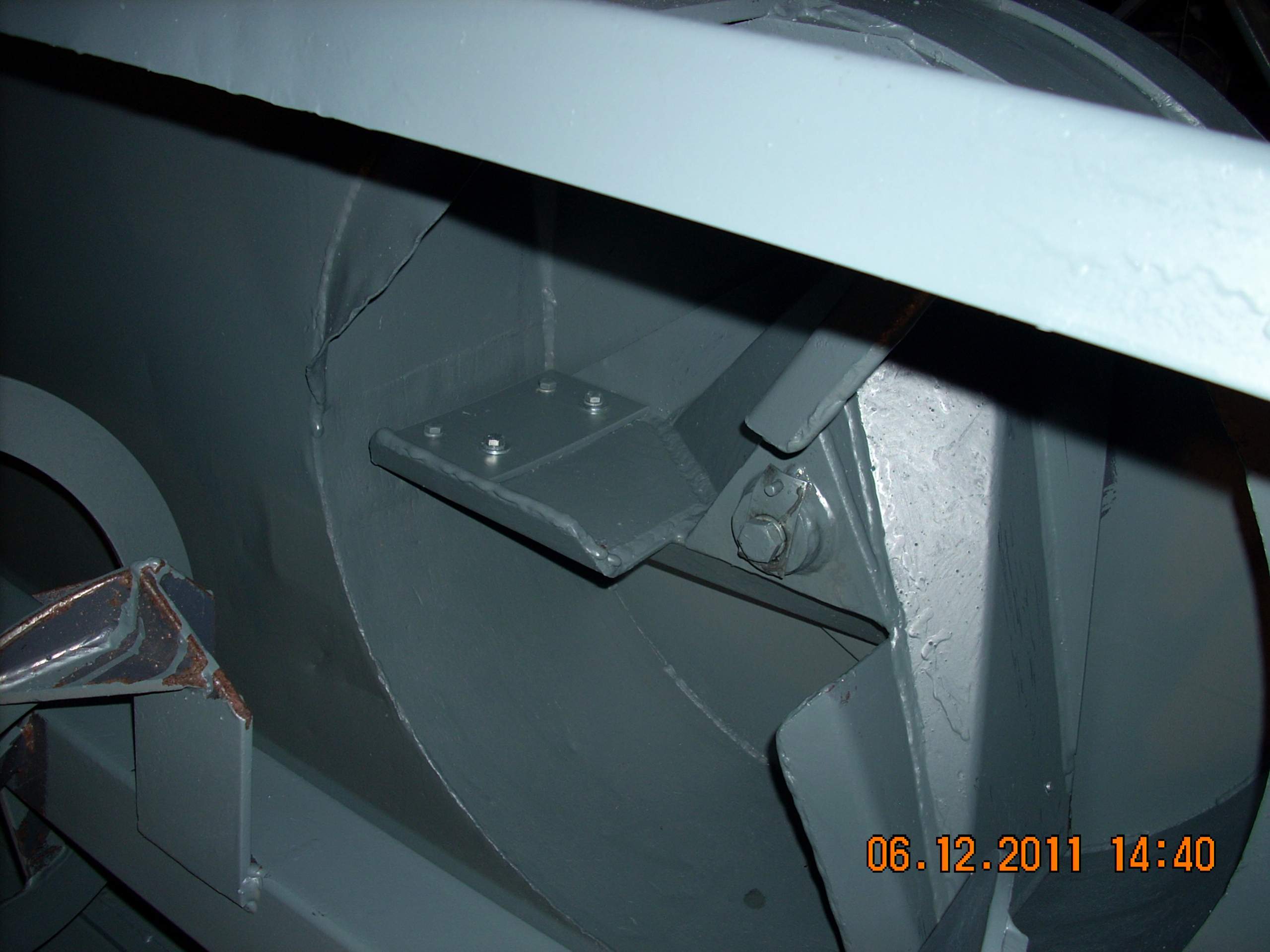

If I remember correctly my dealer did install a larger triangular plate of metal in front of the fan. You can see the shinny new bolt on the pic. It's not bigger by much but it does help. It doesnot throw snow very far indeed but when it's only 10 feet away I can pick it up again and re-blow it again and the tractor doesnt mind it's very powerfull (51 inches). So far it's working flawless. The front chain does also help a lot for steering.
