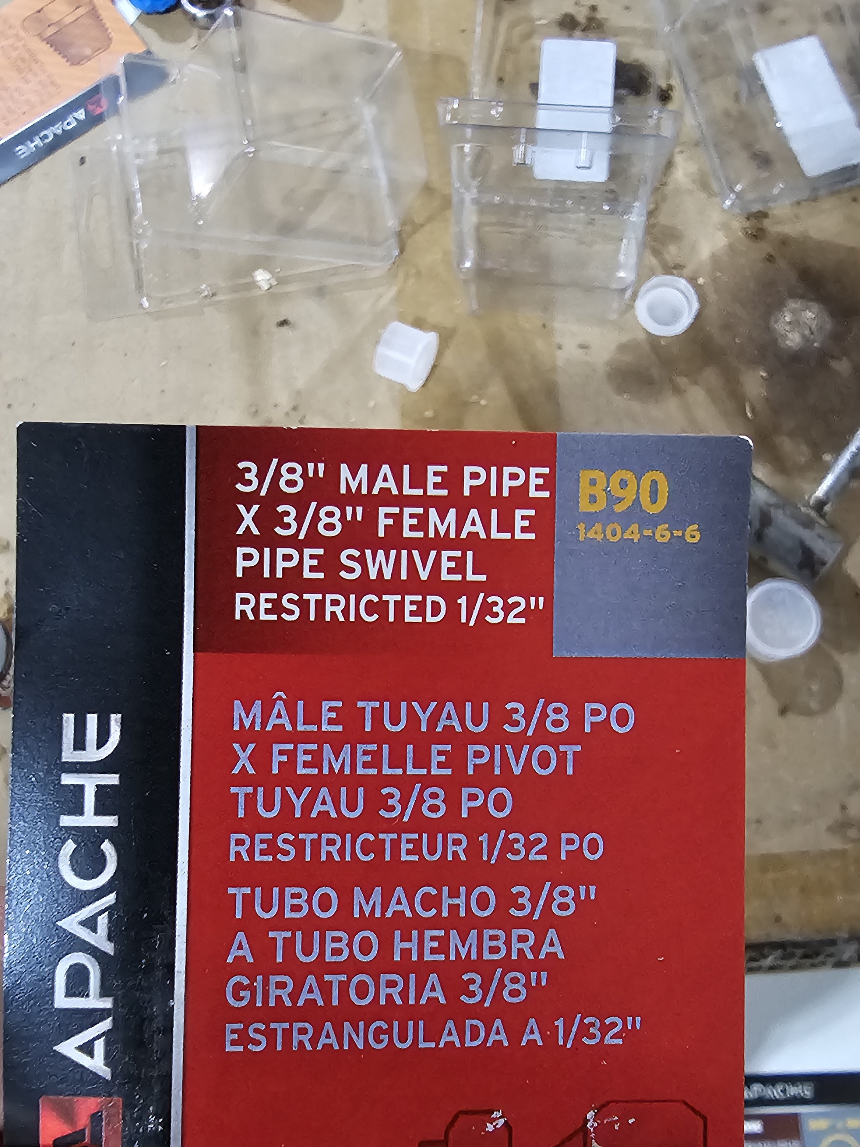

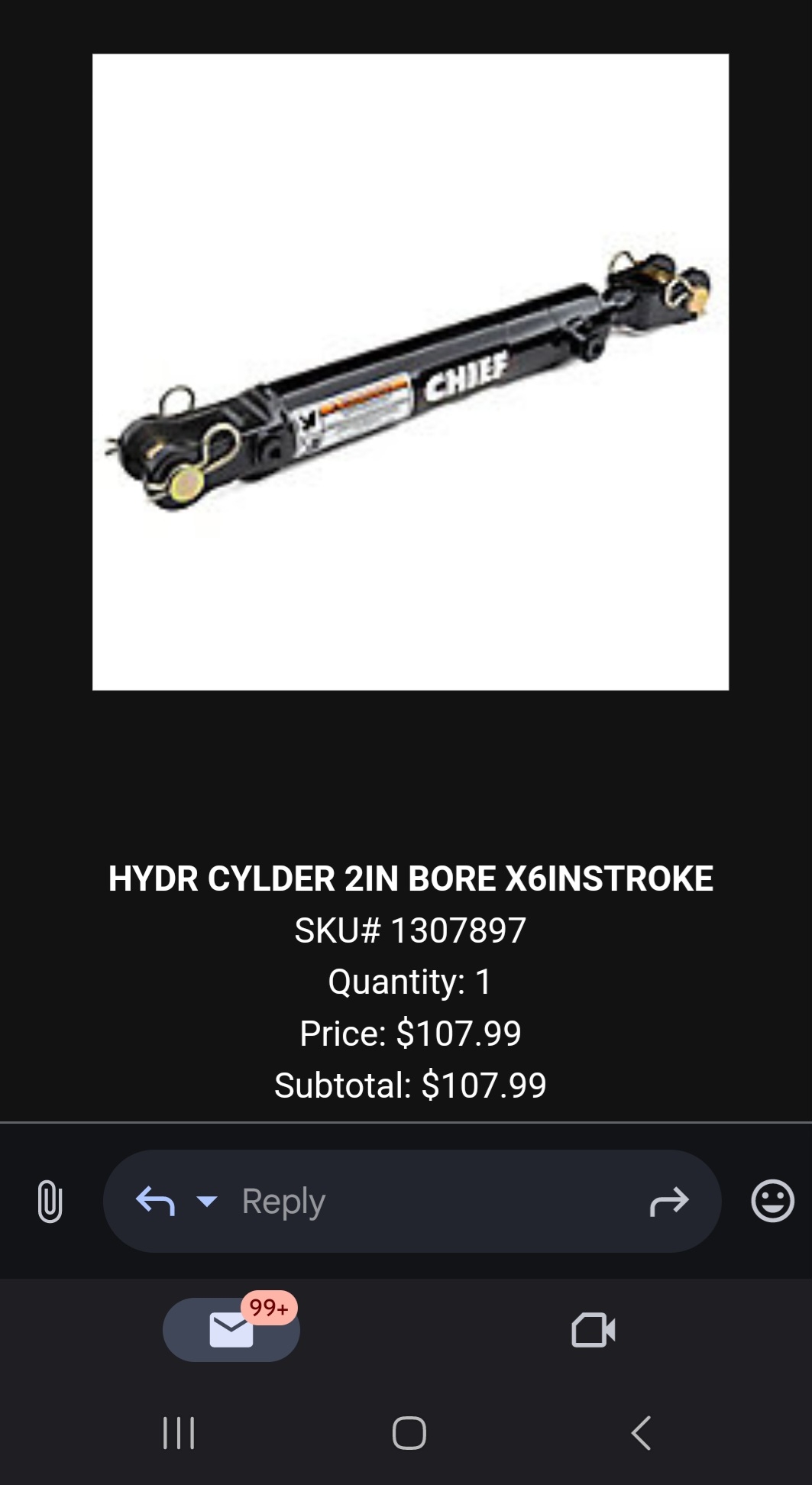

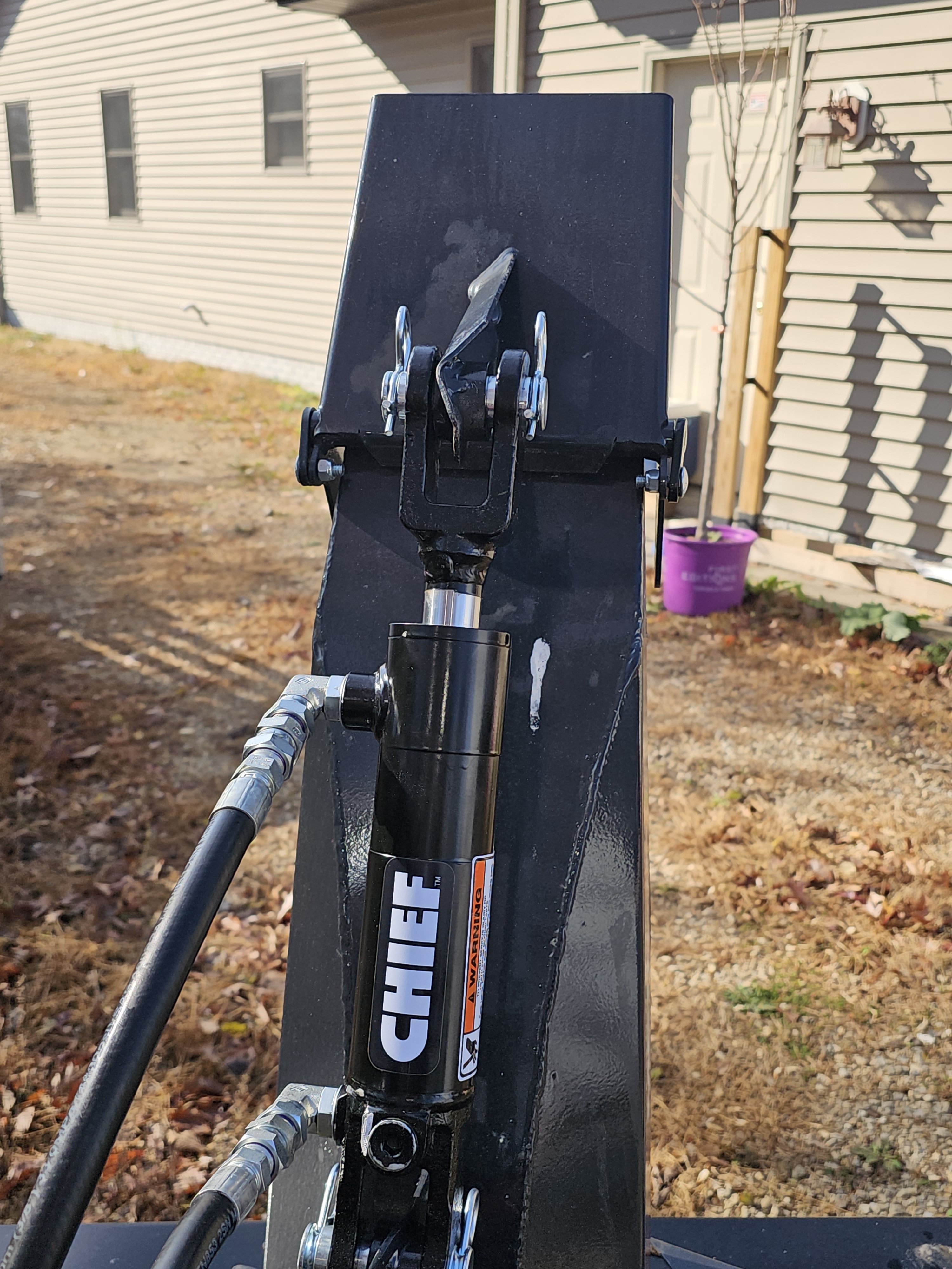

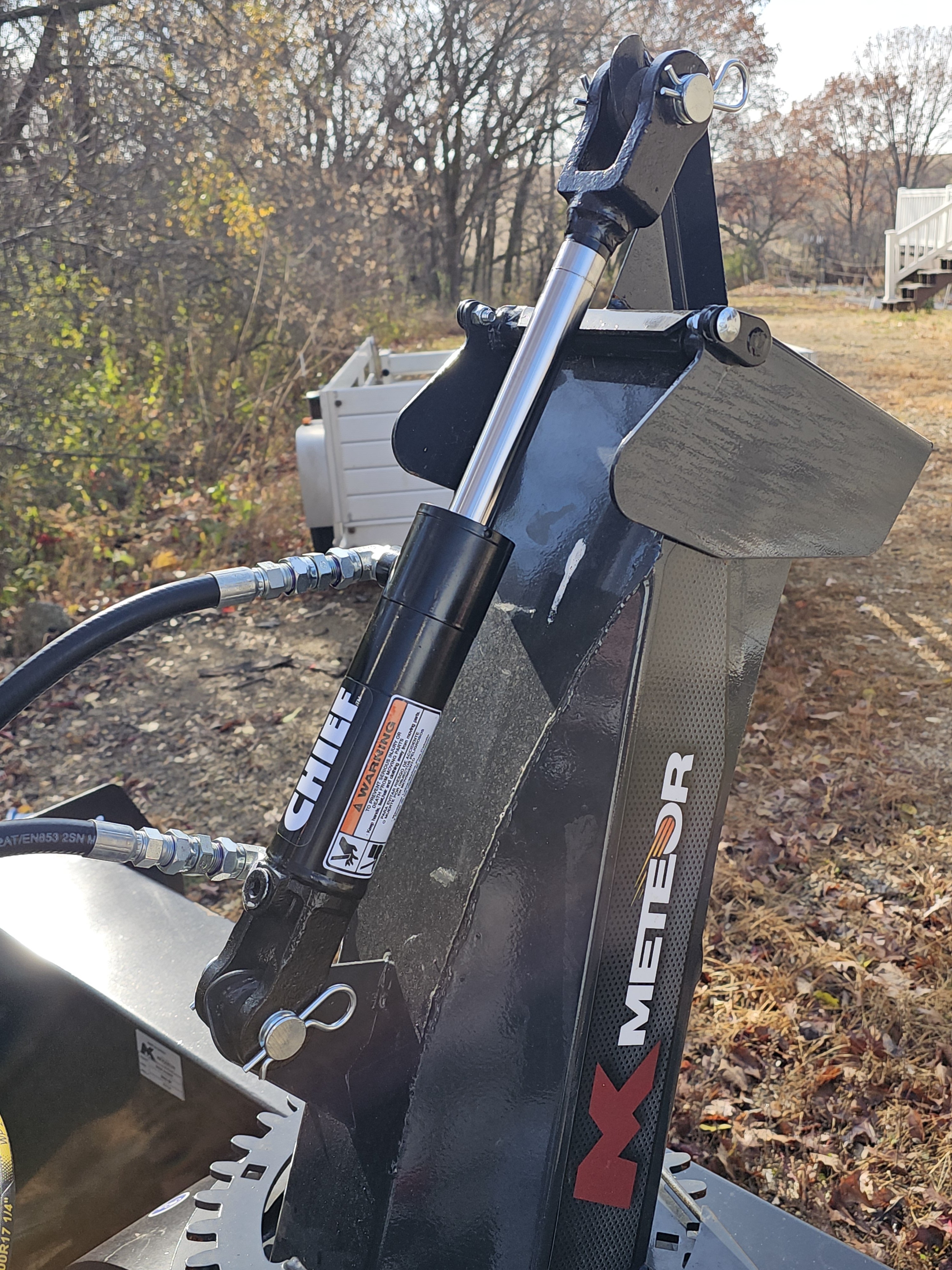

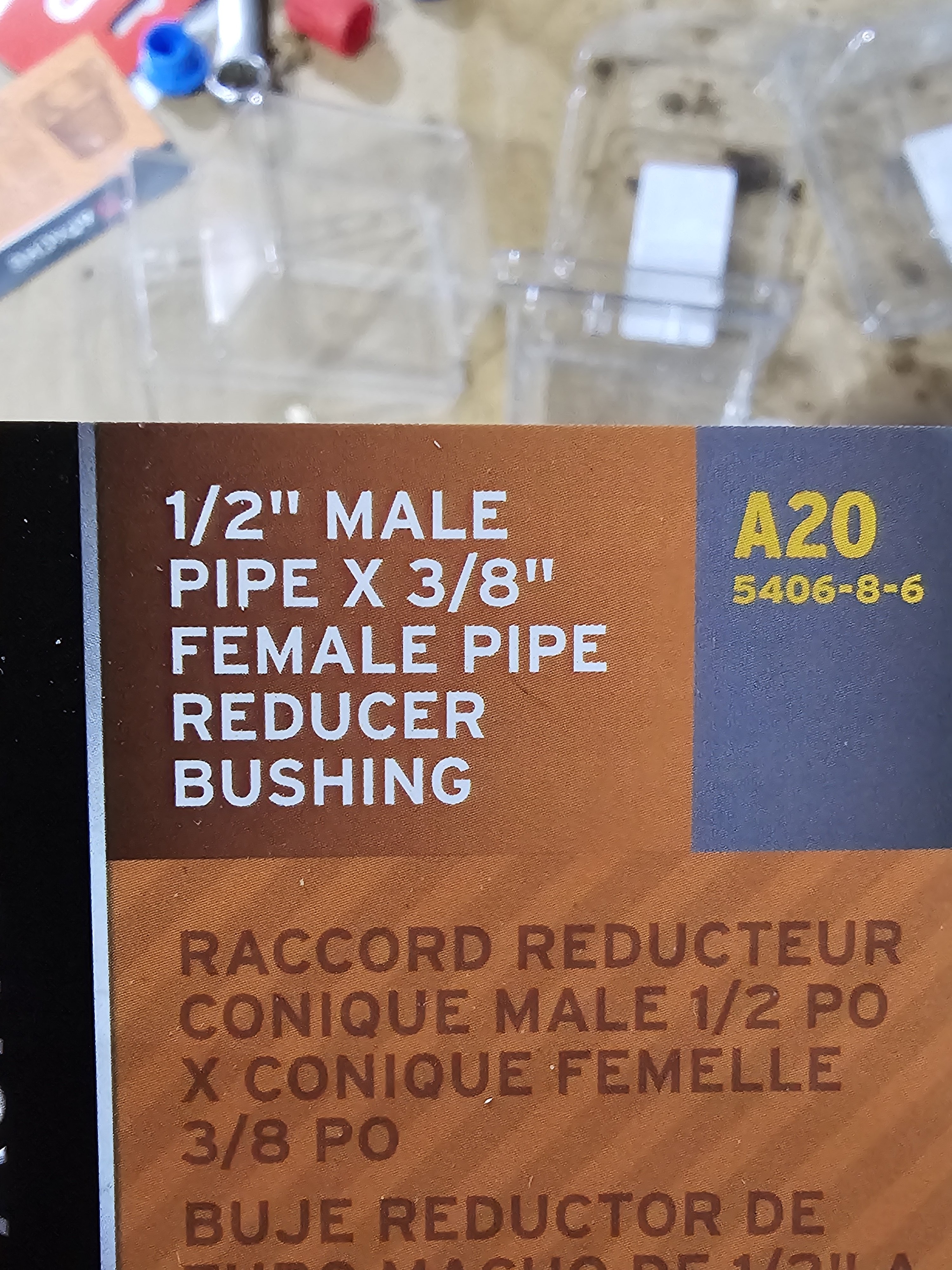

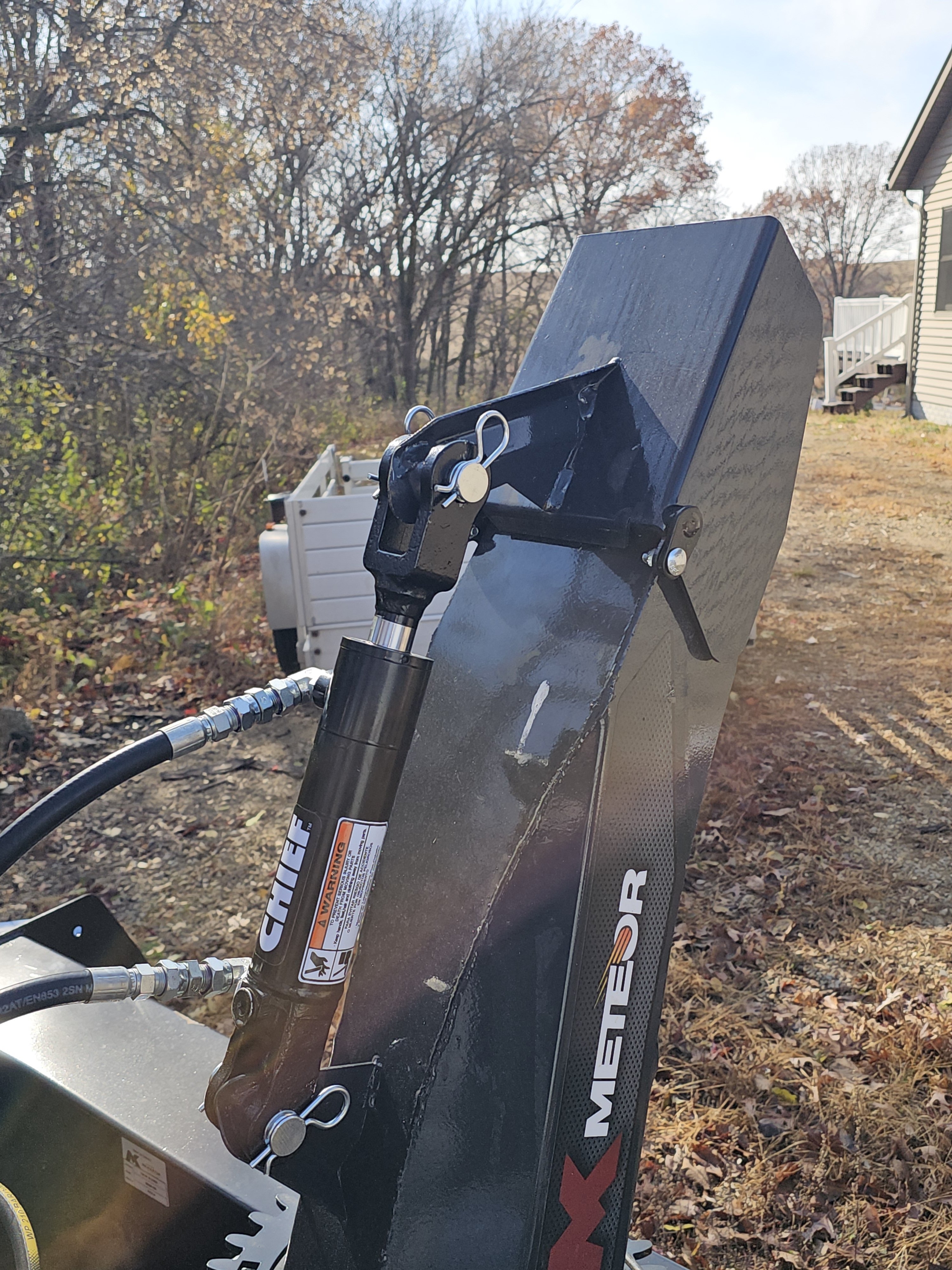

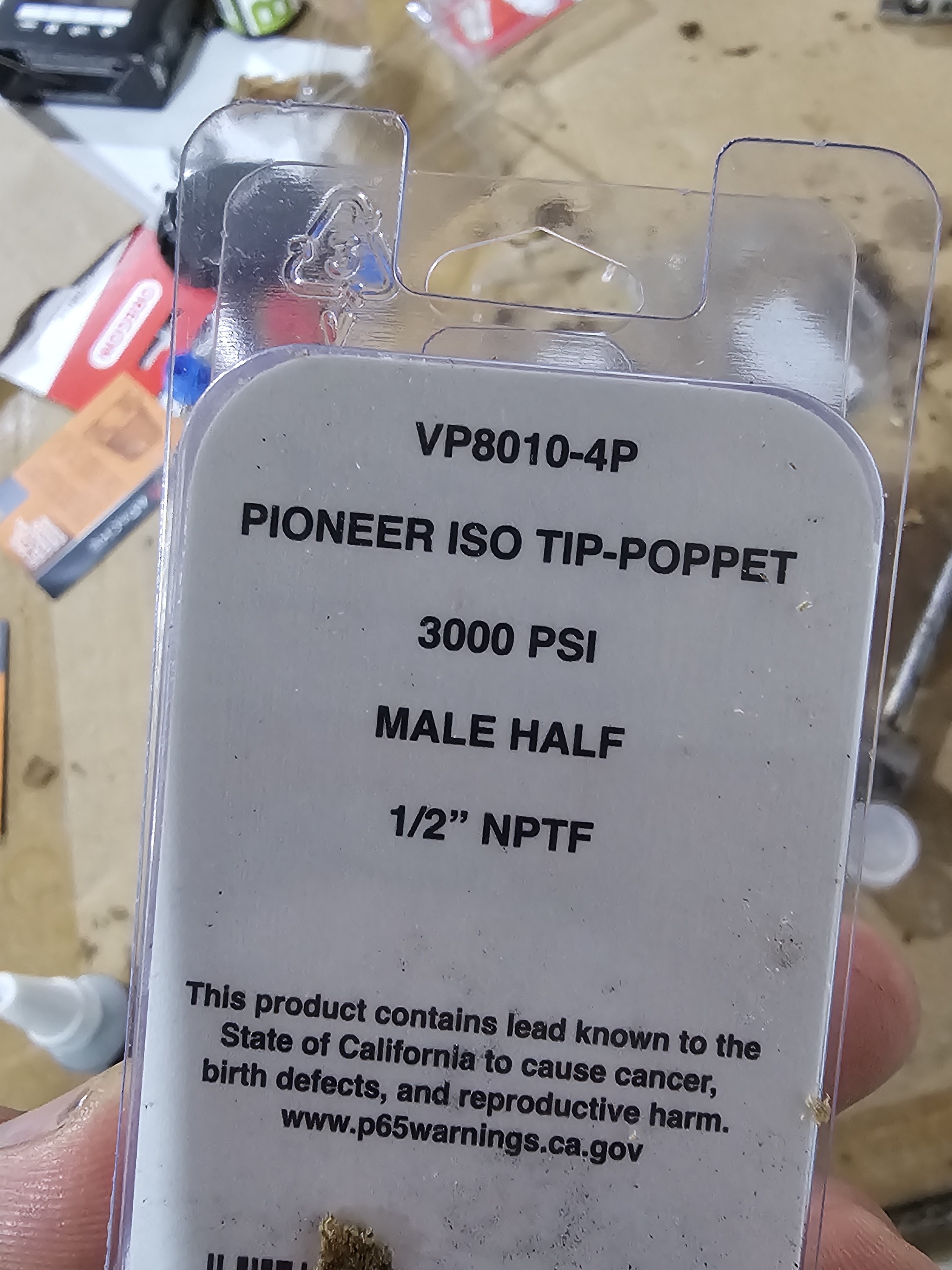

I couldn't bring myself to pay $550 for the hydraulic deflector from the dealer last year when I purchased the blower. After one winter clearing the driveway at our place, that seems to always be windy, I had had enough of that. Bought a 2 inch bore 6 inch stroke hydraulic cylinder from tractor supply. 2 90 degree fittings, 2 half inch to 3/8 reducers, 2 3/8 flow restrictors, 2 8 foot 3/8 hydraulic hoses, and 2 pioneer fittings. I've got a little over $200 into this and will be money well spent once the snow starts flying again.

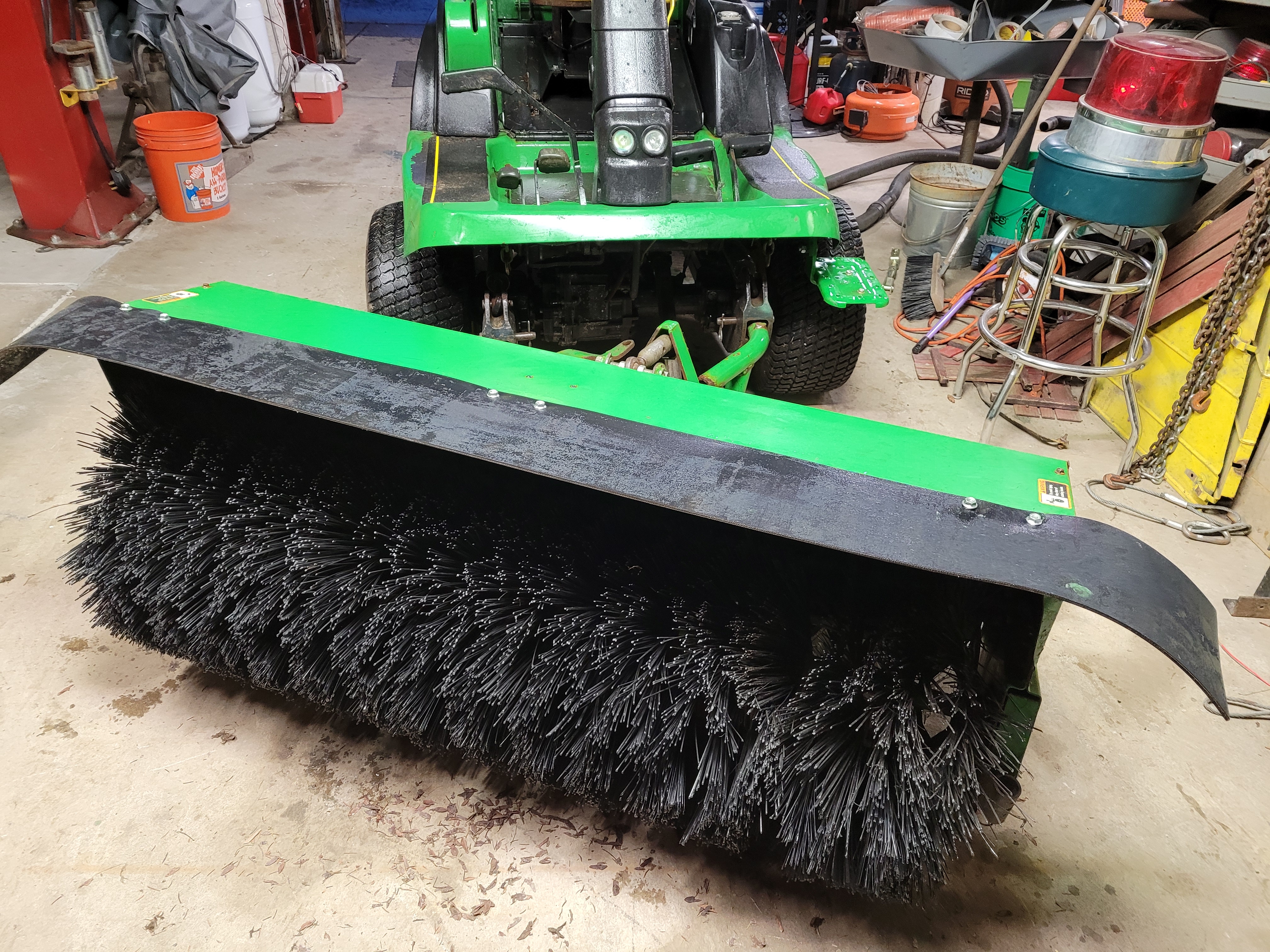

I bought an electric actuator off of ebay for $19. Its 24V but runs the deflector just fine. All I had to do is run a wire. Used with my JD F935 and also my 1435 front mowers. But, snowblower takes way too long. I view it as a complete waste of time. I got a used 60" rotary broom and can wipe snow off my driveway as fast as it will move. Even thru 12" drifts. Plus, no more in your face flyback. Driveway is 800' and the motor is barely warm when I'm done. Plus the driveway is completely wiped clean. No more vehicle tracks or ice patches.

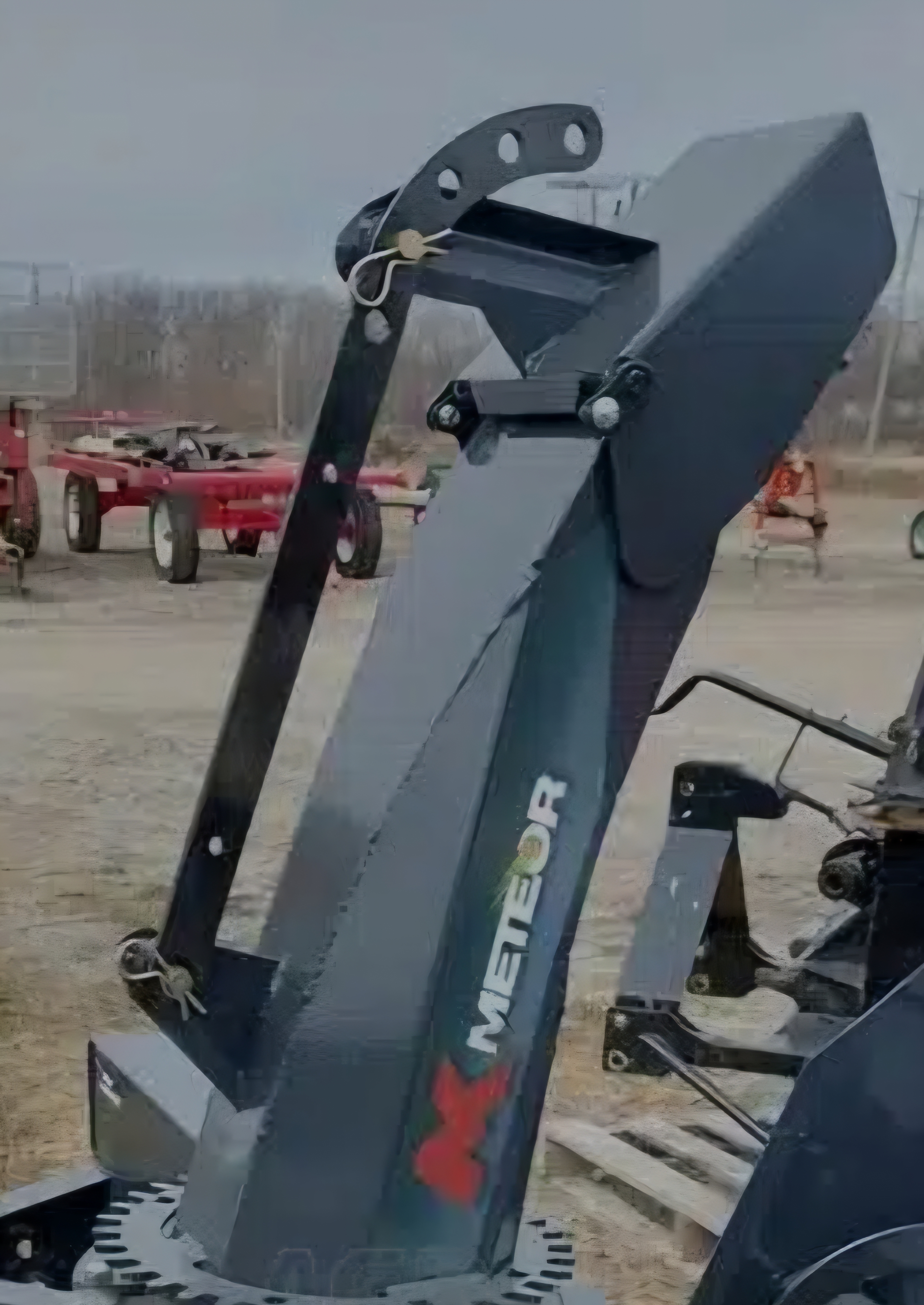

Sweet! Did you fabricate the deflector?
I added rotate and deflect to my blower years ago, and wouldn't be without it.
The deflector is the one that came with it. The pins on the hydraulic cylinder are the same size as what came on the blower.

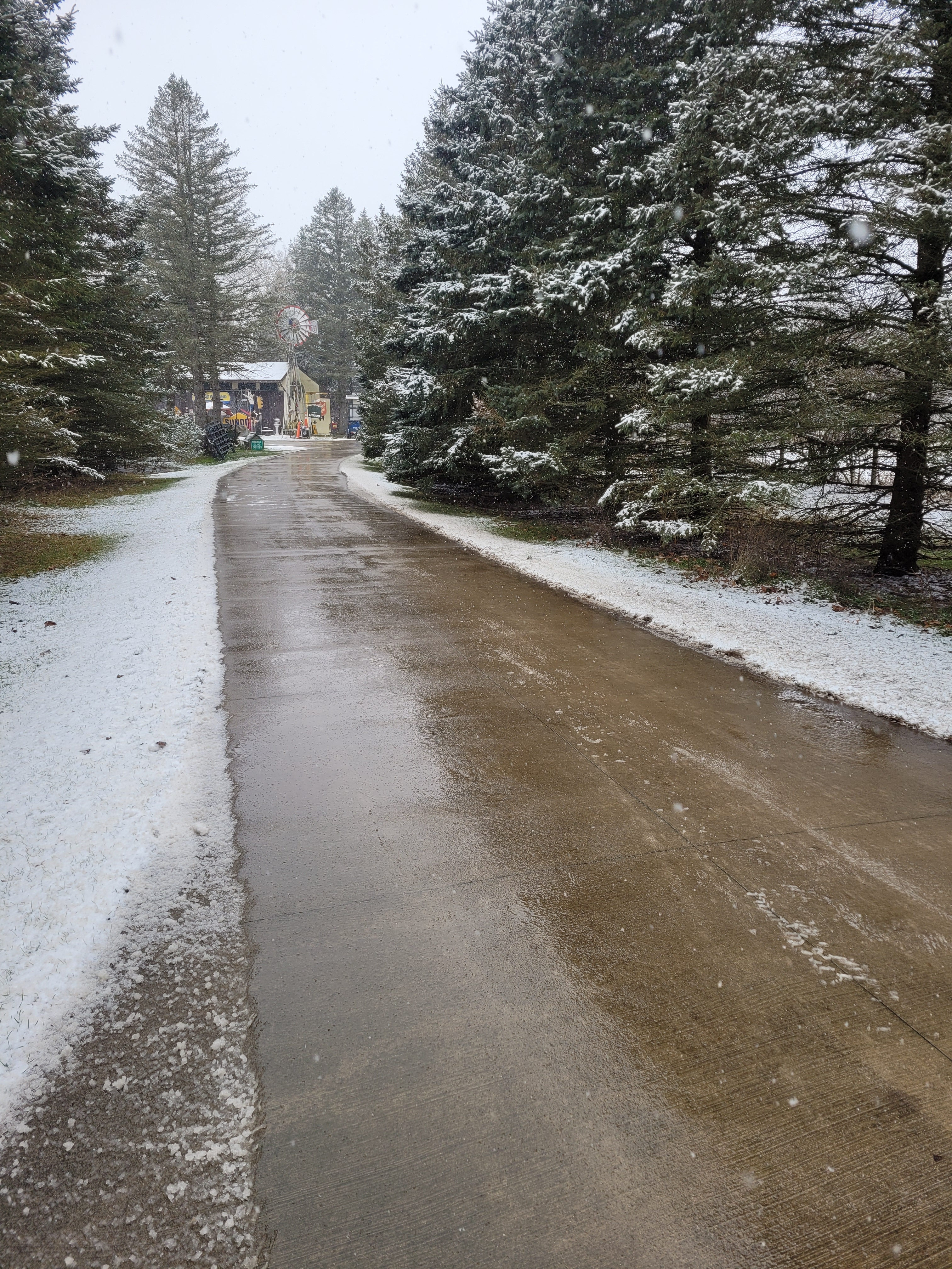

I have spruce trees along the driveway, too. The broom can toss it 30' off the pavement without harming the trees because it sweeps it sideways, not elevating it like a blower does. And it doesn't create a berm like a plow does. Distance depends on rpm you choose to run the pto at. Not related to ground speed. This was about 3/4" of ice from a sleet storm. ALL gone. My plow & my blower would not have cleared it.
I did the same thing, the MK Martin deflector is built the same manual or hydraulic. I used a regular 8" implement cylinder.

What do you have powering that broom?
