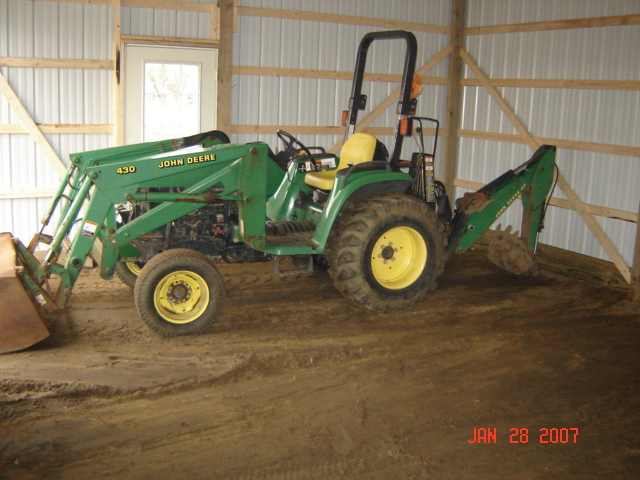

Mine was like this when I got it 2 years ago.

Hard Surfaces and in 4WD. As long as you don't miss by a whole lot, you should be fine. You actually end up with mis-matched OD's just due to normal tire wear. If these machines can't handle that, then we all spent a whole lotta money for no good reason.
