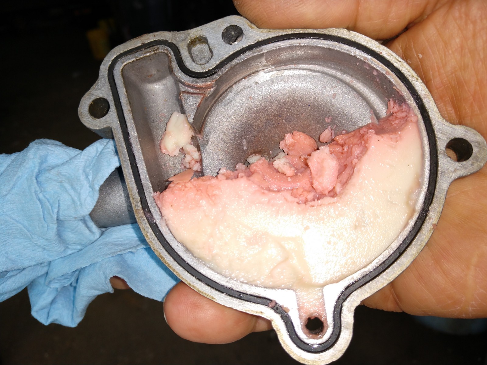

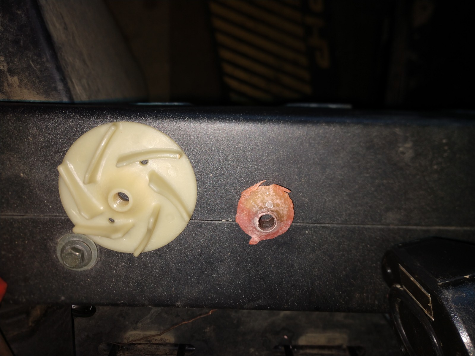

first the old water pump impeller, second the water pump housing, third the old and new impellers.

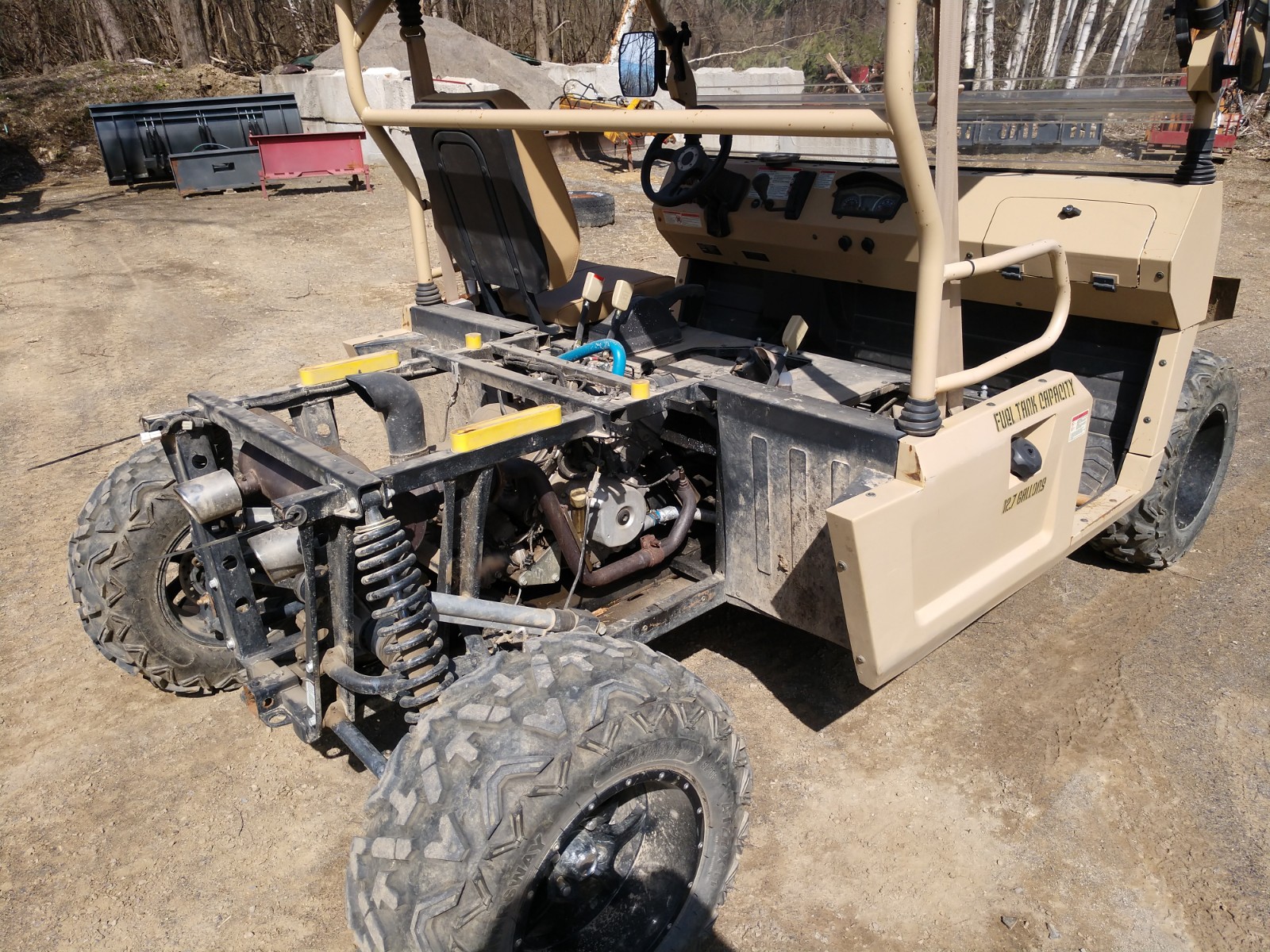

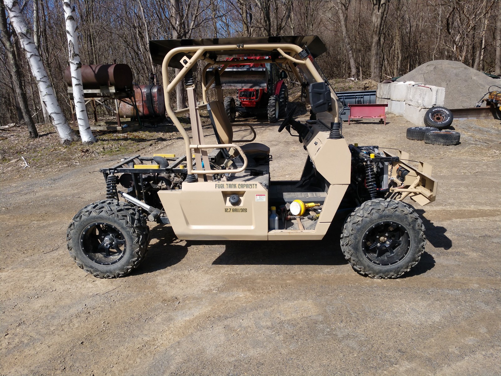

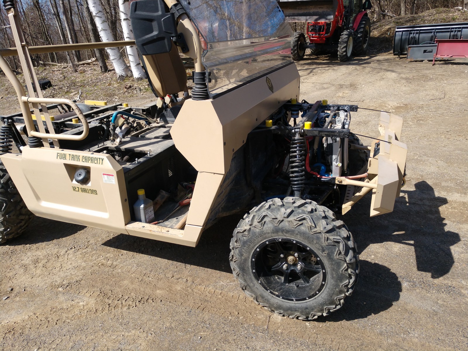

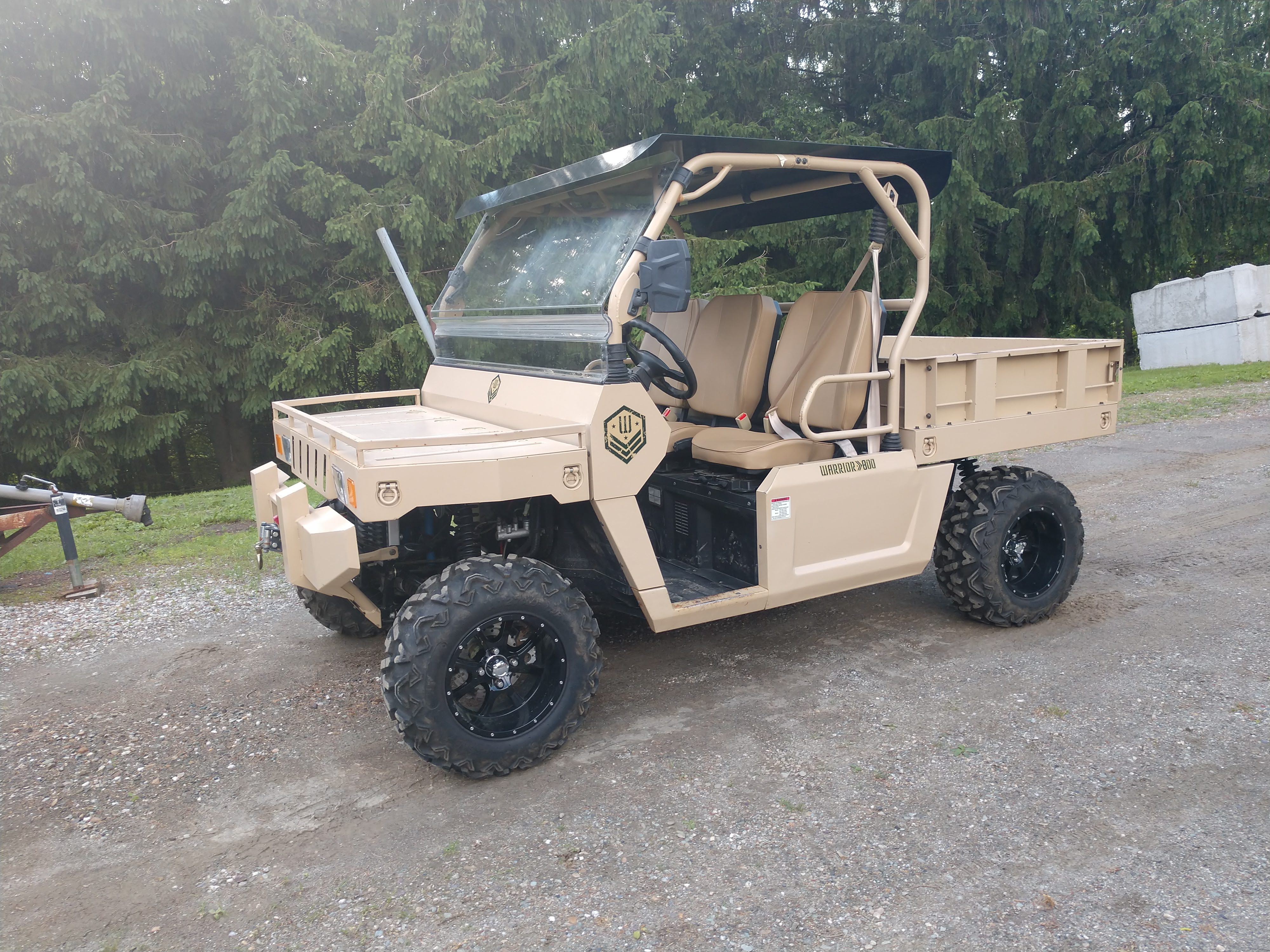

first picture stripped down to be worked on, second front, third rear, fourth ready to use.

Pulled the water pump and said what is this crap, scrapped out the pump got a new impeller and some high dollar radiator flush, flushed and back washed the engine, lines and radiator a few times. Finished getting her back together today and she seems alright we shall see.
