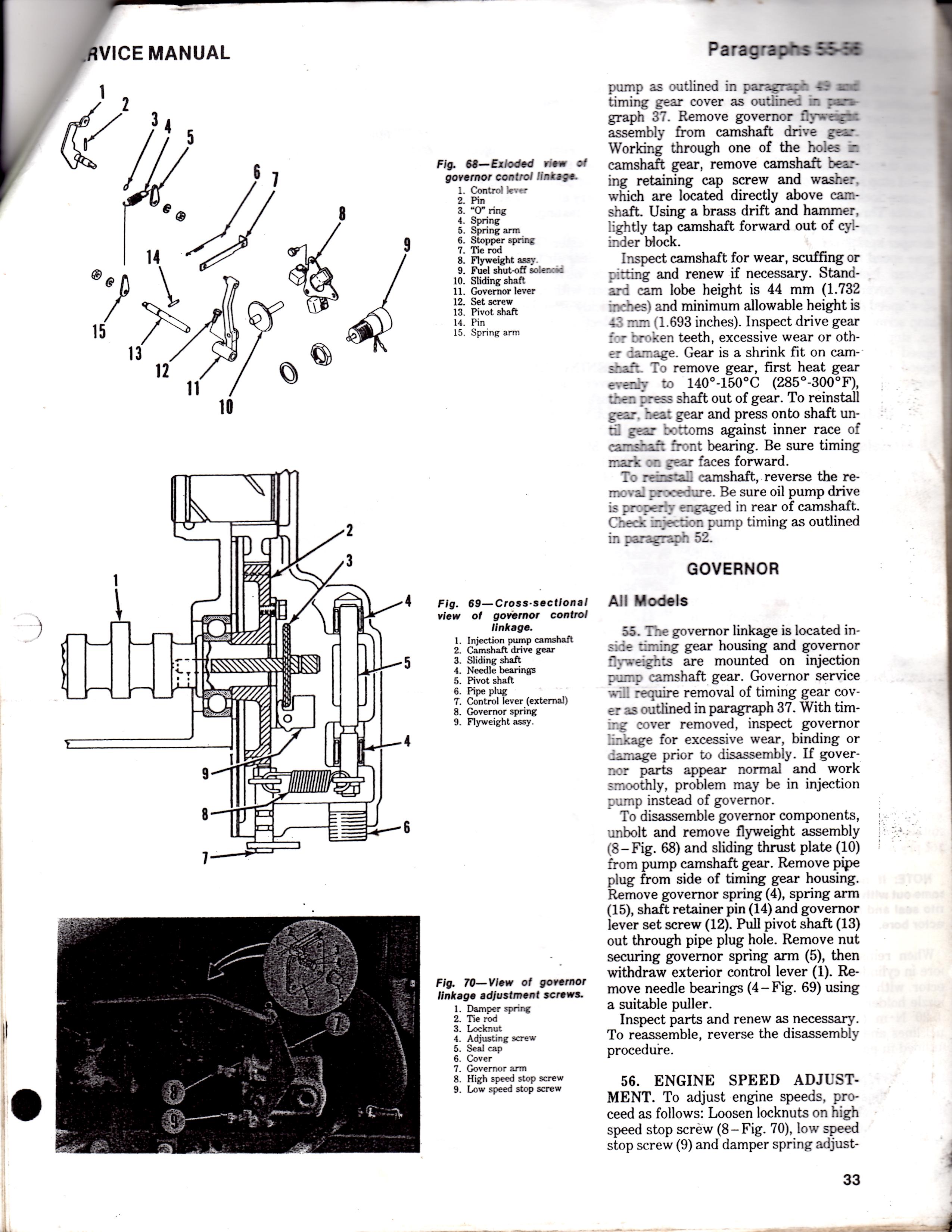

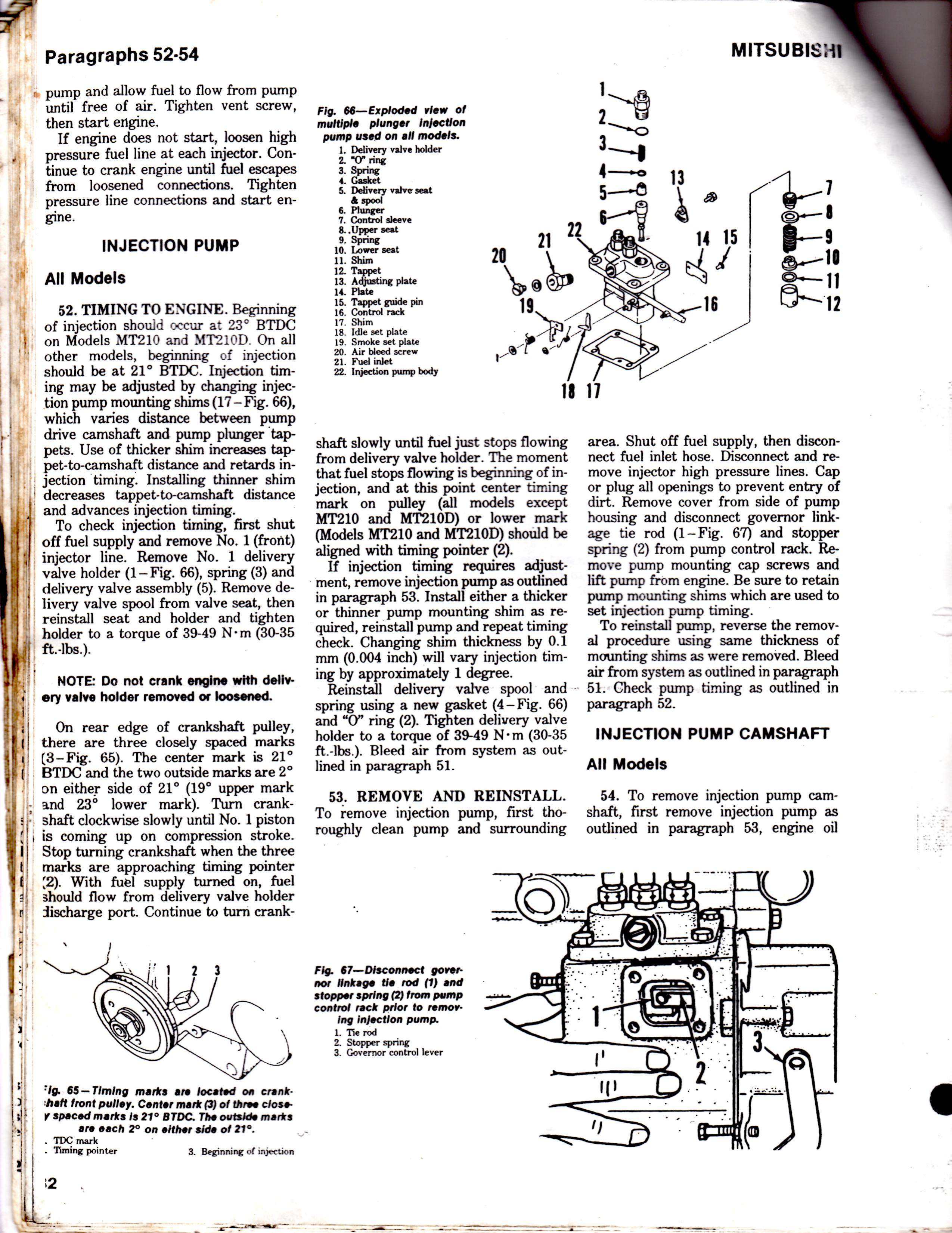

Have a Mitsubishi mt2801d tractor, pulled the inj pump off to replace the seals. some how I did not set the time marks right. cant find a manual or anything online to give me a hint of witch marks to use.
thanks
roach
   / mitsubishi mt2801 timing marks #2
I scanned the injector pump section from my I&T service manual, hope it will help.
