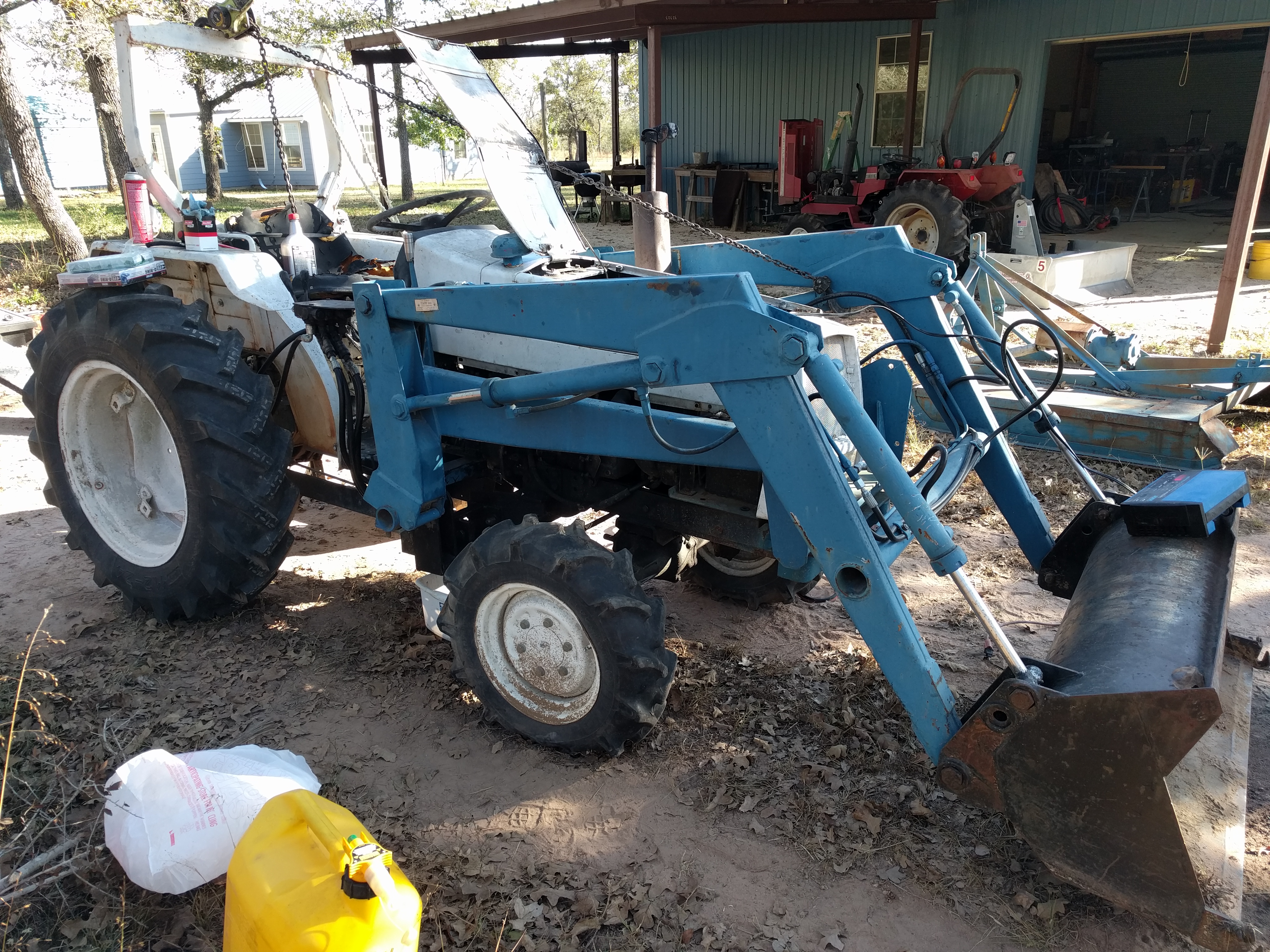

I just bought a little Mitsubishi MT250D, with a FEL on craigslist. This thing is in poor conditions, didn't start and was left out in the weather for a while, I can tell.
Previous owner wanted to rebuild it, but he felt overwhelmed on the labor it'll take to put it back on the field.
I bought it, because I already own a little international 254, and wanted a loader for it. Since the MT250D and the international 254 are very similar (both built by mitsubishi, and sharing a lot of parts) the loader was a direct fit to my international, and considering the very low price, I couldn't let that go.

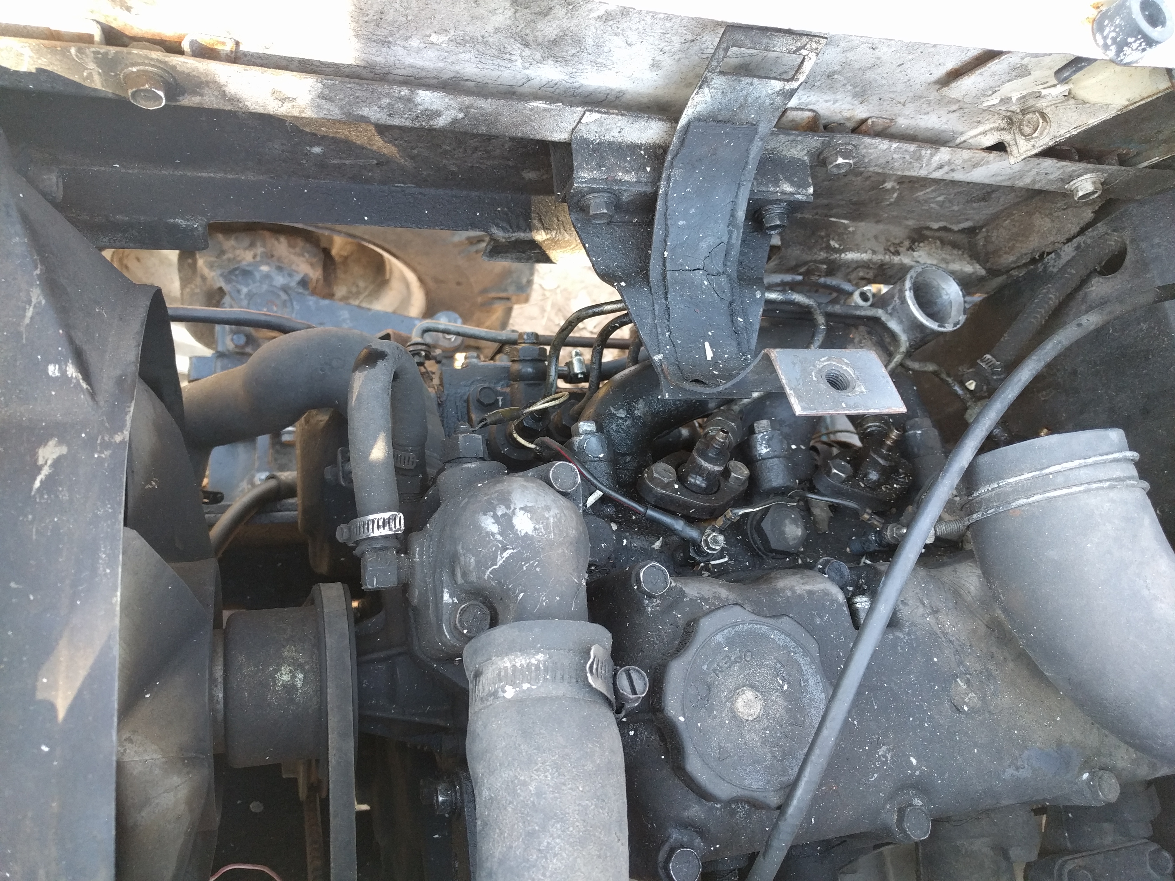

Oh well, now I have the little mitsubishi in my shop, and you know, I kinda fell in love with it... So instead of robbing parts from it, I started investigating on the engine issue. It is a Mitsu K3H block, (the international has a mitsu K3E)
My daughters even gave it a name : R2D2 (it's white and blue see pictures !), the international goes by the name of Wall-E
The tractor is almost complete. I'm missing the transmission shaft for the front axle (they probably took it off when they installed the loader), and the bars and links for the rear attachements (no big deal). Brand new tires, which is a good sign : Who would put new tires on a non working tractor ? So I figured it has not been down for too long, or it failed all of a sudden, not gradually.

Lot of Blow by, pressure in the radiator, and water in engine oil. My hope was that it was the headgasket.
This is also when I realized that the clutch is stuck, and the pedal has no effect on anything (very soft travel, you can push it with your pinkie !) So i think the release bearing must be gone.

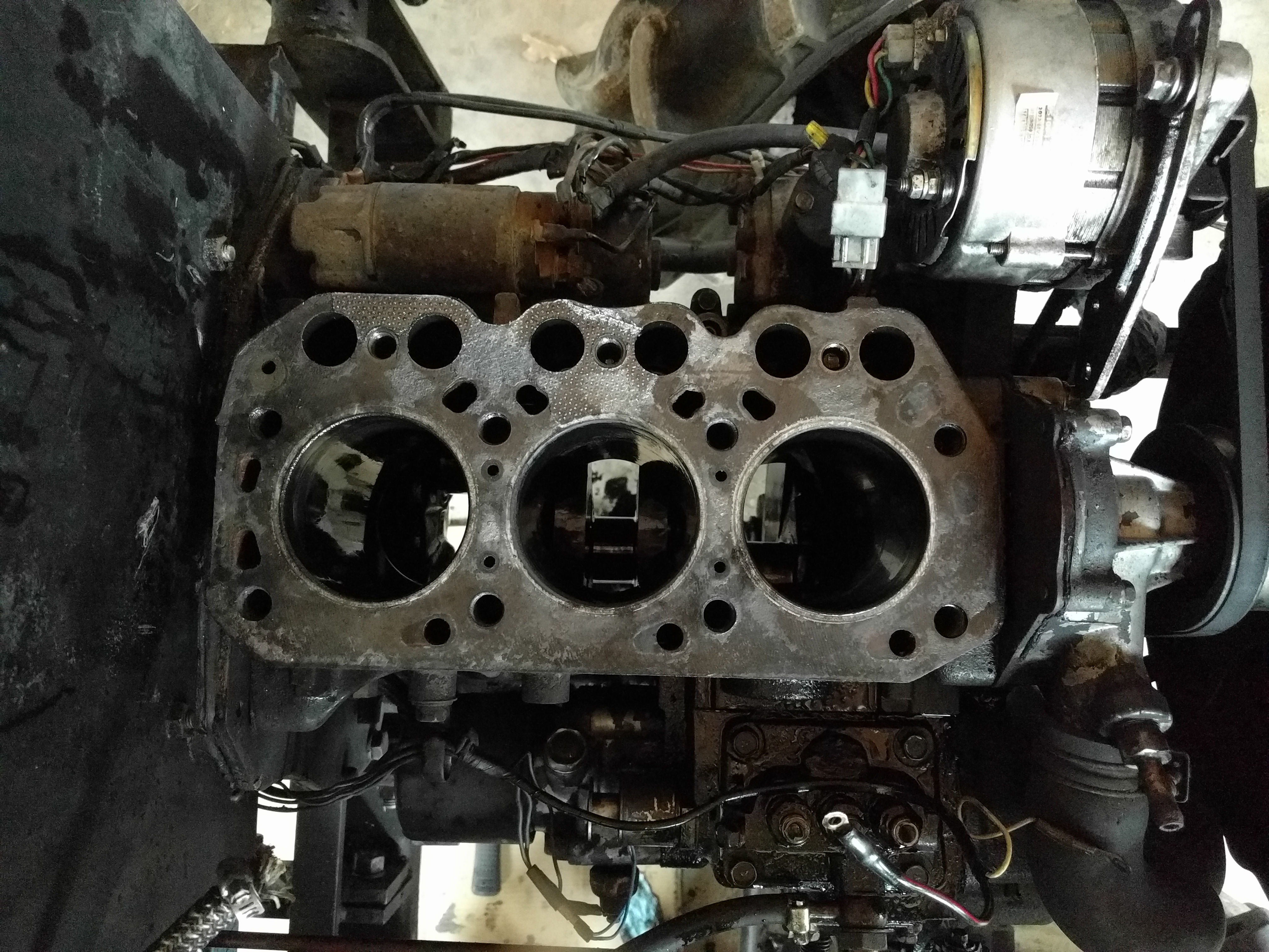

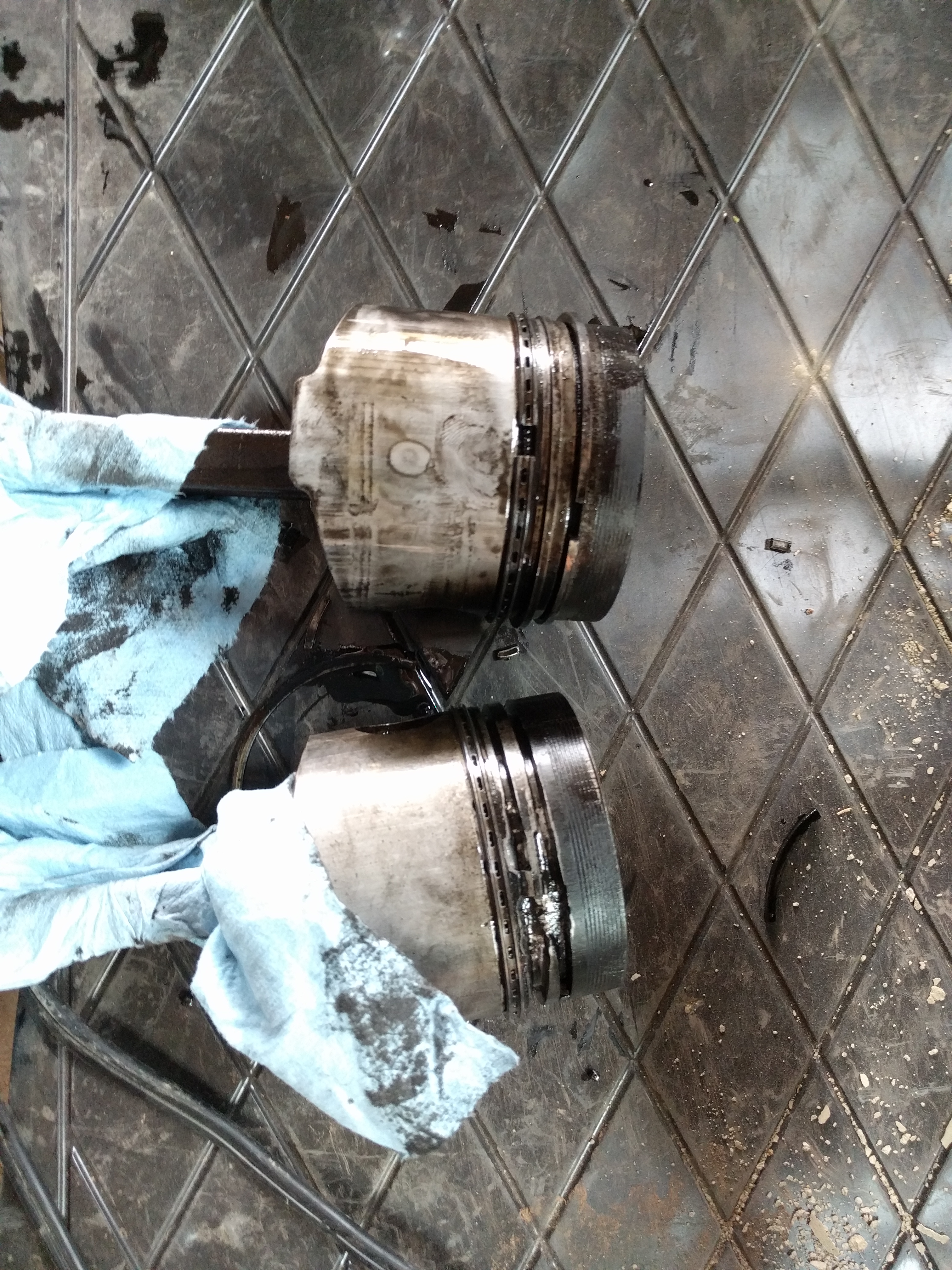

Next week end, I then opened the head, to realize the gasket was in great shape, no cracks. All bolts were tight as well. On to the pistons (with the precious assistance of my 7 years old daughter for the support and wrench handling!), and yes, cylinder number one lost its rings, and the piston looks quite bad, but the cylinder had very little damage.
I'm gonna go to a piston rebuild (can't find pistons for K3H anywhere), the piston is mainly damaged around the tracks for the rings, but other than that is not in bad shape. So I can rebuild it.
Honing the cylinders, put a new set of rings on all 3 pistons, and a new headgsket should give this engine a new life. That will be for the next week end, and the thanksgiving week.

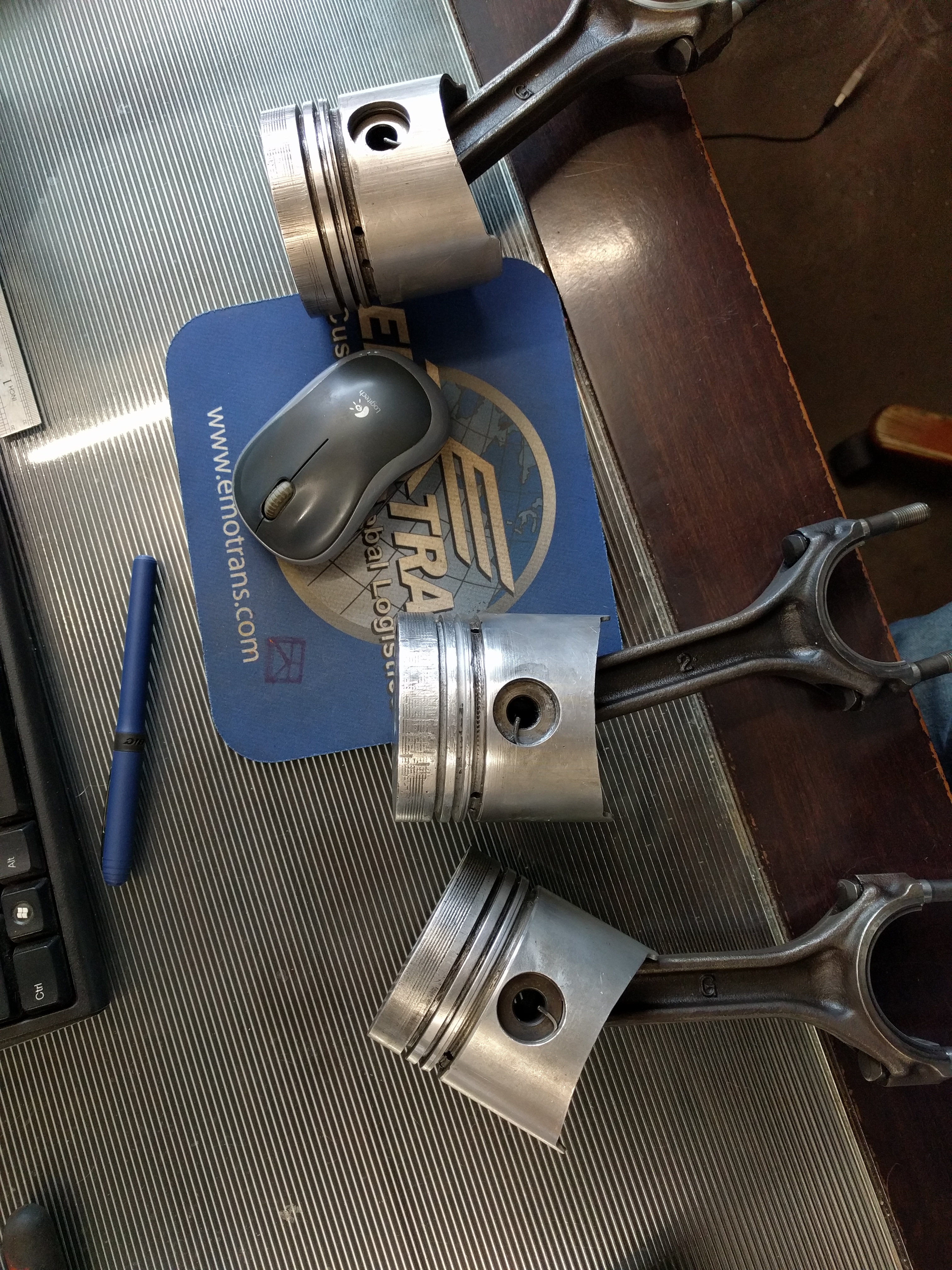

Just got the piston rebuilt by a welding shop, they did a great job salvaging those pistons.
they saw better days, but at least, they'll hold their rings now, and I'm sure my compressions are going to be better than what I found originally !!
Waiting on the new rings and main bearings from weaver tractor, those guys are great to work with, they called me because they caught that I didn't order the right main bearings for the model rings I did order !! So they called to confirm everything was for the same tractor, which i think is awesome ! got my order corrected right away, and I'm getting my parts hopefully before the week end, so I can put it back together.
