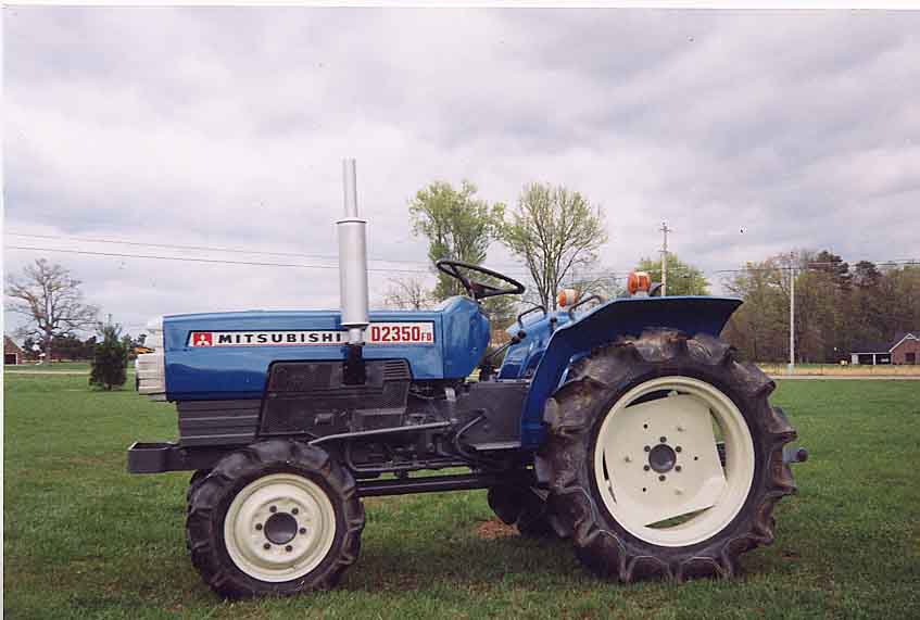

At one time I had a D2350 but I don't remember the filter for it. In my notes I have NAPA 1334 for a D200II.
I just reread your post and realize I missread it. Yours is a 3250, not a 2350.
