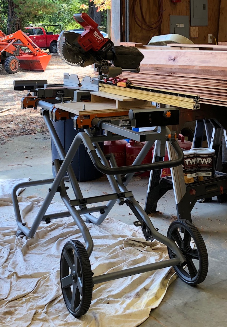

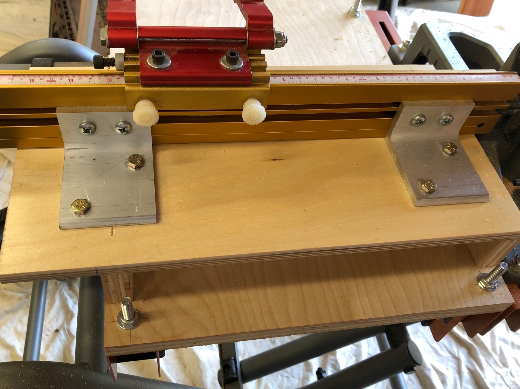

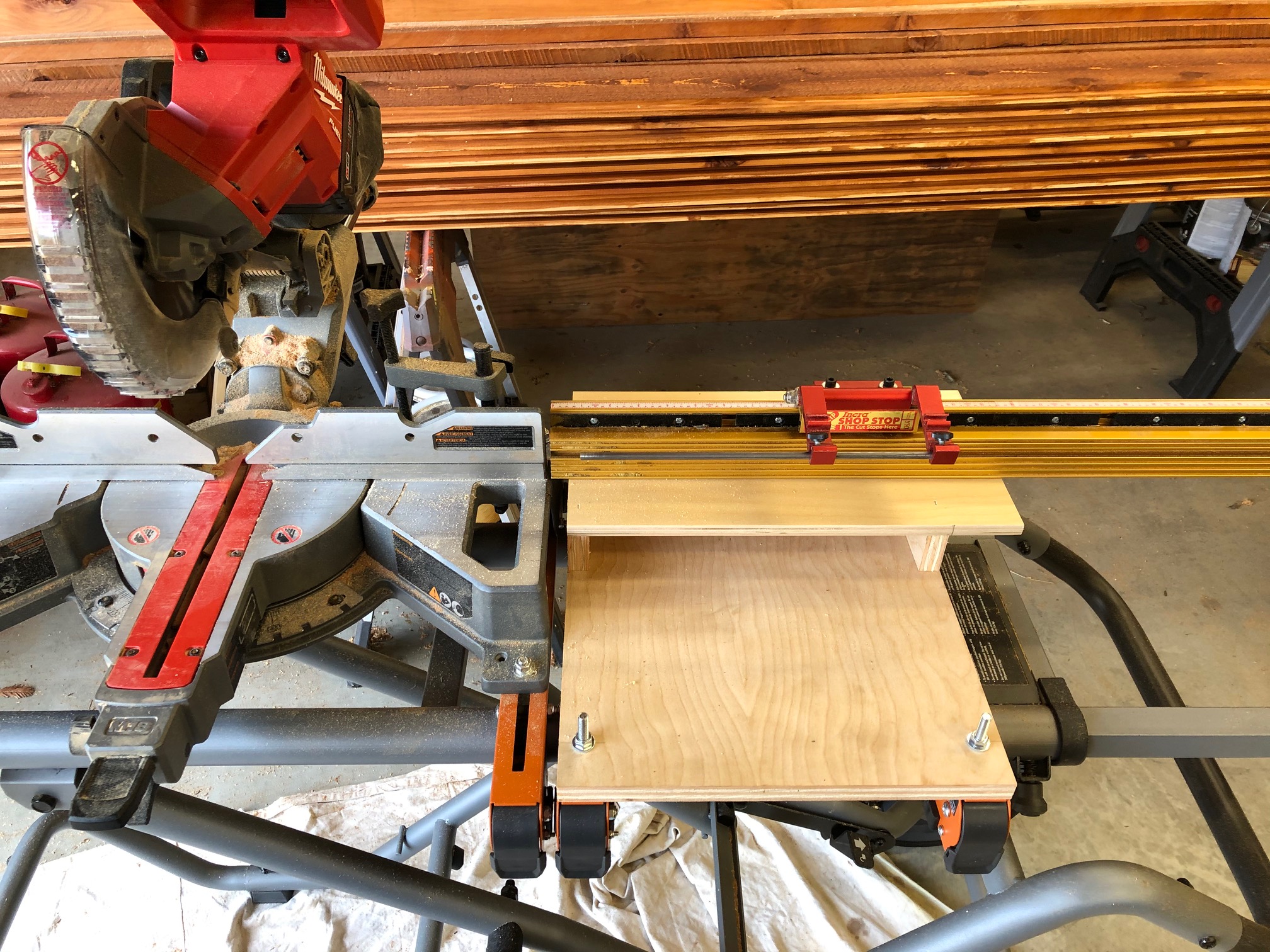

I am putting new siding on all the buildings, there are many repeat cuts. To save time I adapted the length gauge from my Incra table saw sled. I replaced the 5" Incra guage rod with a 12" rod to get closer to the blade for short pieces. The setup works fine for repeat cuts up to 70". I used an extra set of Ridgid miter saw mounts for the base, so the whole thing can be easily clipped on or off. The open table is for tape measure, pencils, etc.
