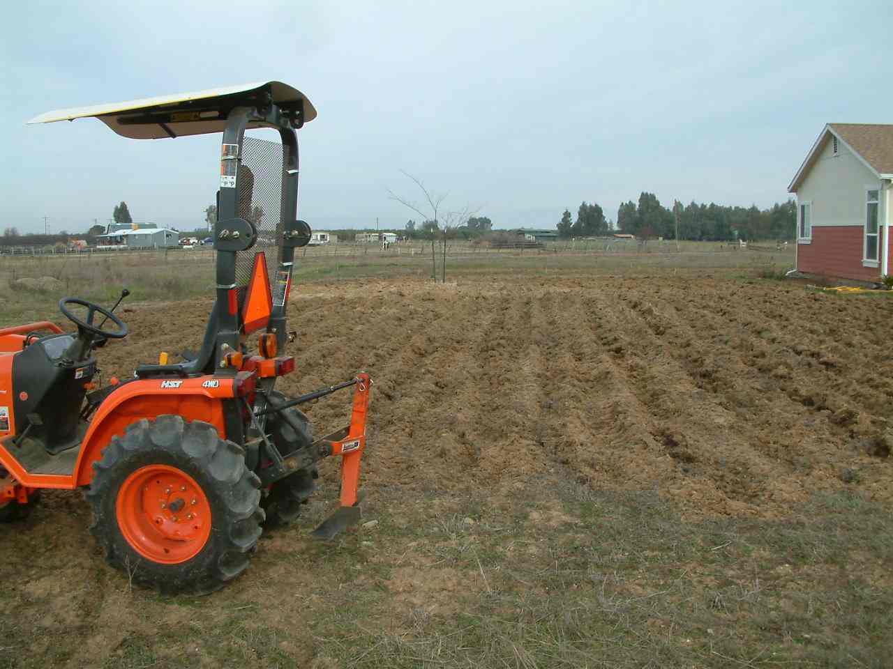

MT:

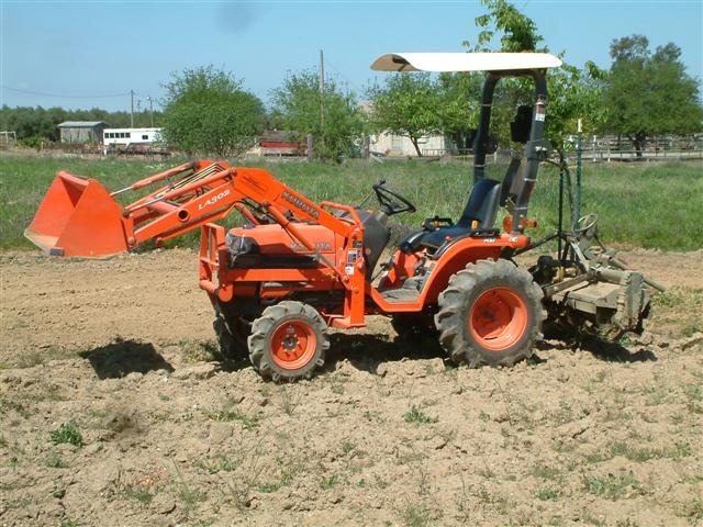

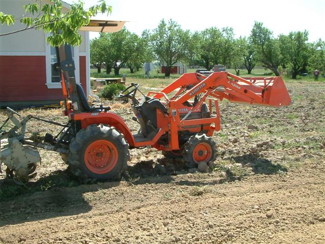

When I had my 2005 Kubota B7510HST, my rototiller was a used 48" Yanmar RS1200 ($300 at my local grey market tractor dealer).
If the ground is dry and hard, I hit it first with the middle buster plow ($150 from Tractor Supply) and then rototill.
If you're on a budget, this is one inexpensive way to go.
