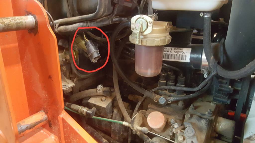

I'm having an issue with my fuel gauge. I haven't done much trouble shooting yet. But I did notice this in the pic below. I don't see anywhere it should be connected, so am I missing a relay or something? 20170508_092453.jpg

That is probably just an extra connector for an option that is not on the CK30. Kioti uses the same wiring harnesses for multiple tractors. Fuel gauge is a common issue it is on top of the tank and you have to replace the sender, sometimes it can be taken out and bent then it will work again but most people just replace it. If you search you will find many threads on it.

On my 2010 CK30hst there is the same connector not connected to anything, so it must be an extra connector
