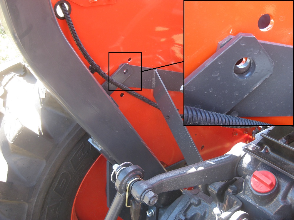

We have a new L3200. To me, it looks like bolts are missing that attach the ROP to the tractor. I attached a photo that shows the possible missing bolt (same on both sides). I plan to contact the dealer, but wanted to check with others also, do you have a bolt in that location?

Sure does look like a bolt is missing whether or not it is for the ROPS. It does look to me like the missing bolt may stop forward/backward movement of ROPS ( as in backward flip ) for reinforcement .

Looks like you need one of those special bolts that threads it's way through 3 misaligned holes. I'm surprised the fender isn't flapping around, it looks like that's the main thing it's supporting.

I think that bolt is for the fender support, not the ROPS. Note there are three at different heights, so the fender height can be adjusted (mostly likely due to tire selection).
The sheet metal of the fender would crumple in a rollover, thus not providing any support.

I would order the correct ROPS bolts from Kubota, just to be sure you get what they spec'ed for it.

Thanks everyone, this was really helpful. That is correct, it's a fender bolt, not a ROPS bolt, it is attaching part of the ROPS structure to the fender.
I spoke with the dealer and they did not attach the fenders correctly (there were some other mistakes). Even though it was the fault of an inexperienced employee, they should have caught the mistakes before delivering the tractor, but the dealer fixed the problem immediately and went out of their way to make sure everything was resolved.
