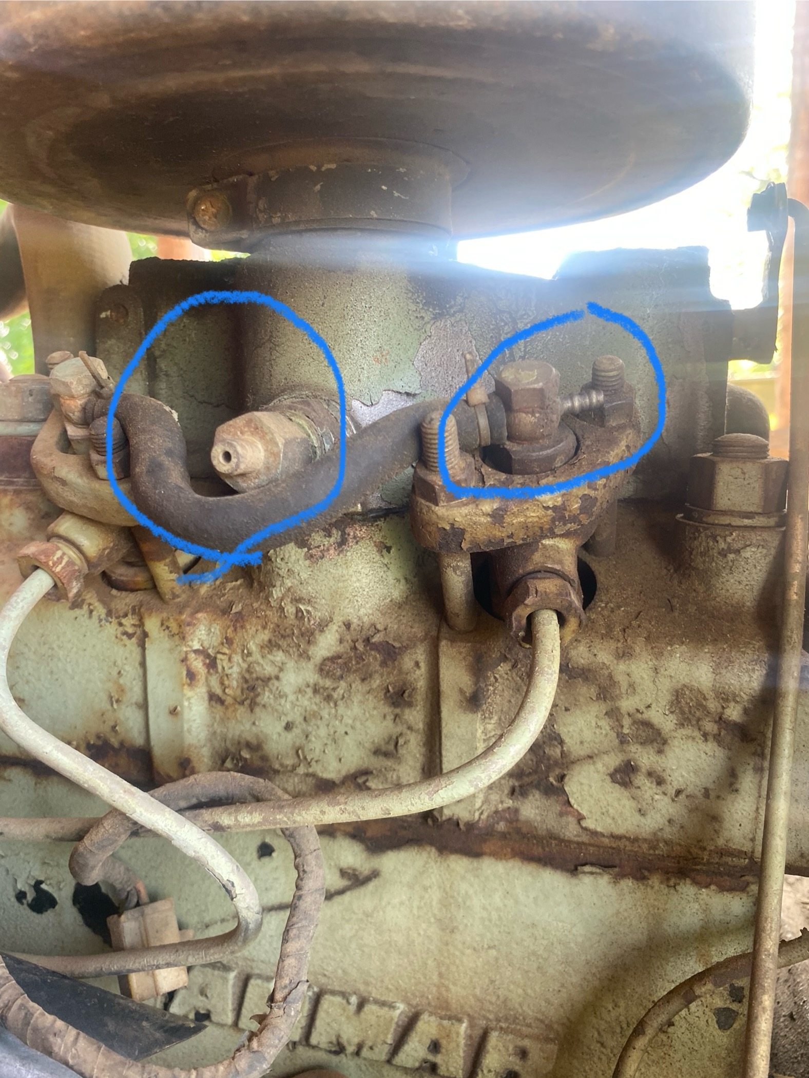

Can someone tell me how these open fittings are supposed to be plumbed..??? The fitting on my Deutz injector goes back to the fuel tank and recycles unburned fuel but I can’t figure out where it’s supposed to go in my Yanmar. I though it may go to the open fitting on the left but they are different sizes.

You have two unrelated things there. The line between injectors should continue to a small plastic nipple at the top of the fuel tank, as you described for the Deutz. On some later models, it feeds the Thermostart reservoir before getting to the tank.

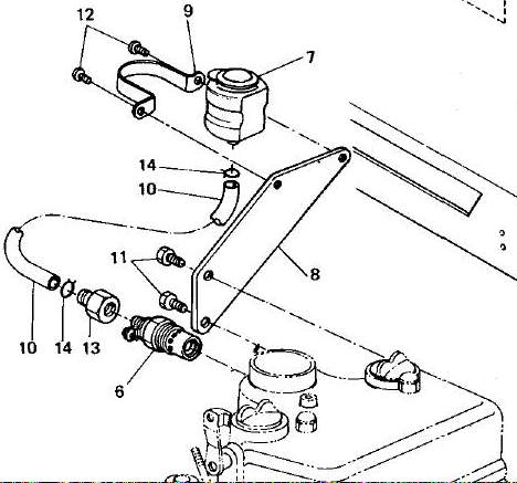

And the other, larger fitting is the Thermostart, a pre-heating device similar in function to glow plugs. Internally it's about the same as a car cigarette lighter, a coil that heats when electricity is applied by turning your key to the left. There should be a tube down from the Thermostart reservoir, a small plastic bottle mounted up by the top radiator hose, that you fill with diesel.
When the Thermostart heats up, after some 10 seconds it allows fuel to come down that tube and into the intake manifold. Then after a moment the heating element ignites that fuel inside the manifold.
Thermostart is a cold weather option, not essential in a mild climate. Looks like your prior owner didn't need it.
632400-thermstart-diagram-jpg.37146
dscn5123thermostart-perkinsbox-jpg.68476
Here's a post I made long ago with photos showing the Thermostart fuel vapor, then flame.
Hoye later used these photos in their description.
