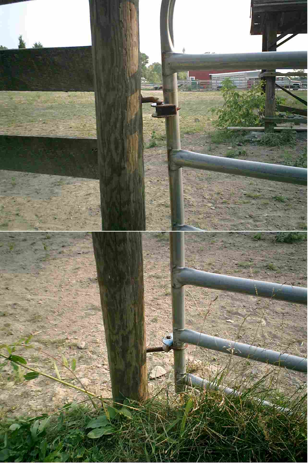

The gates I have use the 'L' shaped hinges. The long leg of the 'L' is threaded for screwing into a wooden post. The short leg is where the gate sits. I point the bottom hinge up, which is standard. I point the top hinge down. This prevents our horses from lifting the gate off it's hinges. The enterprising thief could unbolt the part of the hinge that attaches to the gate, but a few taps from a chisel on the U bolts would prevent that.
This is kind of hard to explain, so I will take a picture when I get home tonight. Nothing can be much cheaper than turning the upper hinge a half turn more and a coupla whacks with a chisel. /w3tcompact/icons/smile.gif No need for chains, locks, concrete, additional bolts, etc.

Attached are two pictures of the upper and lower hinges of one of our gates. As you can see, the gate cannot be lifted off the hinges unless you loosen the U-bolt on one of the blue parts of the hinge. To loosen one of the U-bolts would require a socket wrench and an extension. Use a chisel to ruin the threads on the U-bolts and someone would have to be real determined to get the gate.
