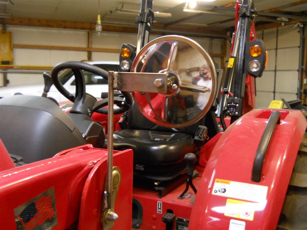

I put one on my left FEL post using the existing bolt on the top pin. Used a couple stainless tabs welded to some 3/8" stainless rod. Mounted about a 6" Ebay convex stainless [ are you seeing a pattern here..?? ] on it. Liked it so much the following year I put one on the right FEL post. Mine are mainly for ' noticing ' folks coming up on me whilst I am out on the road, though.

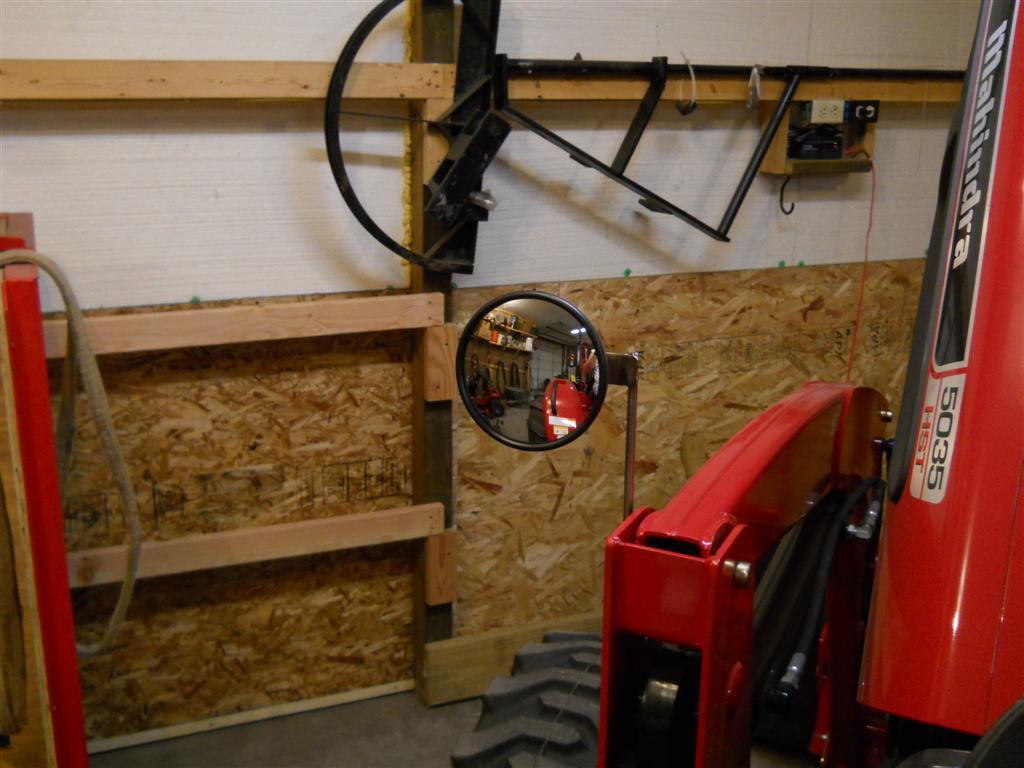

My back is arthritic and the bottom few vertebrae are fused, so turning around to see involves rotating my butt in the seat to get enough rotation to actually see anything. Not a good solution, and results in a painful neck the day after a workout with the tractor, so I know the pain of which you speak.
To my mind, the FEL main posts are the most logical places to mount mirrors on an open station tractor.
They will provide a solid, low vibration attachment point and are located approximately where you want to mount the mirrors for the best view behind the tractor; to either side.
For a view directly behind the tractor, I think one of those backup cameras looks like the cat's whiskers.
Having all 3 in the same visual plane seems like the ideal solution, and is what I want to try.

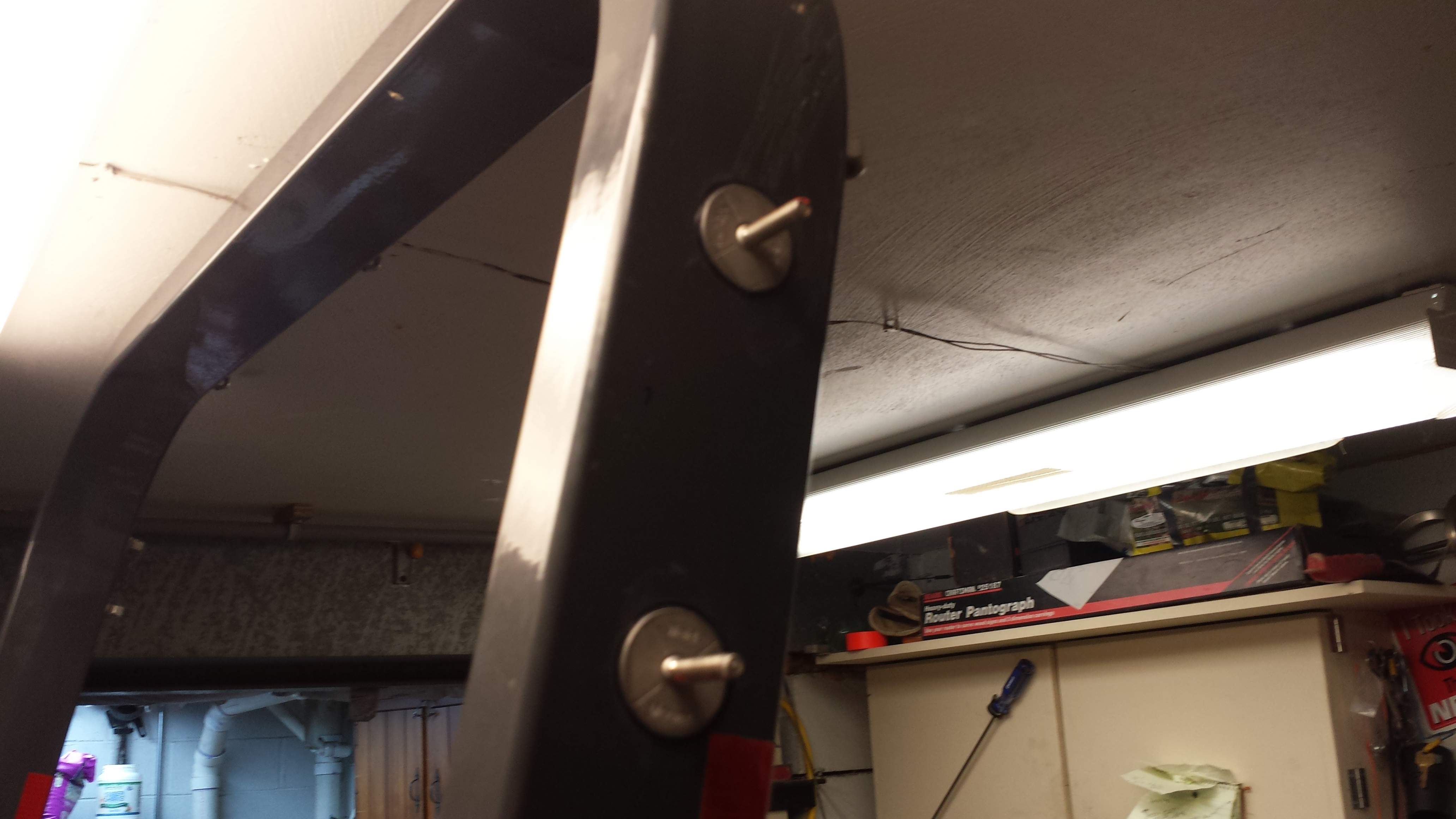

I bought golf cart mirrors off of Amazon for $12 apiece, they rotate when hit and have been doing great.
I secured them with Weld Mount 2 part adhesive with stainless Steel stud mounts.
Sets in minutes.
The weld mount is FAA approved so its a pretty tough adhesive.
I also hung a fire extinguisher on the ROPS with it and so far so good.
Picture kind of bad hope it helps.
Mirrors sure save neck time.

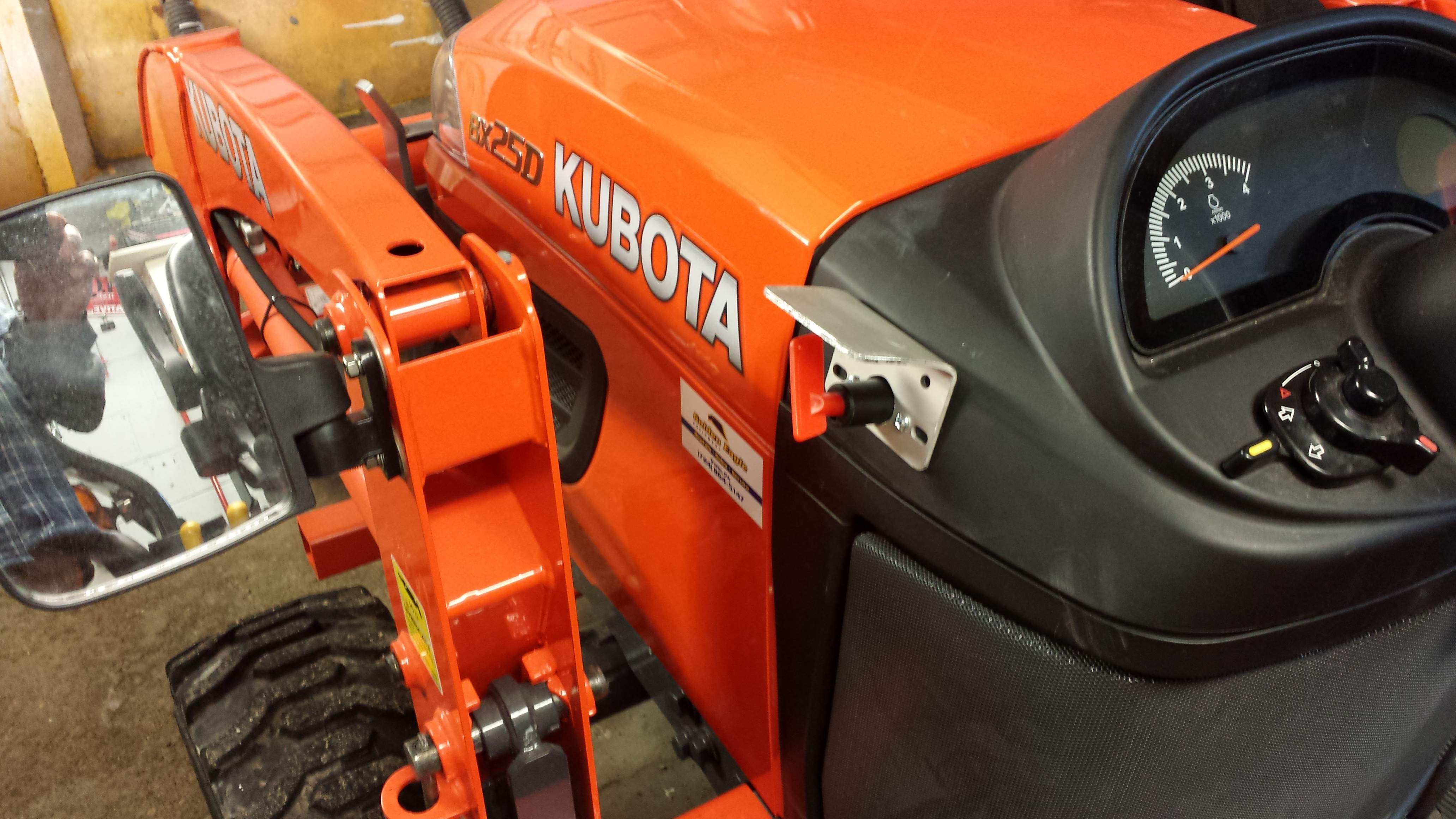

I had a backup mirror mounted on the FEL main post on my previous tractor. It was just a plain old round mirror on a stalk and attached to a bolt on the FEL. It was a Godsend in the winter when I cleared snow off my mile long gravel driveway. I used a rear mounted snow thrower.

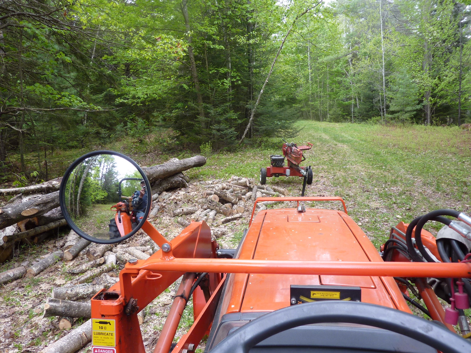

This is how I mounted mine. I wanted to keep it in a little as I am in the woods a lot but I can still see behind fine. I just put it on last month it is very helpful especially when doing road work and backing into the garage/shed when you also have to watch where the bucket is going around other equipment or the wife's car.

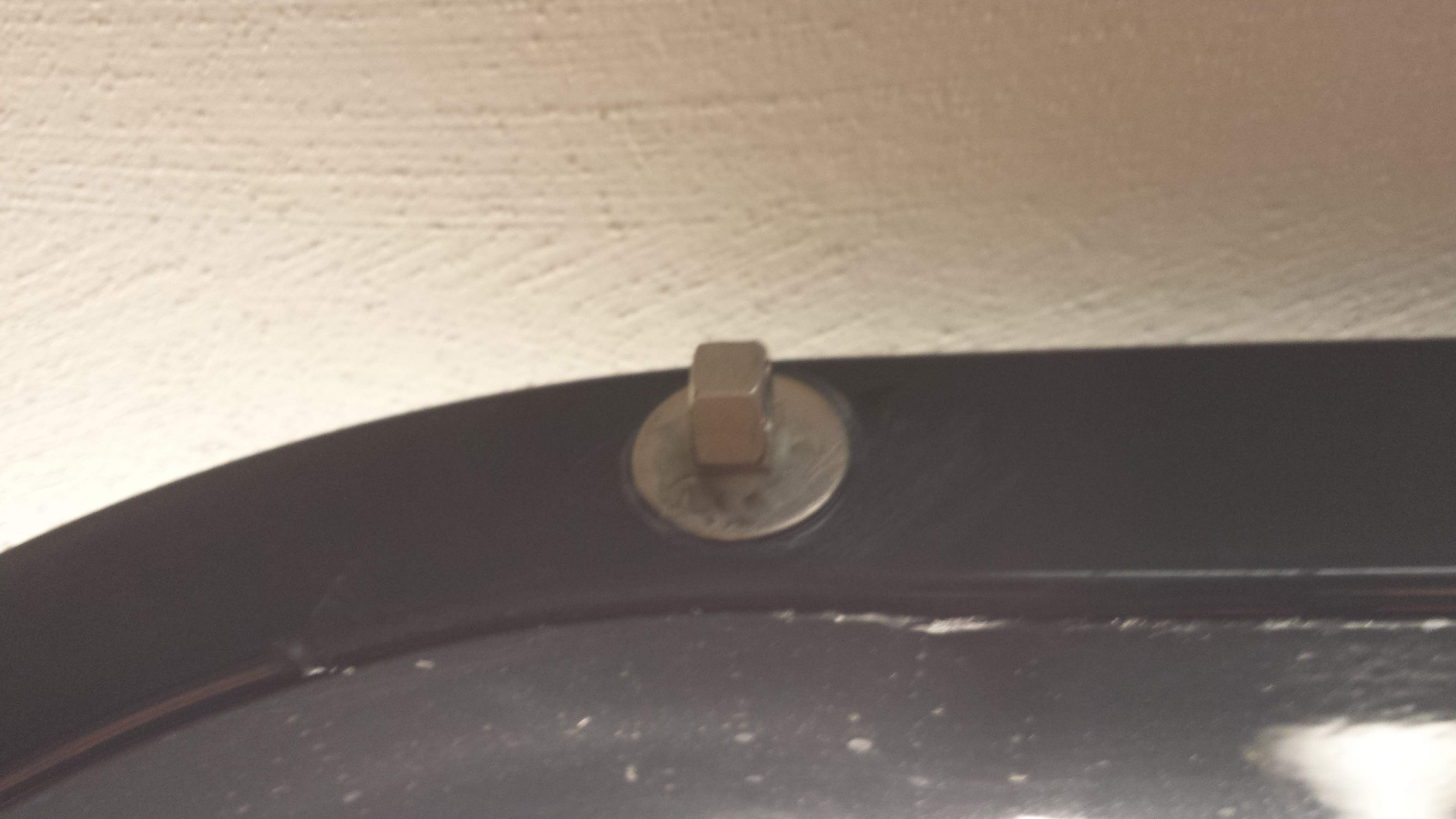

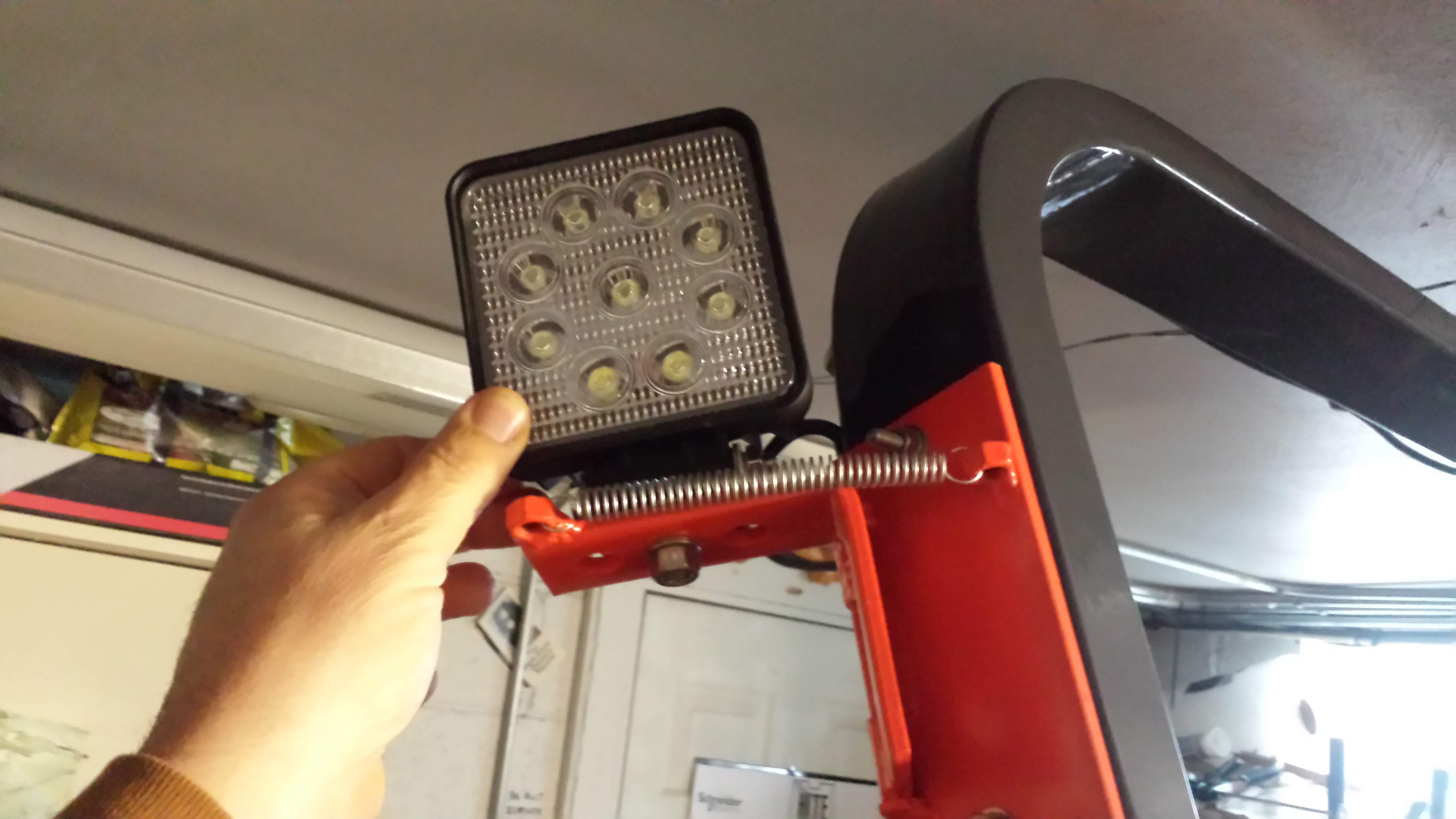

I went with the 1030 two part applicator and stud kit from Jamestown Distributors.
It is a little expensive but just so easy to glue the studs on in some of those hard to reach places.
I also make my own studs and widgets out of stuff from the parts drawer or the hardware store.
Shelf life in the fridge is a year.
The small 1030 applicator I got a year ago is still about half full after many projects.
So far after a lot of bashing none have failed.20150118_095834.jpg20150116_183859.jpg20150116_183739.jpg
