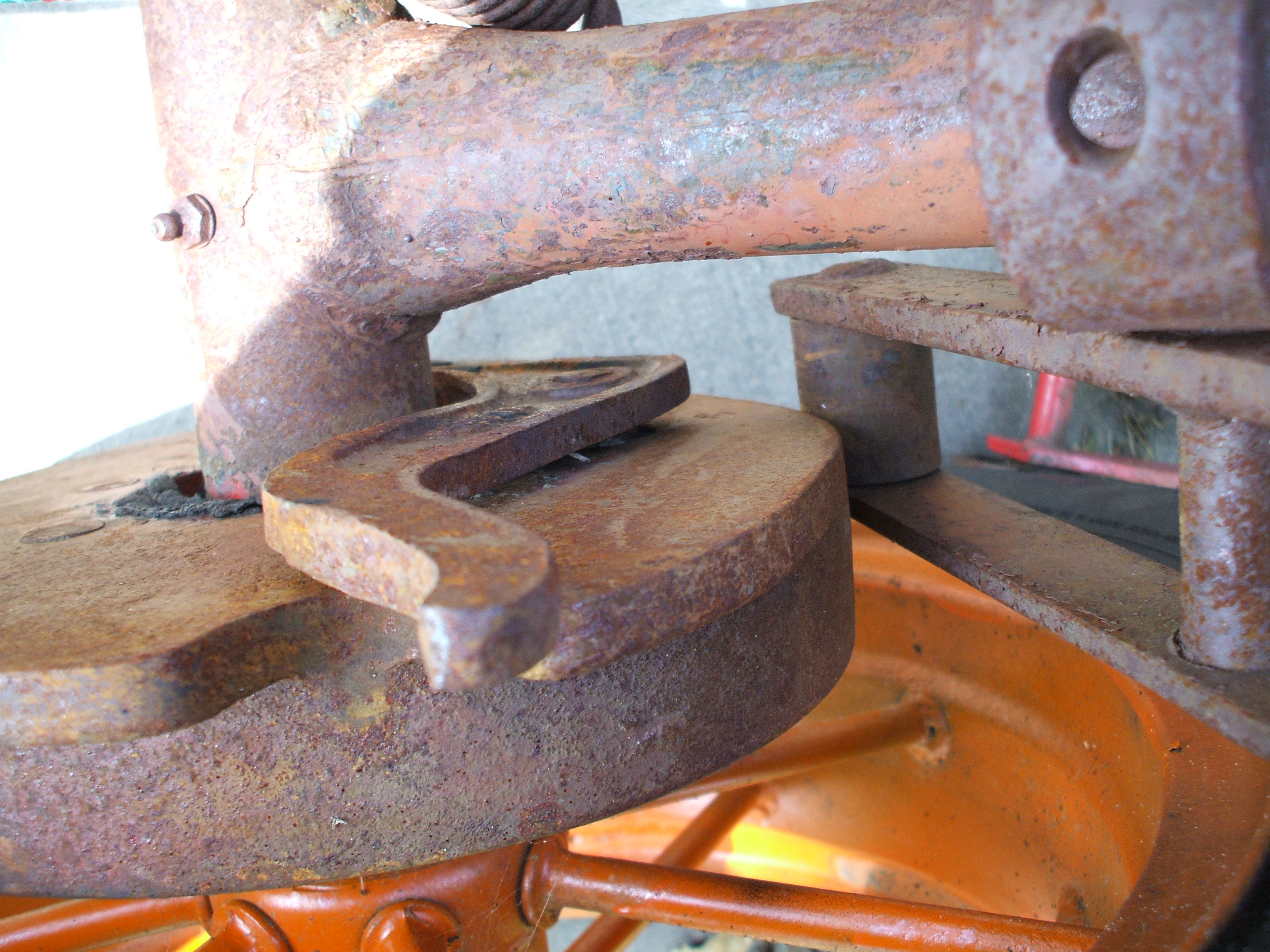

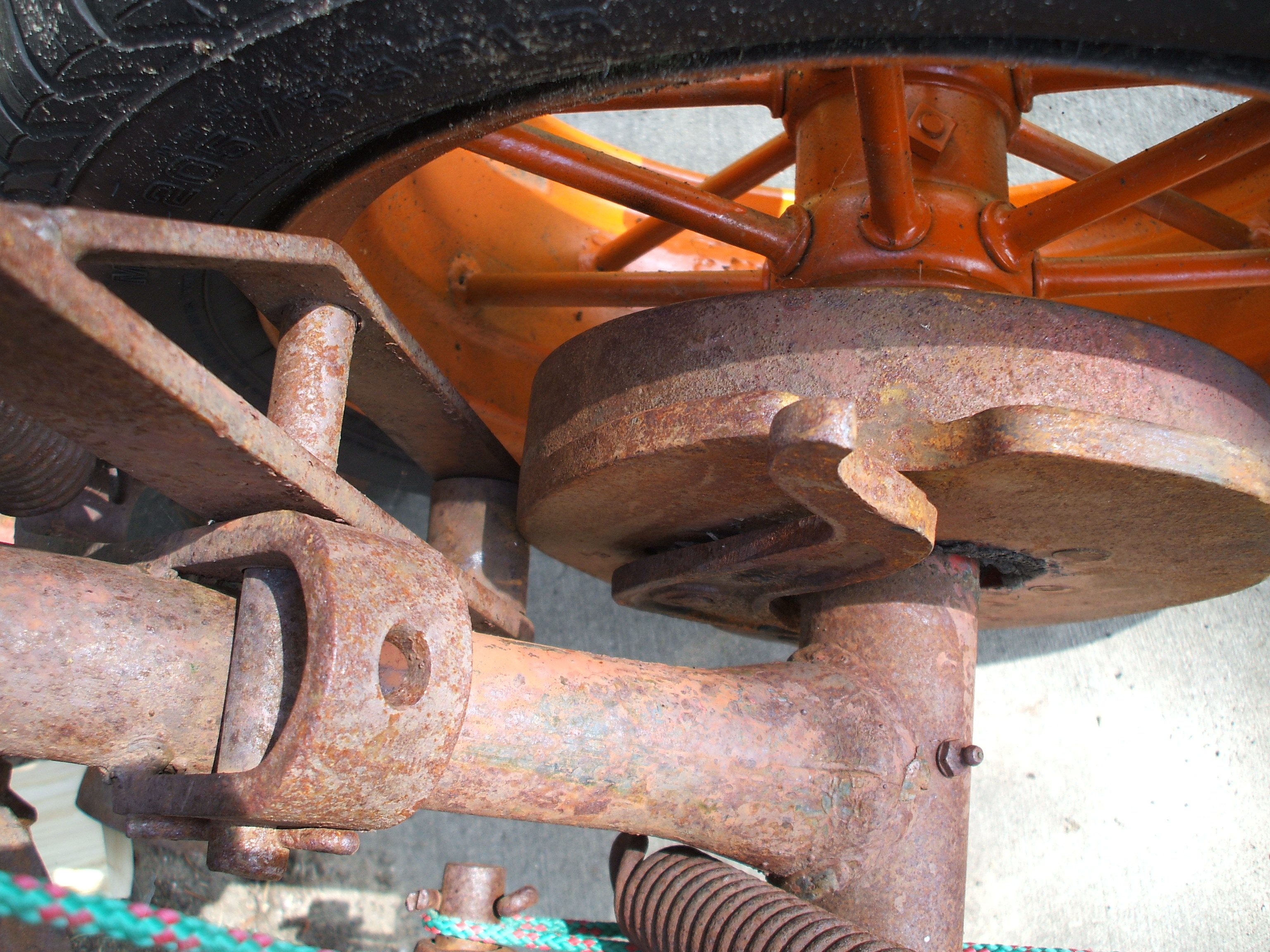

how is the rope trip mechanism supposed to work on this plow? When I put it back together I must have placed the trip mechanism on wrong when I pull the rope it doesn't engage anything and I have it so the wheels are lifting the plow.? How does the trip lever get positioned? DSCF0467.JPGDSCF0468.JPG

Your pics are way too close. Hard to understand what we are looking at?

this is looking down from top of plow. Trip lever is on the left of hub and right of hub. Couldn't find an angle that would show the arm and trip lever on hub. Small lazy s piece is the wheel lever.

The lazy S piece needs to be oriented so that it captures the lift linkage when traveling in the forward direction and the lever is tripped to raise. Almost looks like could be oriented incorrectly but difficult to tell by the picture
