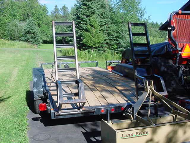

Get one long enough to carry that entire setup. I had one made that has two-6,000LB axles, but when I have the Box Blade and FEL on, have to remove the tooth bar (That's how tight it is.) If I move my L3130 with the Bush Hog attached, have to remove the FEL - all big pain in the neck. My Loading Ramps fold up - currently getting them cut off at a welding shop and going with 5,000 LB aluminum ramps that I can remove completely so the Hog can hang over the backend of the trailer. Will attach a picture of my "Ramp Problem"
penokee /forums/images/graemlins/smile.gif
Ps: Had the trailer custom made 10 years ago or so for my AC H3 Crawler - never thinking that I'd have anything else to haul /forums/images/graemlins/frown.gif

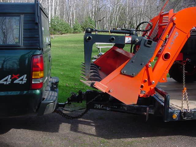

Fj - A picture of one more problem you want to avoid. Punctured my tail gate with the tooth bar when turning too sharp, so removed the bar and raised the grapple up - for what it's worth, you may want to avoid these type problems.
