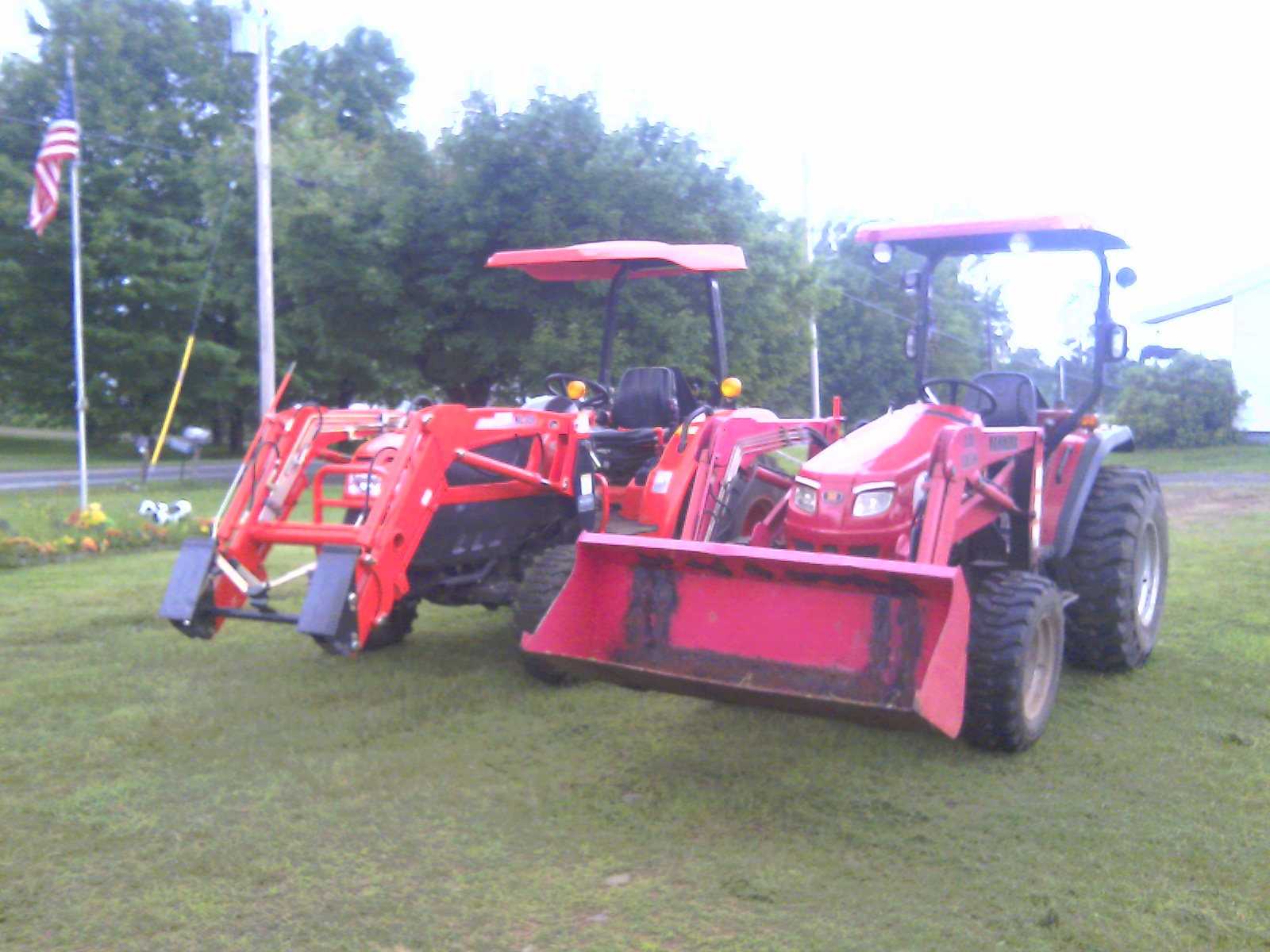

Well boggs first of all welcome! I have 2 HST's, a Kioti DK35SE HST and a Mahindra 2810HST which are used hard. I mow a lot of acres a week and do mowing for others in my local area and last Saturday with temps near or at 100 degrees i mowed with my RD finish mower for 7 hours in low range with the cruise set at a creeping speed doing some heavy mowing with no problems. Kioti has 1560 hours and the Mahindra has 1200 hours with no trans. problems. Use them on a 72" brush hog tiller the same way. Keep in mind now, you might have different results but this has been my experience. . . .good luck . . .John
