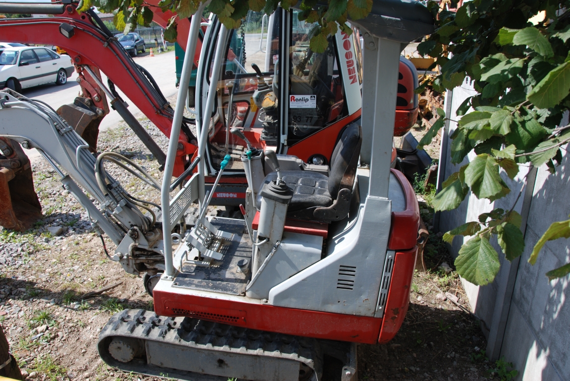

1994 Takeuchi TB015 with 3000hours, track width expansion, and 16 in bucket sold by Takeuchi dealer for $7,600.

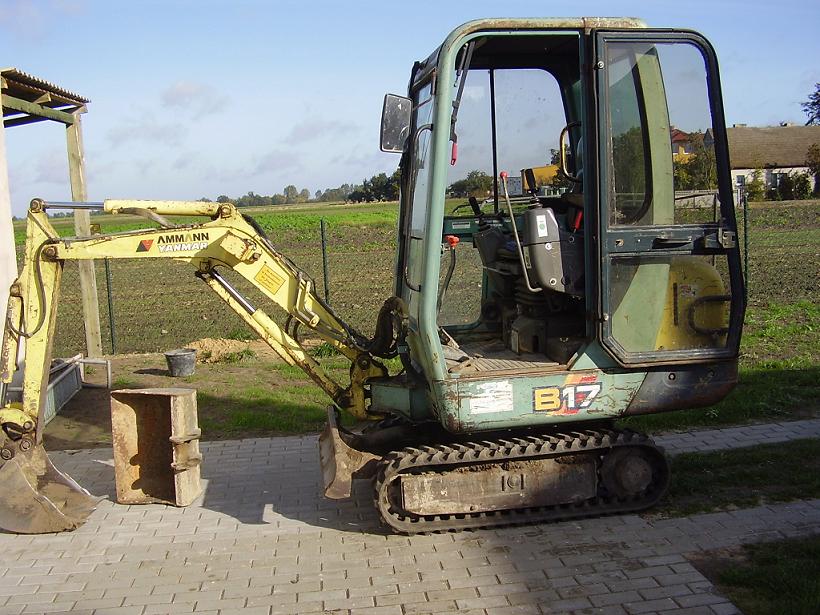

1995 Yanmar B17 with 3770 hours and 2 buckets (16 and 24 in) sold by individual for $8680.

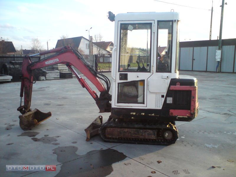

I went and checked out the KX41 today. It had not been started for some time and it has been very cold--like 15 below F--but warmer today 26 F. It started right up without any hesitation. The undercarriage seems to be in very good state. lo leaks and straight tracking.
What I was disappointed in is the slop in just about every pin and bushing. The bucket was so sloppy that I will pull that pin and see if the wear is into the material of the stick. Secondly 3 cylinders were seeping oil. The boom cylinder is bypassing internally. Third, there is a fuel leak of some kind on the back side of the engine, I could not see exactly where without pulling the seat and a panel.
The buckets are in good shape and the trailer is in fair shape. But. . . there is a lot of work needed in order to get it ready to work.

Sorry to hear that the Kubota is in rough shape. The Tak looked to be pretty clean in the pics (but no... well, you know).
Don't know much about Yanmar - beyond that they make darn good engines. Everything I've heard regarding Tak's is good.
