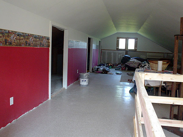

Not sure what Freon it uses, but when we made the top of our barn to be kids playroom/quest room we used a split unit. I dont remember the size of it anymore, but after 4 years it still going strong with cooling in summer and heating in winter. It generates heat down to 36F outside temperature and it easily heats up/cools down the space.
Would do it again without question. I like the heat/cool option - unlike window units - and the safety heating for a kids play room.
I bought it on ebay and installed it all myself - wiring, copper plumbing - and the HVAC guy did the final connecting and charging.
Here is a photo from some work progress, the unit is on the wall in the back right. The area is 40 feet long and 15 feet wide and I dont remember data on the unit but I can look it up if necessary.
