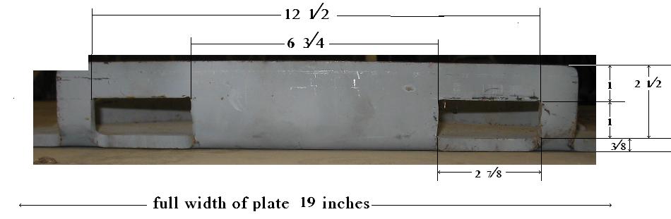

I'm getting ready to build a mini hoe for my 180 and I need some information. What are the dimensions of the attachment plate, length of crowd arm, wall thickness of the arm and bucket, what is the bucket size?. Could someone who owns a mini hoe post some close up pictures of the attachment plate ETC. I can order a PT mini hoe but the cost is $1000.00 plus an up charge to remove the 422/425 attachmelt plate and weld on a 180 plate.
Thanks.
   / Mini Hoe #2
I have these pics now. The others I will have to take later

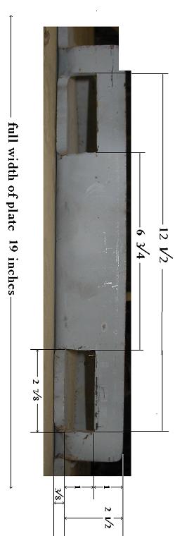

   / Mini Hoe #3
the other pic

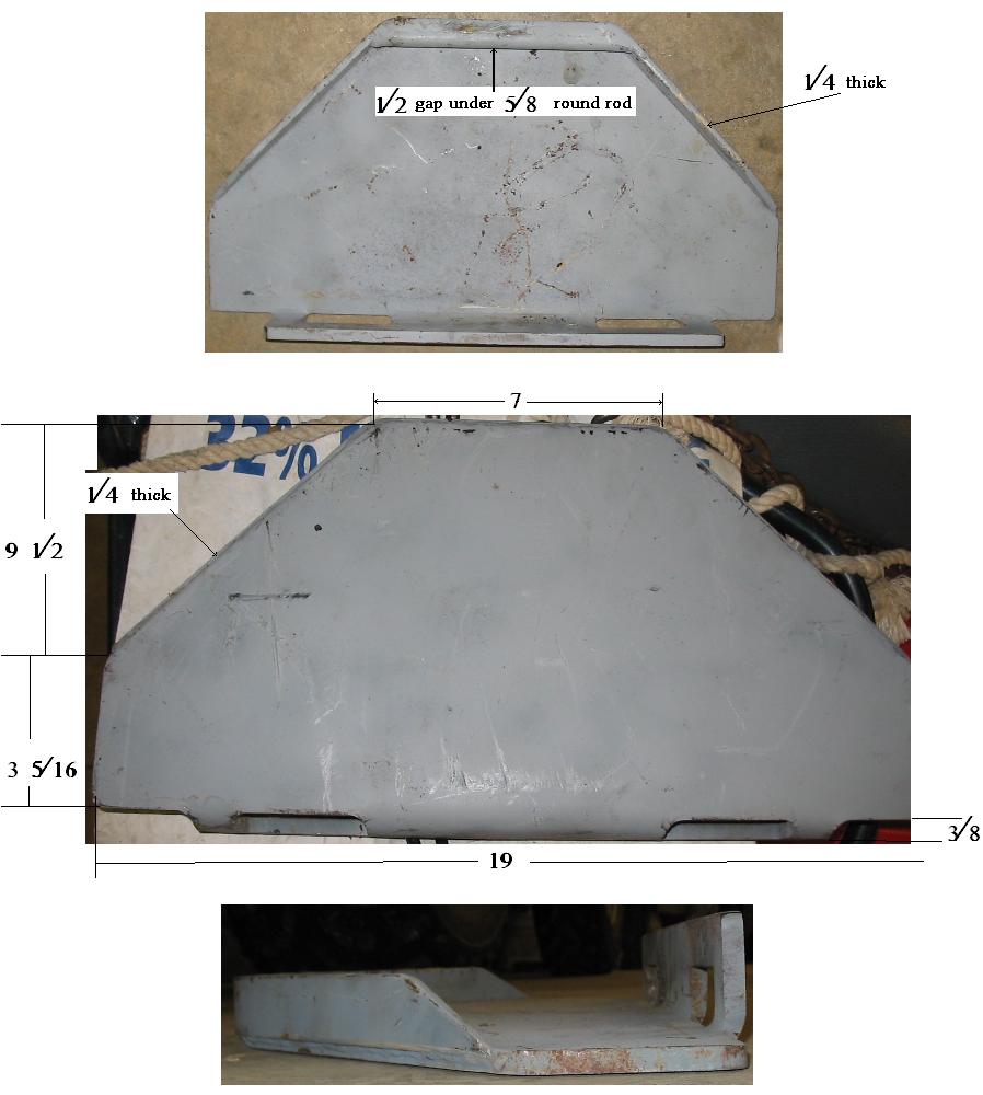

   / Mini Hoe #4
I will try again maybe with a little better resolution.

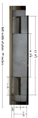

   / Mini Hoe #5
another pic
