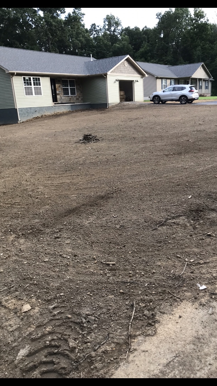

I’ve ran a CTL before and can do first class work with one but they have their downsides. Imagine if that site was a grassy area and the 4 yards of material was gravel. With the CTL the the ditch is a mess and needs a lot of hand work and is probably too big and waste material. And the grass is destroyed. With the excavator the ditch is neat but the material moving is so impractical you’re probably out of the one machine race. The gravel is going to be full of dirt and the grass is full of gravel and the farther you go the worse it gets. The grass is equally maybe worse destroyed than with the CTL. If it’s too wet to load my truck with my backhoe it’s far to wet to get my dump truck within the reach of the excavator. I’m not saying those machines don’t do a good job, but limiting yourself to one or the other you’re compromising a lot. Here’s a site prep I did with a CTL. The only hand rake that touched that job was used to rake up that small pile of sticks. IMG_8148.JPG
