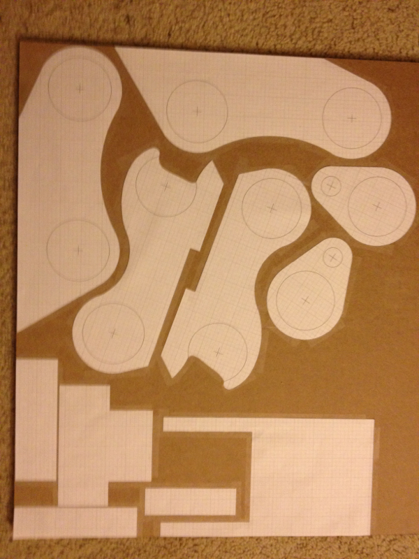

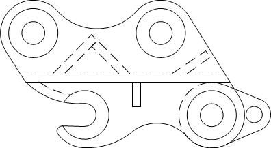

I am thinking about building a quick hitch for my NH EC35 and have some questions about design and machining. First the design, the thought is to create a hook on the front and just pin the back, will this be strong enough to handle the stress? It will be all half inch steel and the tubes will have 5/8" walls. Here is my design:

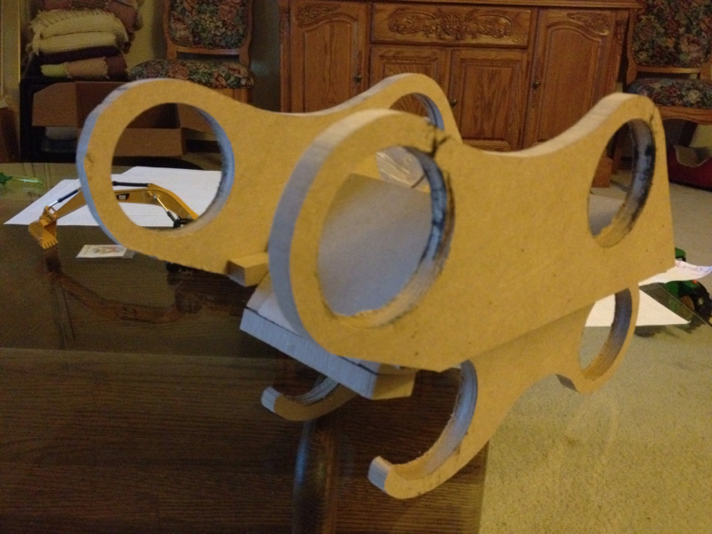

I think I do feel more comfortable about the design though. The one listed above seems far lighter than what I have planned, so I won't worry about that any more. I am going to make a foam model of it this weekend. I will use it to fine tune the design before I commit it to steel. I will take pictures of the model and post them here.

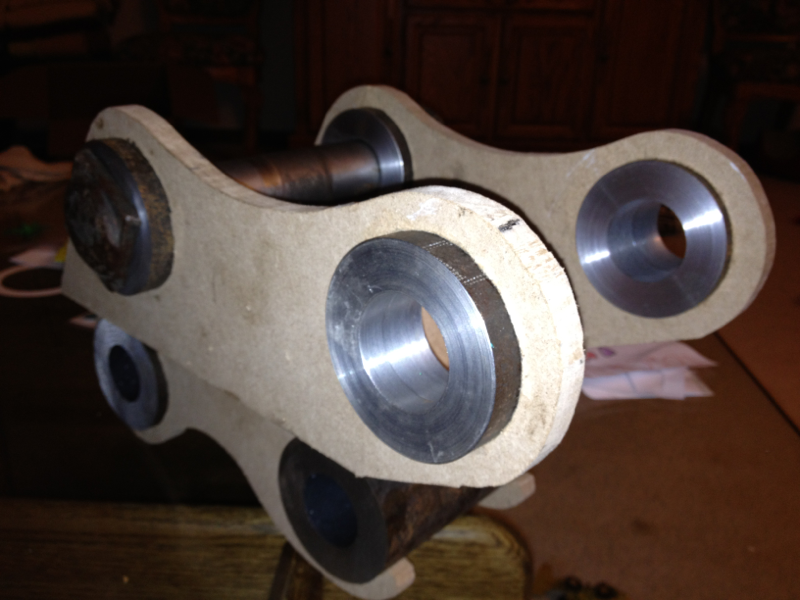

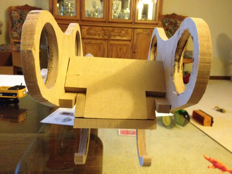

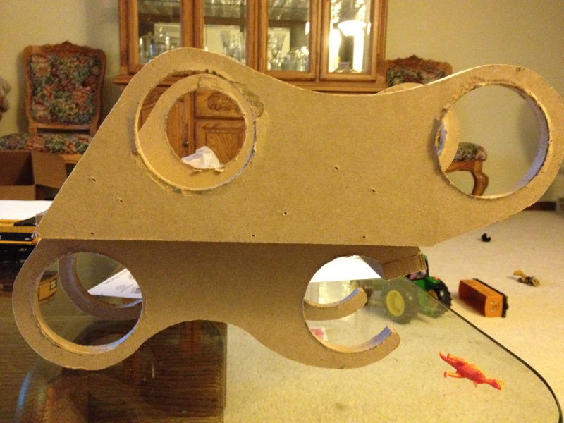

Well the project is coming along. Built the model out of wood last week with the exception of the pin sleeves to check fit and look at how the thing will go together.
Today I machined the top set of sleeves and got the bottom 2 cut to 1/8" over. Now I have a problem - I don't know how to hold the bottom sleeves to bore them to the right diameter. I put them in the chuck, but they wobbled too much for me to feel comfortable cutting on them. Any suggestions? Here are some pictures of my progress.
