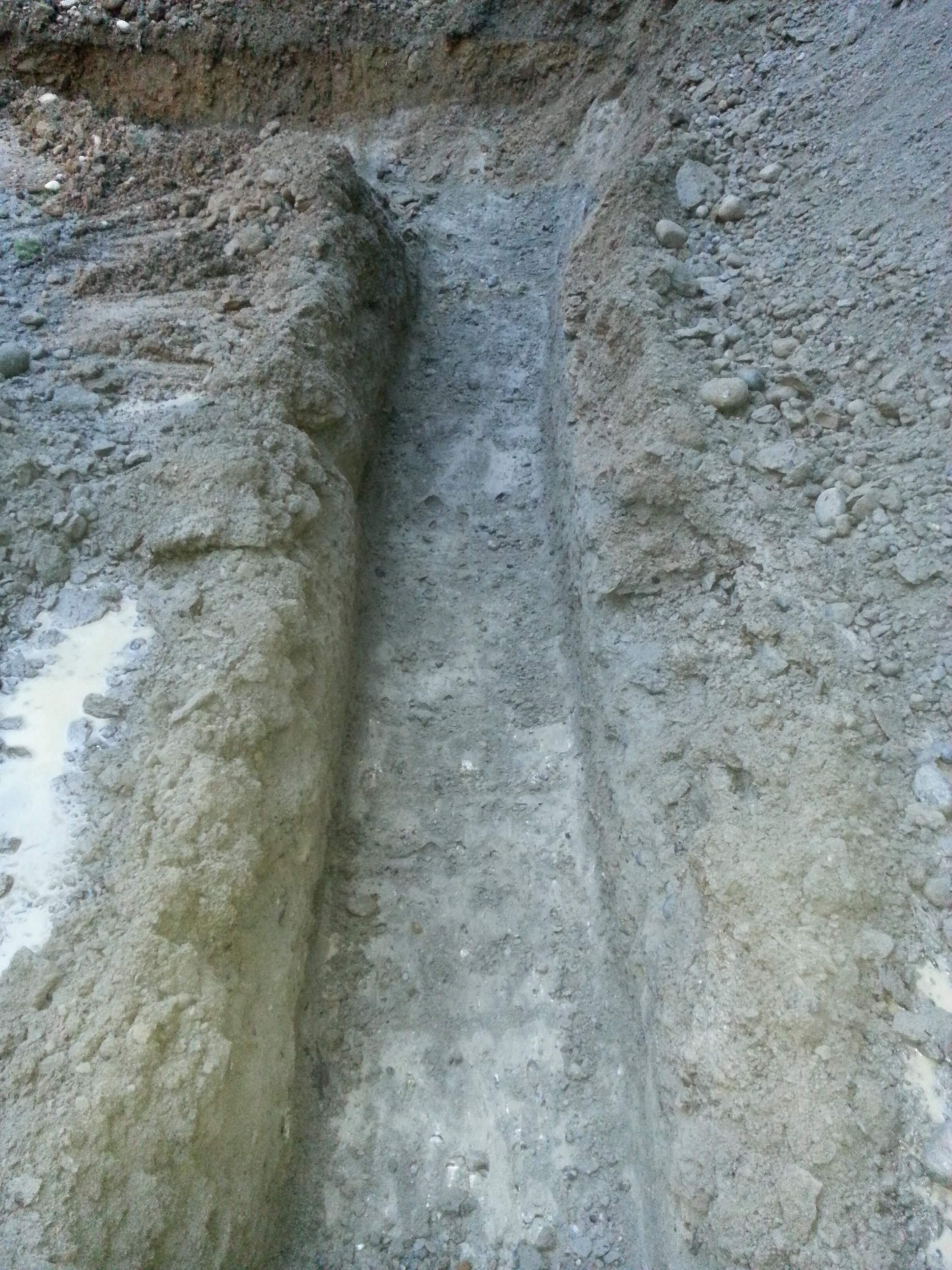

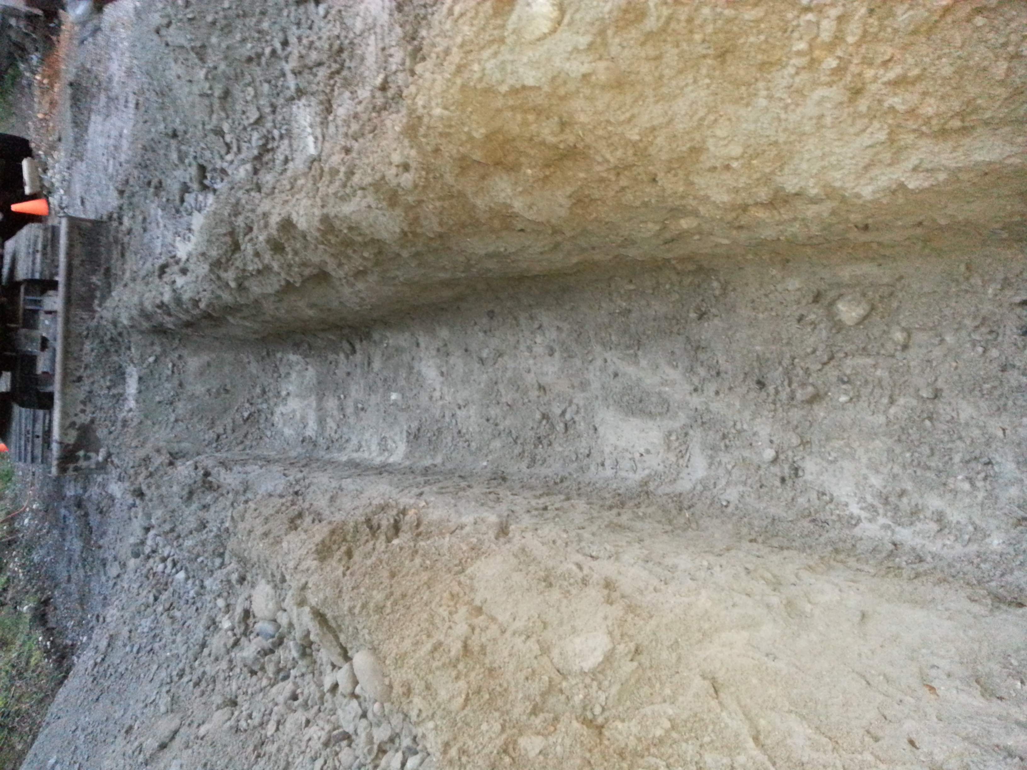

Talked to a few folks about which is the best teeth for working caliche, aka grey concrete or hard pan. I have 220' of 24" x 26" trench to do and it's all hard. Have done about 30' and a dogleg so far, averaging about a foot per hour. Would like to get some recommendations for teeth.
Thanks

Hahaha. I agree, but that's what I've got, a 3-1/2 ton. Ok, maybe I overestmated the time by 10 or 15 minutes.
Here's what I did in 5-1/2 hours.
