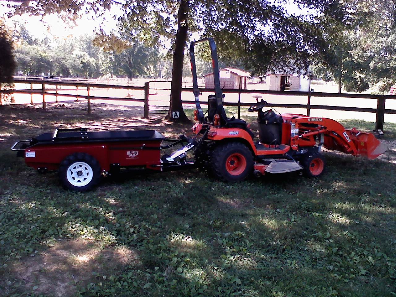

I meant to upload a picture of mine on my last post. Here it is if you are interested.

Thanks, that is about what the 37 looks like only it is longer. I want the longer one so I can load it with a 6' bucket without making a mess.
