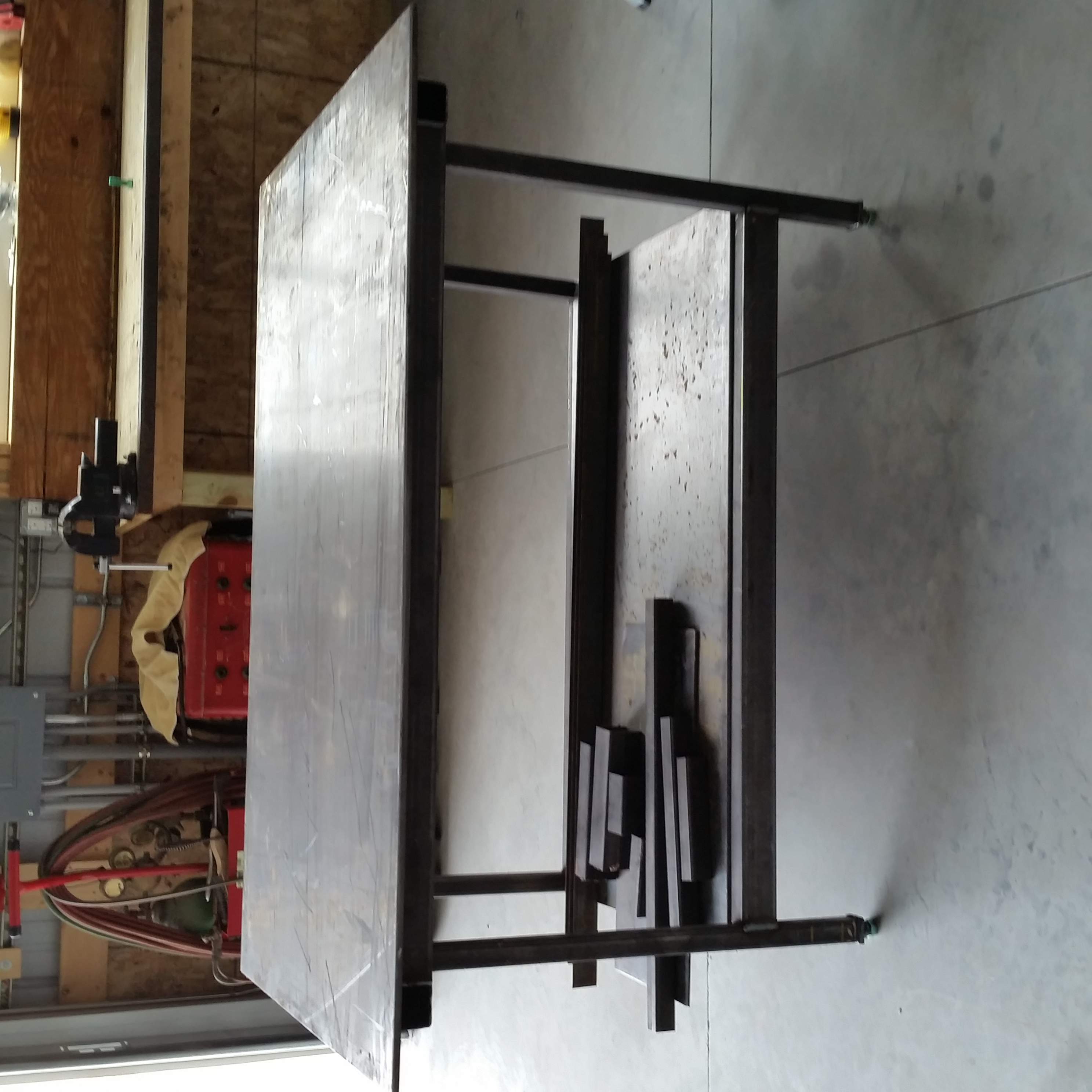

I have a weld table with all the mill-scale removed from the tabletop. It looks like it was wiped off, as there are no sanding scratches. How was it done?
What can I use to keep it from rusting in my unheated shed that won't collect dust and dirt, and maybe even prevent weld splatter from sticking?
I don't know why the pic is sideways.

You can buy steel in that condition, I believe it's called pickled. I think they use acid to remove the scale. I bought some once to make a hyd tank. You could use car wax to keep it from rusting. I've never tried it though.

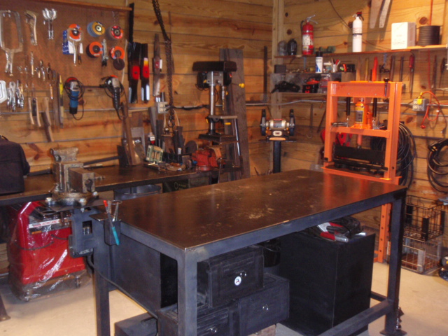

If you use the table a lot you will not see to much rust. I use WD-40 on my table top every 3 or 4 months. If you get splatter on it.... just use a flopeeee disc on it, just enough to remove the splatter.PC220022.JPG

Could be cold rolled, perhaps?
   / mill-scale removal #5
Mill scale - which is present on hot (not cold) rolled steel - can be removed by soaking (immersing) in regular vinegar and then using a Scotchbrite pad, wire brush, and/or steel wool. Could take 24 to 48 hours depending on heavy the scale is.
After soaking and scrubbing, rinse in a water/baking soda solution to neutralize the acid and then dry immediately to prevent flash rusting.

Does it have to be immersed? for that long of time? the table top is 3'x5'x1/2". That would require a big cake pan. ;)

Nice table, bigtiller. Is that a Forney welder behind the table in your pic?
Terry
Terry
Yes it is. I bought it and the Victor torch beside it, at a garage sale in the early 90's. I couldn't guess how old they are but they are pretty tuff because they have always been in an unheated shed.
