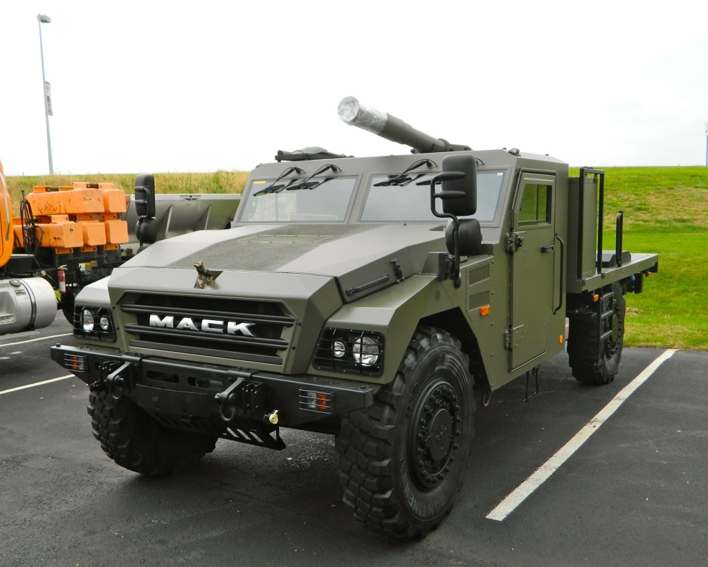

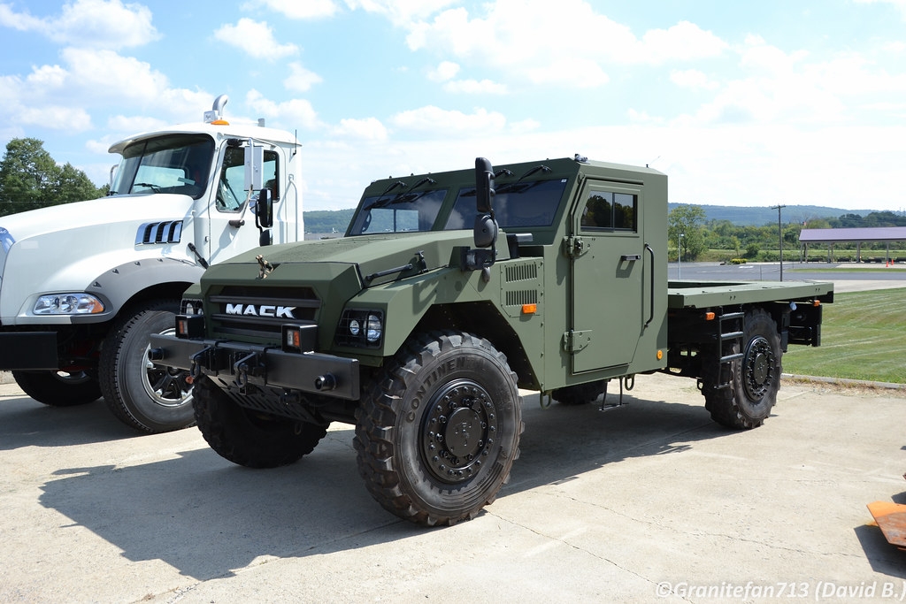

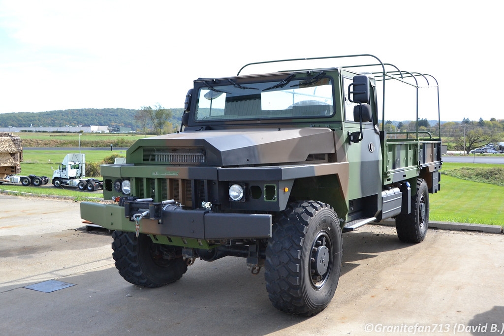

My old employer had 4 of the those Humvees. Most of the time they were broke down needing something to fix. The engine and transmission is in the middle of the vehicle. And it overheats too often.
If would be smarter to look at the retired MACK Truck Defense vehicles since they use the SAME engines as their semis. Thus, parts are better to find and the engines run well over a million miles before overhaul.

Not sure Mack produced an accepted standard light tactical vehicle as a replacement for the HMMWV (believe Mack does produce some heavier stuff for the services though). The replacement for the HMMWV is the Joint Light Tactical Vehicle (JLTV) from Oshkosh (which is much different from the HMMWV, although mission deficiencies in it drove a lot of design changes that resulted in the JLTV).
The JLTV is apparently just being fielded over the past few years to the services. I would think it would be some time before such vehicles would be surplused. Even so, doubt many folks would find an economical use for the JLTV in civilian use though.
Your point about some drivetrain commonality is supported by the fact that Allison supplies the transmission for the JLTV and GM Duramax supplies the engine. Don't know what the Allison build is for this contract, but the 6.6L Duramax looks to be the same "basic" engine that GM puts in its trucks. However, Gale Banks did the engineering on the powerplant for DOD, using the 6.6L as the basis. Be interesting to see if the Duramax block and other stuff is similar to civilian or upgraded for military use... And calling that a "light" vehicle is optimistic - GVWR on the JLTV is 22,500 lbs...
