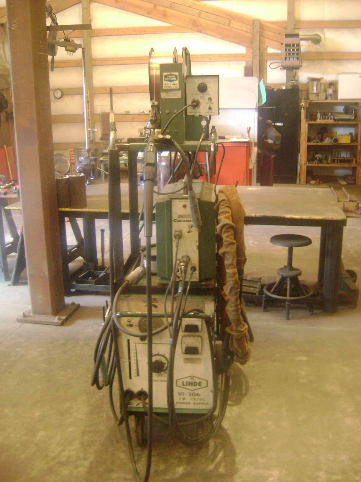

Furu here is the link to the Cobramatic. Which is another good deal if it works. And a picture of the Linde I had.

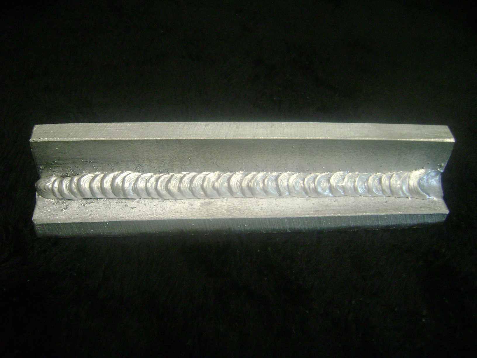

I found a couple aluminum Mig welds I made with the VI-206 and Corbramatic.

   / Mig welder. #8
Nice welds- bead hand! I have always hated al welding with mig. I never had a good feel for it. My toes always looked cold lapped and all around unsatisfactory. Oh well....
   / Mig welder. #9
This is not what I wanted to hear. I bought the spool gun for aluminum work using my Miller 211 but still playing with steel so far. Nothing urgent or big planned for Al but I hope the MIG does what I need it to do. I am trying to avoid investing in a Stick/Tig. I need a plasma cutter instead and there is only so much room in my garage/shop.

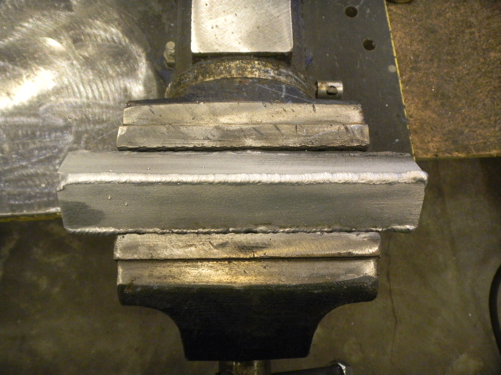

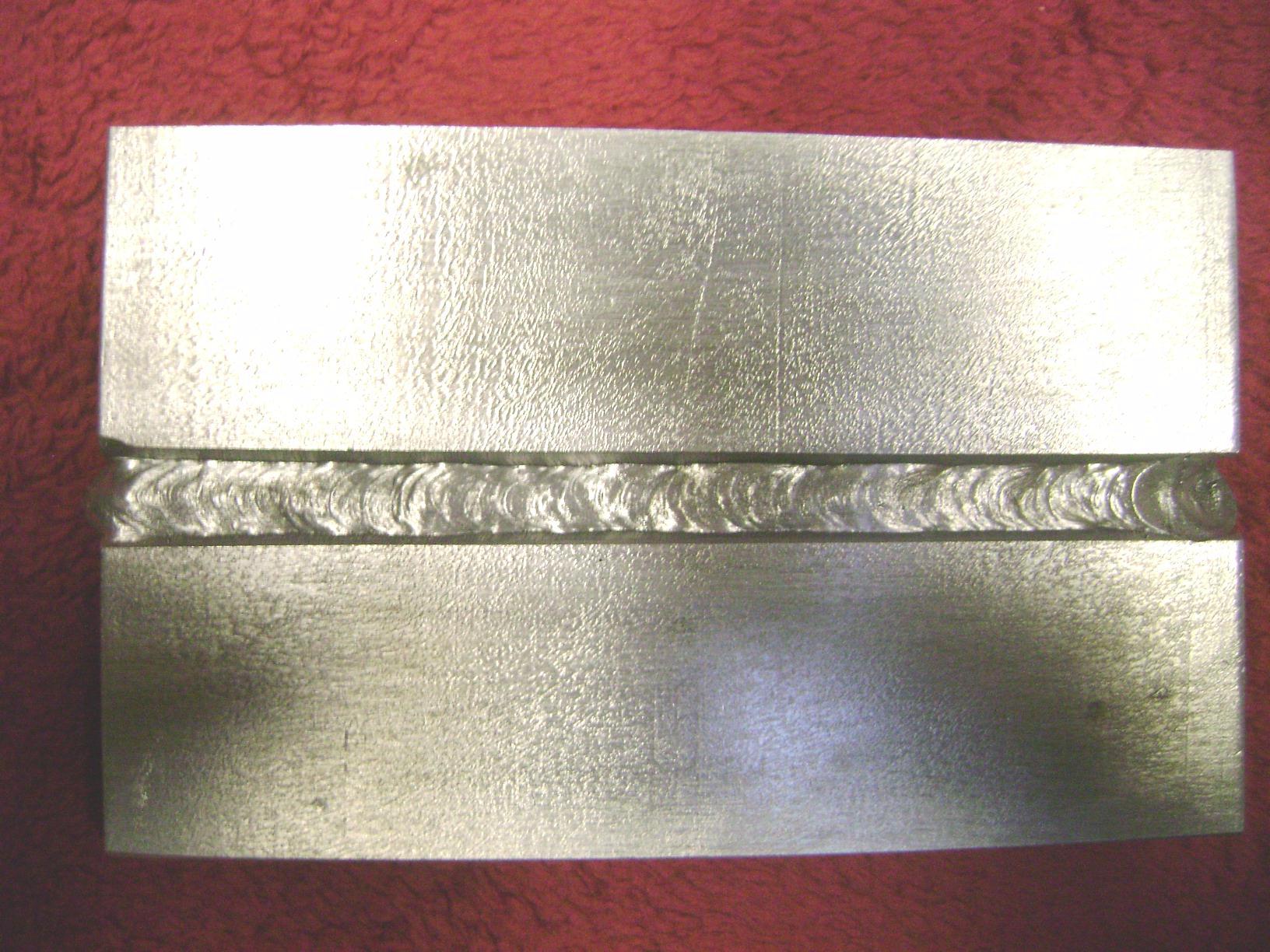

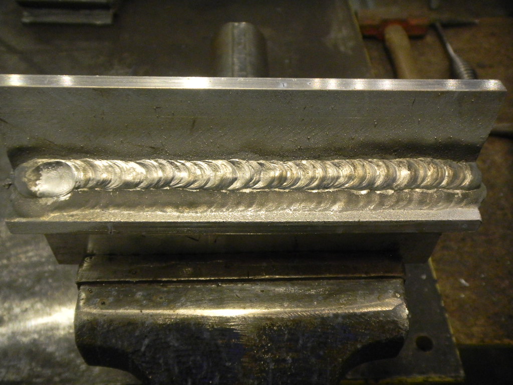

dragoneggs I'm no aluminum weldor by any stretch of the imagination! But here is what my spool gun can do.
