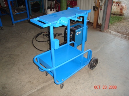

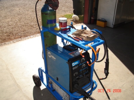

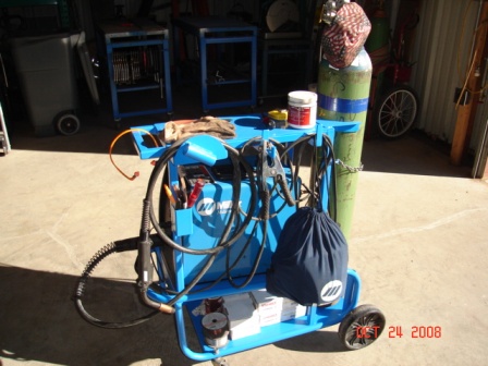

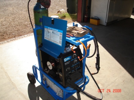

On my welding table, i welded on some ubolts. I just put the tip of the gun in it and the weight of the whip wedges it in there. On my cart, i just have some J hooks bent out of 3/8 rod and loop the welding cables over it.
Attached is a picture of my welding cart, if you look carefully you can see the hooks.The cart has my torches, stick and mig welders all in one. Probably one of the most convenient and useful things i built. Its not the best pic, but Its the only pic i have on my computer

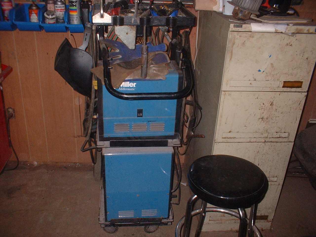

Here's mine (the 4" tube welded at an angle on the L/H side of cart) and a few other picts.
I went for a few years without any kind of mig holder so if ya just lay it down and not just pitch it like a used...nevermind...the gun will be just fine.

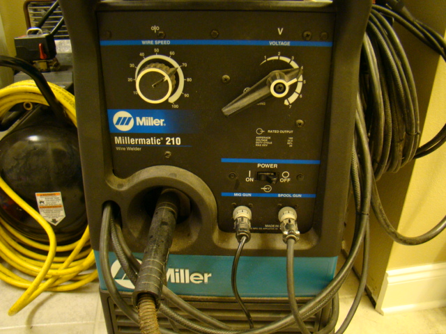

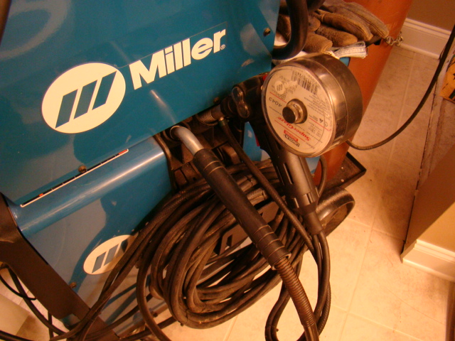

My MIG welder has a built-in holder.

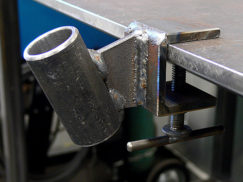

This is an old post, but I thought others may like this.. I did not make it, but saved the pic some time ago..
