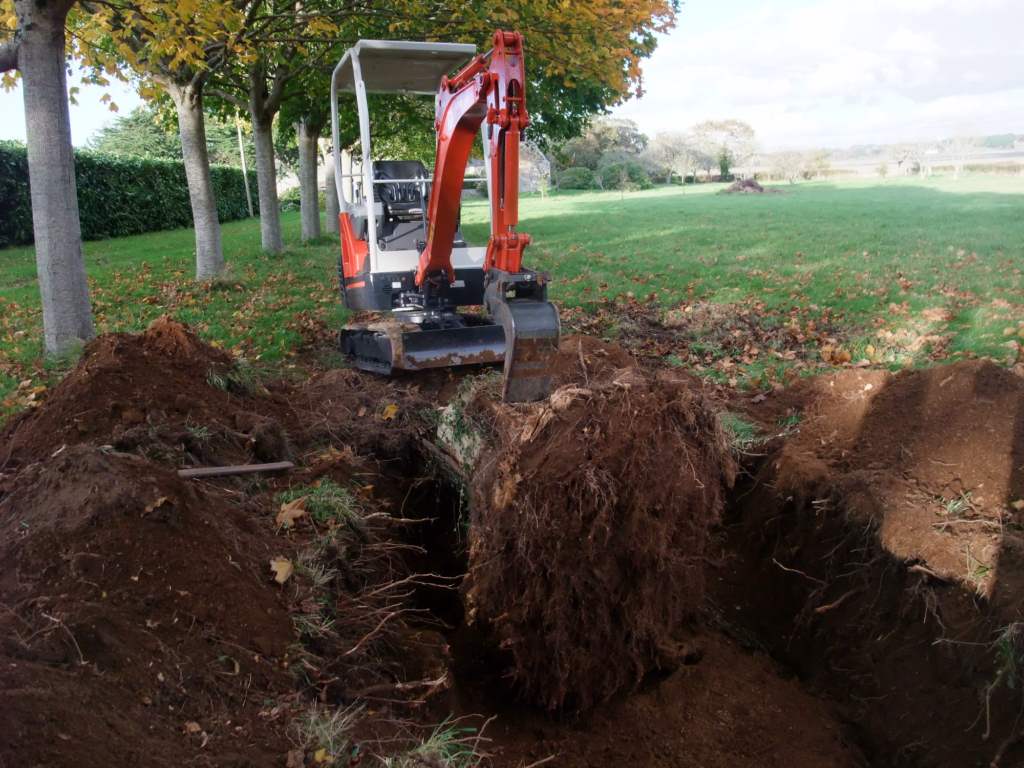

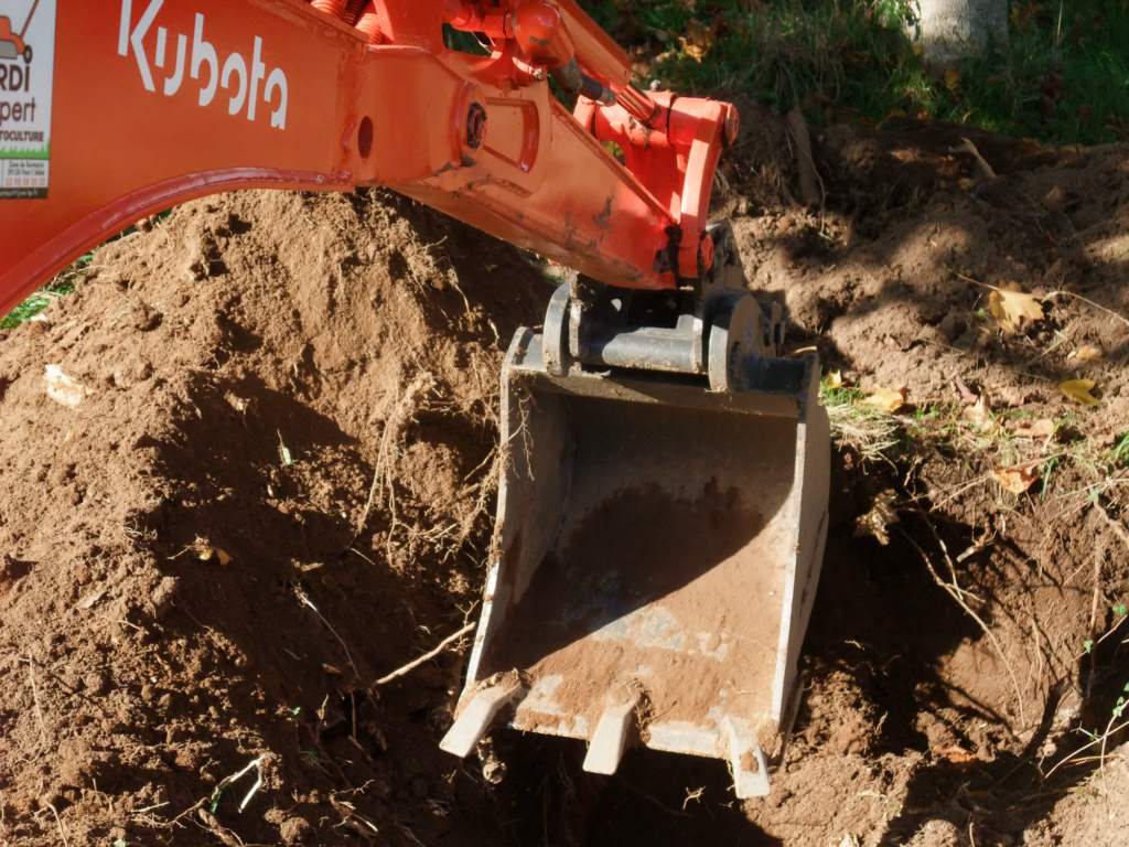

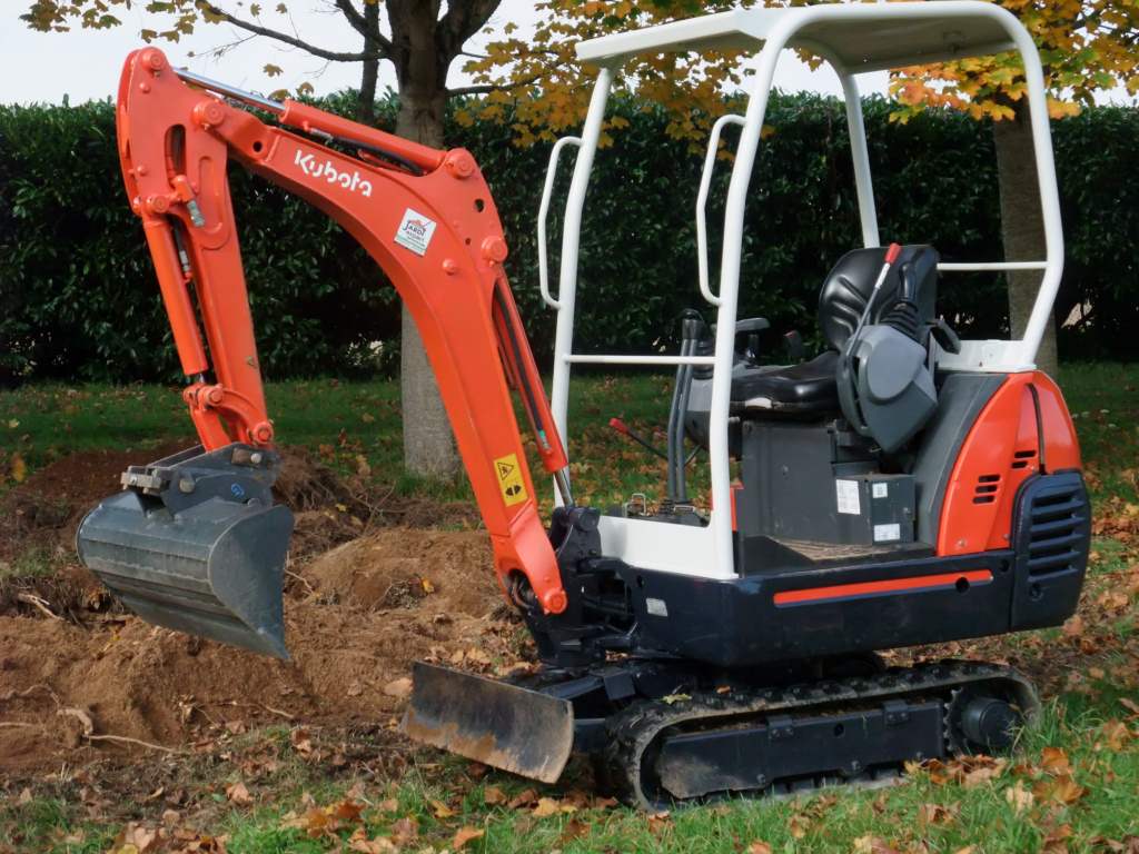

Hi,

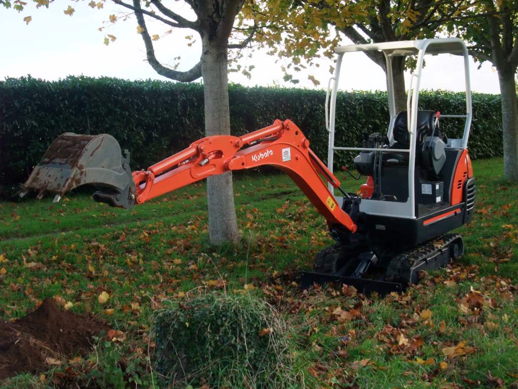

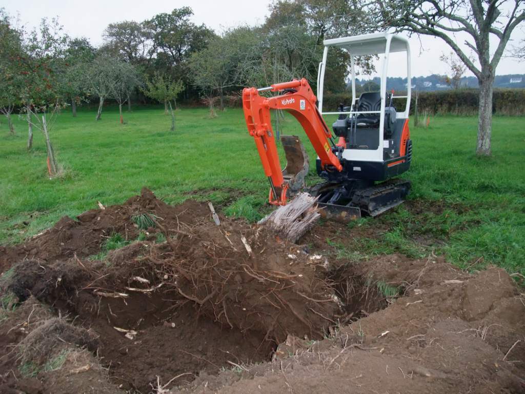

a few months ago I was in your situation, looking for a mini digger to remove the many stumps left by Atlantic storms every year here. I had read everywhere that I needed at least a 3 ton machine for stumps. This was good news as European regulations have changed recently and 3.5 ton machines can no longer be towed behind pickups or trucks as used to be the case and everyone is getting rid of them, so they are cheap and there are many to choose from. Unfortunately, there's no way a 3 ton machine will fit in my barn. So I ended up bying a smaller more expensive machine, a 1.5 ton Kubota 2009 KX 36-3 (I don't know if my fellow John Deere enthusiats will speak to me again). I'm amazed at the work this small machine can cope with. I found it hard to believe the dealer when he said it would be enough for planting trees , digging out stumps, clearing land etc. But it proved to be true. Of course it takes longer than with a big heavy machine, but it's just perfect for me.

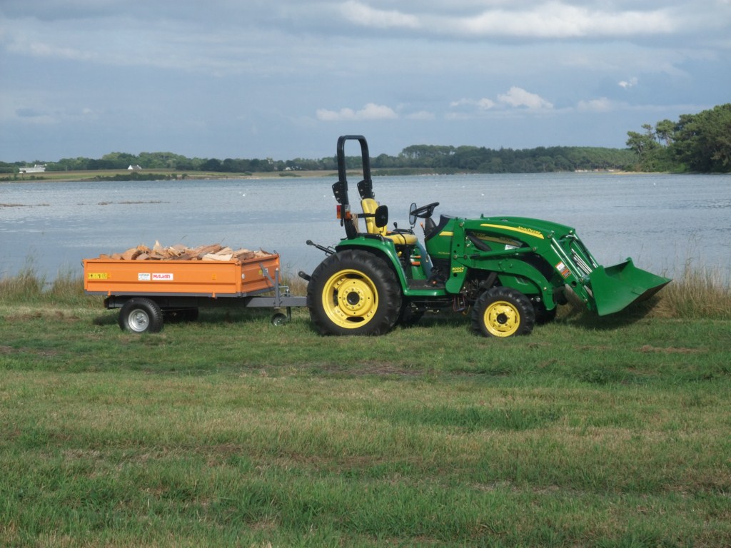

If productivity is your prime motivation, get a bigger machine, like the Terex you have in mind, it will save you some time.
The last mini digger I hired before I bought the Kubota was a 5 ton Neuson and although it's difficult to compare stumps, the result wasn't all that different, you would need a really big machine to pull the stump out without digging around it first. I usually carry logs and stumps to the burning site with the tractor rather than the digger so I don't need a thumb, but I have been told that Santa Klaus is bringing me a a superb ripper to deal with the bigger roots.
I have very little experience with midi diggers, but tend to stay with people who produce the whole machine, including the engine, like kubota or Yanmar.
By the way, the photos were not taken in the south of France but on the Atlantic coast of Brittany, a different climate again ...
I'm sure the digger will make a great difference in your rehabilitation project. Best of luck.
