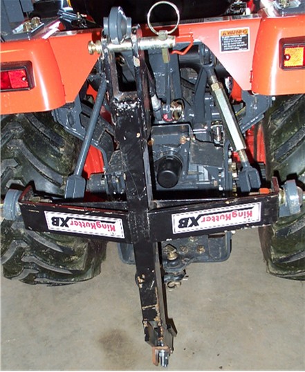

King Kutter makes the XB line of implements that are designed (so they say) to specifically work on the sub-compact tractors. I bought the KK XB middle buster/subsoiler several months ago. The product quality on the one I received was terrible but after a few minor modifications I got it to work on my BX2200. I used it to lay some underground electric fence wire and it worked great. Next year I plan to lay a couple hundred feet of water lines using the subsoiler.
The KK XB product is the right size for the BX tractor. If you can get by the quality issues that are present in some KK products it will do the job for you.
Picture attached.
John

I also have the XB series middle buster from King Kutter. Problem with mine was I had to spread the upper flange apart somewhat to get my top link to fit. Once I got everything to fit it works great.
Dave...
/ Middle Buster/Subsoiler for BX2200 #5
I had had to spread the clevis to get the toplink to fit also. With mine the paint was poor (bad runs and rust), sloppy welds, wrong hardware to mount the subsoiler blade. Even the KK logos were installed upside down. I talked to KK about the problems but they didn't seem to think that any of the issues mattered as long as I was able to make it work. They were pleasent to talk with but I could tell that they wern't interested in hearing about any quality issues.
