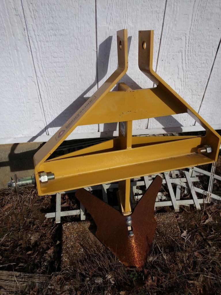

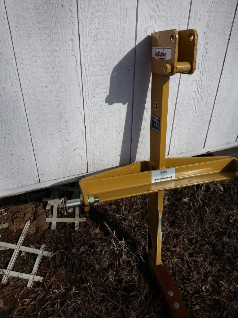

I would suggest looking for a subsoiler that you can mount a middlebuster plow on. The reasoning (and I learned from experience) is that while they sort of look the same the frame for the subsoiler is heavier and more solid. I bent the frame of the Countyline middlebuster I bought and I'm just using 30hp. Of course, some of that may depend on the brand.
First one is the middlebuster frame and the second is my subsoiler.
