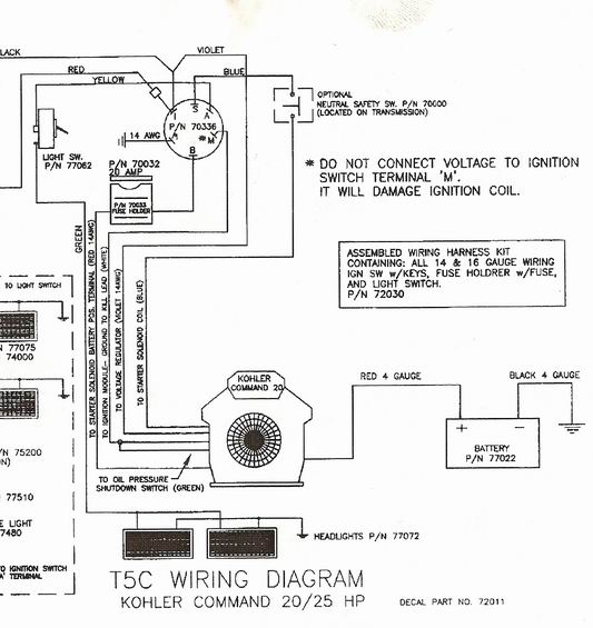

Question: My starter key switch is beat up, and I wonder about putting a push button start switch right on the dash; anyone
recommend a quality push button starter ?

my 76 T3-15 came stock with a push button and toggle switch. when I upgraded to a new engine it came with a key start. after review i would pick the key start. only because there are less parts to fail.
   / mid winter checking in #6
T-M ignition wiring and switches are quite simple but one thing you need to be aware of is that some engines are 'ground-to-run' and some are 'ground-to-stop'. Ex: Honda GX-620 is GTS and GX-630 is GTR if chosen as replacement. Honda includes a fuel stop solenoid in the carb bowl in addition to T-M's behind the dash. These and light switch are what's powered in ign 'run' position. Experience gained when helping a fellow TBNer to upgrade from GX-620 to GX-690 and work around the 'reversed' switch/engine details. (Kohler and others will be one or the other type.)
Auto parts stores carry generic replacement switches that include an 'M' terminal and start position for use with GTS motors. My OEM switch had been replaced and the wiring cobbled for not including 'M'. 'Shut-off' was achieved by fuel starvation, and when starting up there was a 'cranking interval' to refill the carb. I was able to reconnect a mis-wired relay to the coils and lo oil shutdown switch for normal function with a 'wrong' ign switch.

Thanks for helpful info. My keyswitch (Kohler Command) works, but is pretty worn. A new one from T-M would be nice, would fit the mounting hole,
and avoid the GTS / GTR problems but probably very expensive. Now if the mounting holes are standard . . . . By the way, what's the "M" stand for?
   / mid winter checking in #8
'M' is a switch terminal that is used to ground-out the coils in the 'Off' position, what to look for if you are GTS. True to form, T-M switch mount hole fits those you'd buy from auto parts or mower shops, and they run <$20 where I see 'em.
Determining which your Kohler has is as simple as disconnecting a coil primary wire while running (no zap) and see if a cyl cuts out. If it does, you are GTR. If it stays running you'd want the 'M' terminal-equipped switch, or could use a relay as workaround like I did. tog

Here's a scan of the electrical page from the manual. I see the "M" on the switch
