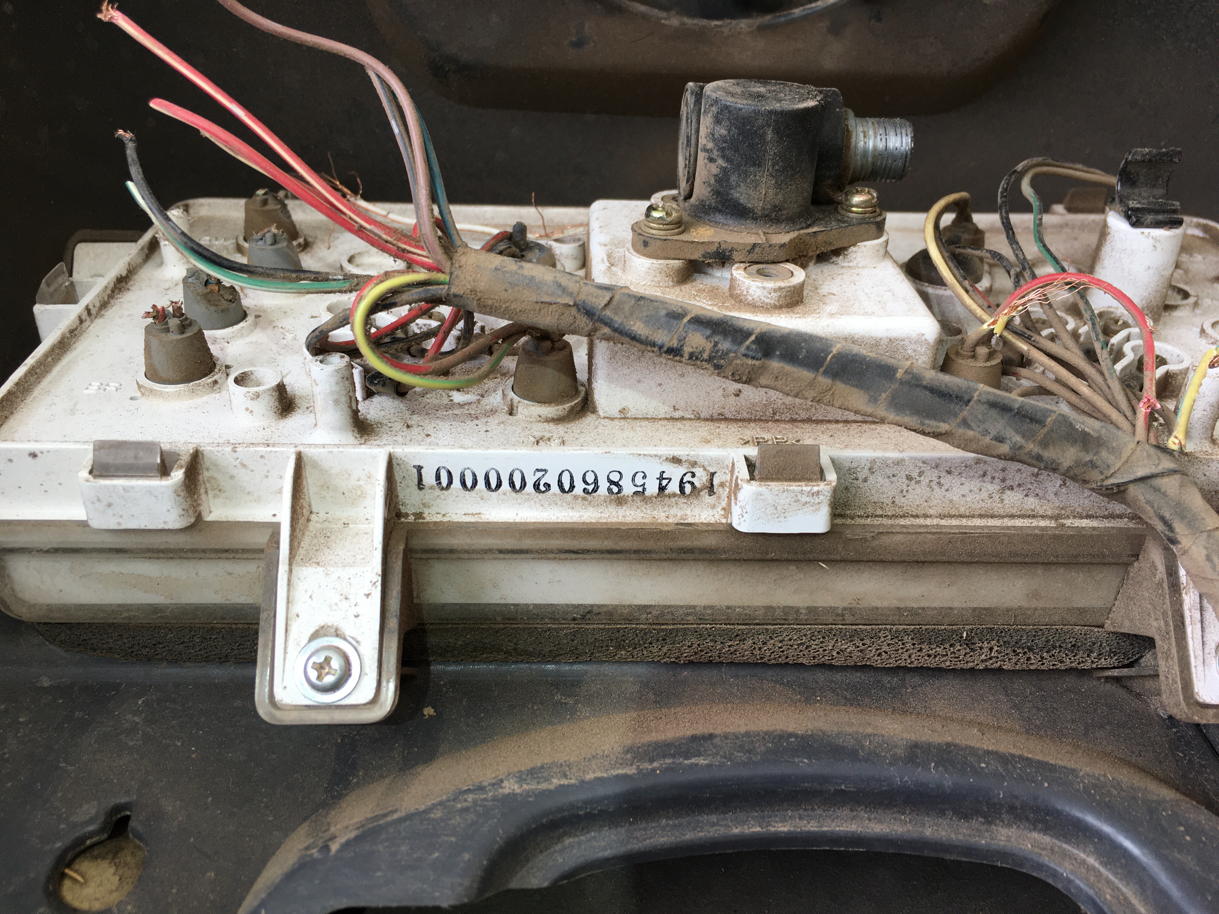

Mice did their thing to my wiring harness! Went to start the tractor yesterday and nothing. Disassembled it and found this- little *****!!
I can repair the parts of the main wiring harness that were chewed but I think I'm going to replace the Dash harness section as it's too trashed- UGH!
Couple questions-
For the main wire harness repairs- anyone know the wire gauge size on the harness?
(I'd like to order the right color/ stripe/ wire size to keep consistency in the harness. Any vendor contacts on where to order short lengths as well appreciated.)
The dash harness section I'd like to replace is labeled Mitsubishi. Anyone know where I can get one besides my local Mahindra dealer? Maybe somewhere cheaper or some type of Mitsubishi distributor.

unfortunately i don't have much to offer either. the dash cluster itself is mahindra's..... working on my uncles 3215 and i googled for a better service manual (high hopes...lol :confused3:) and found the cub cadet 7530/7532 service manual. they are exactly the same tractor. only physical appearance was the dash cluster is different...
not sure why they make them like that but u can't even replace the hour meter separately...

Most times you can cut back the rubber plug some so you can expose enough wire to solder on to. Take the time to get the right color-coded wire and use heat shrink tubing or a hot glue gun.

If the wiring harness has 2" or so of slack [ vehicle manufactures usually make wires AS SHORT as possible to make an extra half cent on each vehicle ], and you can get the back off the dash.... you may be able to repair it making connection internally using the existing wire. I would clean the back off and explore the wire color going into each entrance point. Then make a good map, or write right on the white plastic by each spot what is going in there. Not saying you can find enough everywhere to discern what wire colors were what, but it may be possible. If it was mine, I'd try it. But you should explore the cost of getting a new dash/harness from the dealer, too. At least see if they are avail, and how much. I set traps outside any time I see a track in the snow, and keep my house and barn critter proof. Keep all my vehicles inside, too. But that ship has sailed for you.
