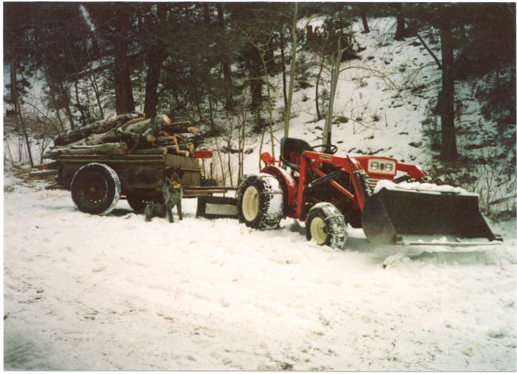

When we had a little 4wd turf-tired tractor that we used for firewood in the snow, we put lightweight chains on for traction. Gotta be double careful with chains on, though. Sometimes with a load we had trouble getting a tire to slip at all.
rScotty
