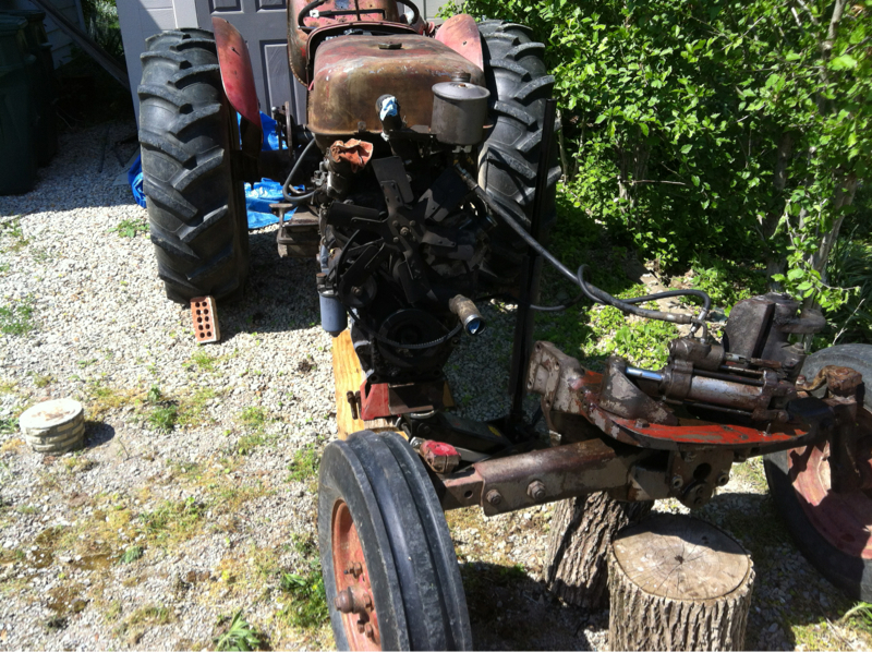

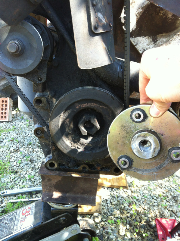

@dieseltech ... Okay, I took the front end off, and it looks like I need a different pulley? Ugh!!
I am going to have a dickens of a time mating the front end back up. Time to borrow an engine hoist, me thinks. ;-)

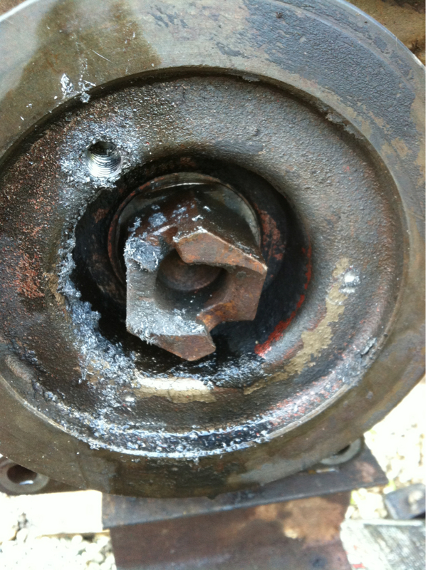

The good news is that it is possible to drill and tap the holes for the pump drive plate.
The bad news is that it is off center just enough that I don't like it. I figure that I have at least two more tries worth of room for re-drilling. I'll jb weld the bad holes closed to avoid future confusion.
I had better pull the pulley off and take this to my drill press though, this was quite a job with it on the tractor. :-/

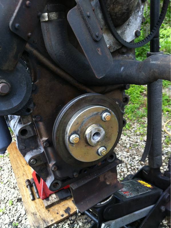

Well, third time's a charm. I got the drive plate mounted.

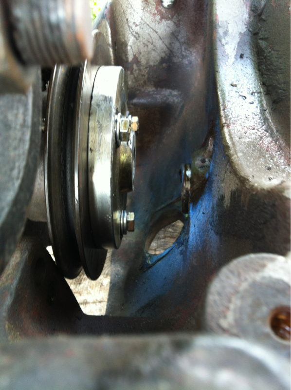

Problem is that as I was mating the front end back to the engine, I noticed that the front end pivot is totally obstructing the bolts for the drive plate.
This picture is with the front end pulled about 4 inches away from the engine.
What is the prescribed remedy, spacers?
   / MF65 FEL Pump Drive Rod Machined... #8
Drive plate looks thicker than it needs to be, may try to countersink drive bolt holes in plate to get bolt heads below plate surface. Allen head bolts may be used too if needed to keep countersink holes smaller. If spacers are used at front casting support hood and grillwork will no longer fit as they should. Best to rework plate as needed for clearance.
