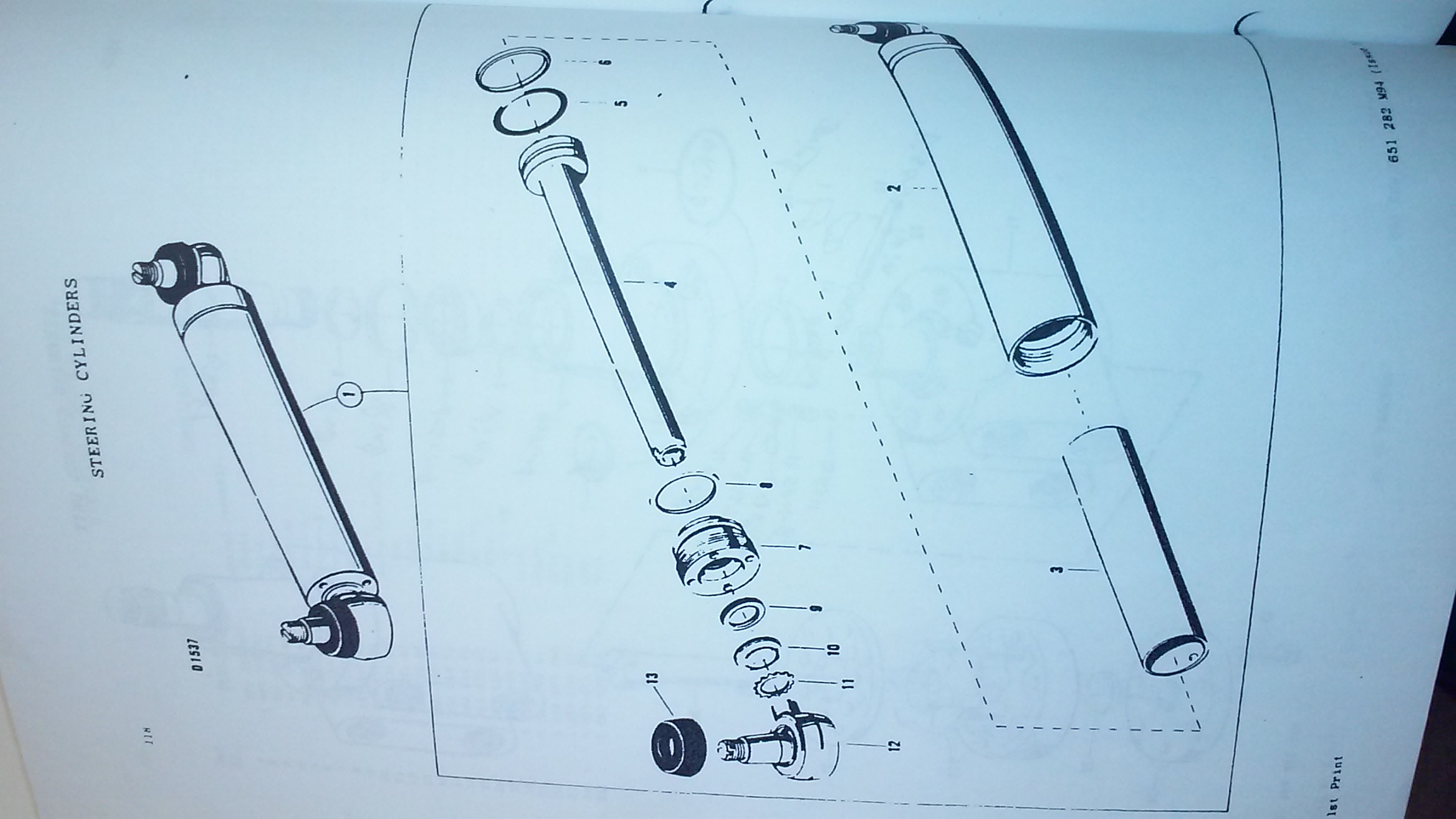

As you say, seal kits and time will take care of the leaks. I believe my pump is Ok, it has light steering while there's oil in the system, but leaks a bit. The other issue I'm facing is worn joints on the cylinders - I have to find out whether replacement joints are available, otherwise have them rebuilt (a rather pricey process) or come up with another pair of cylinders with reasonable joints on them.
   / MF40 Industrial power steering problem
I know the joint on the rod end is replaceable, part #1033035M92. I don't recall if the barrel end is threaded or welded and the parts diagram doesn't show it well. These diagrams aren't always accurate either. Either way, the joints are standard size and easy to get, but you may have to weld-on the barrel end. As long as the rods are good, cylinder rebuild is easy and cheap. The rods on mine were rusted/pitted and had to be replaced, ended up spending $200 per cylinder. The cylinder joints were good though, just had to replace the boots. Tear one down and see what you have. There are a few of these in the salvage yards.
