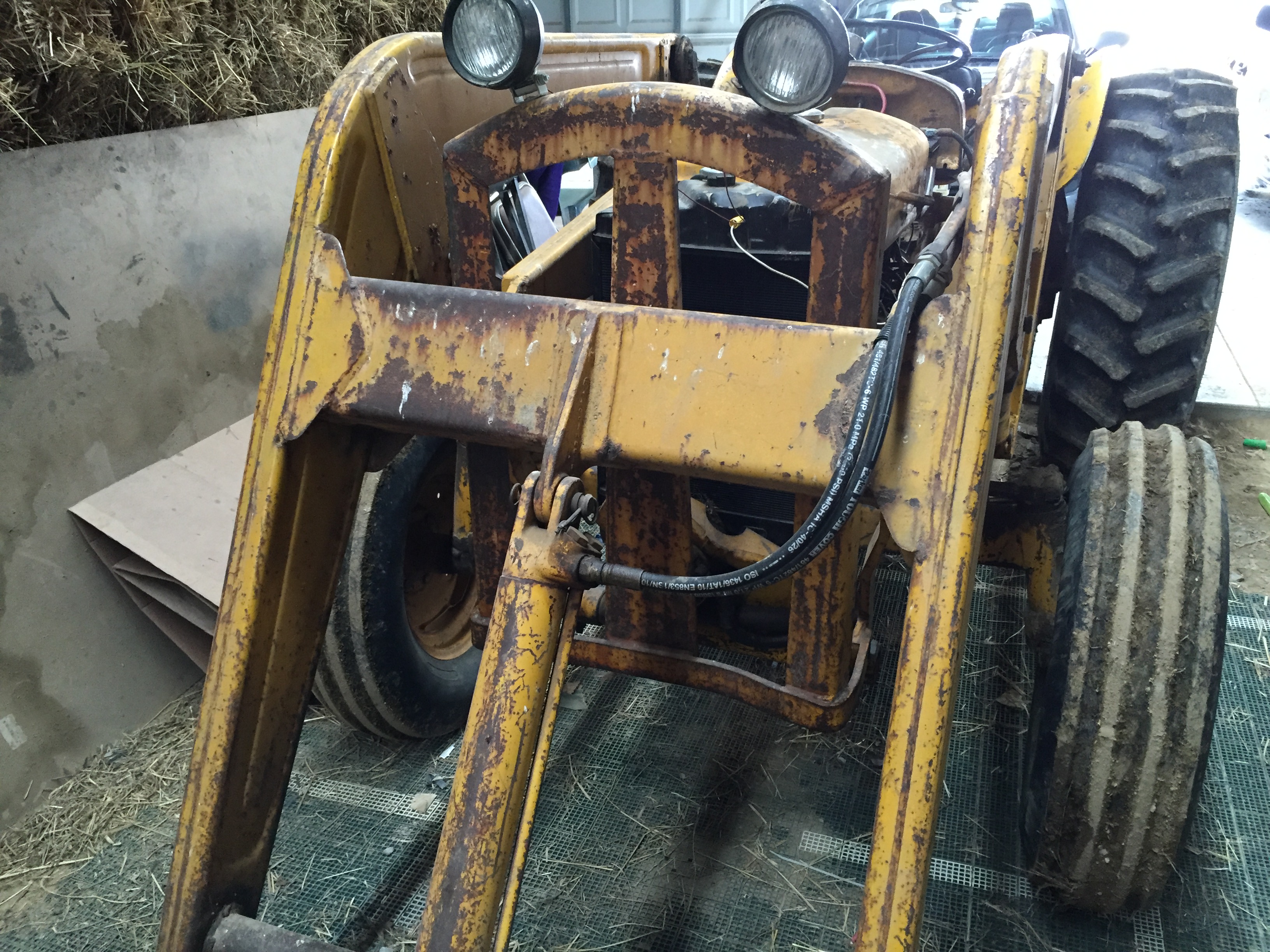

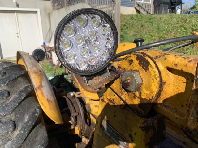

I am replacing the headlights on my MF35 utility. Again. They used to look like this.

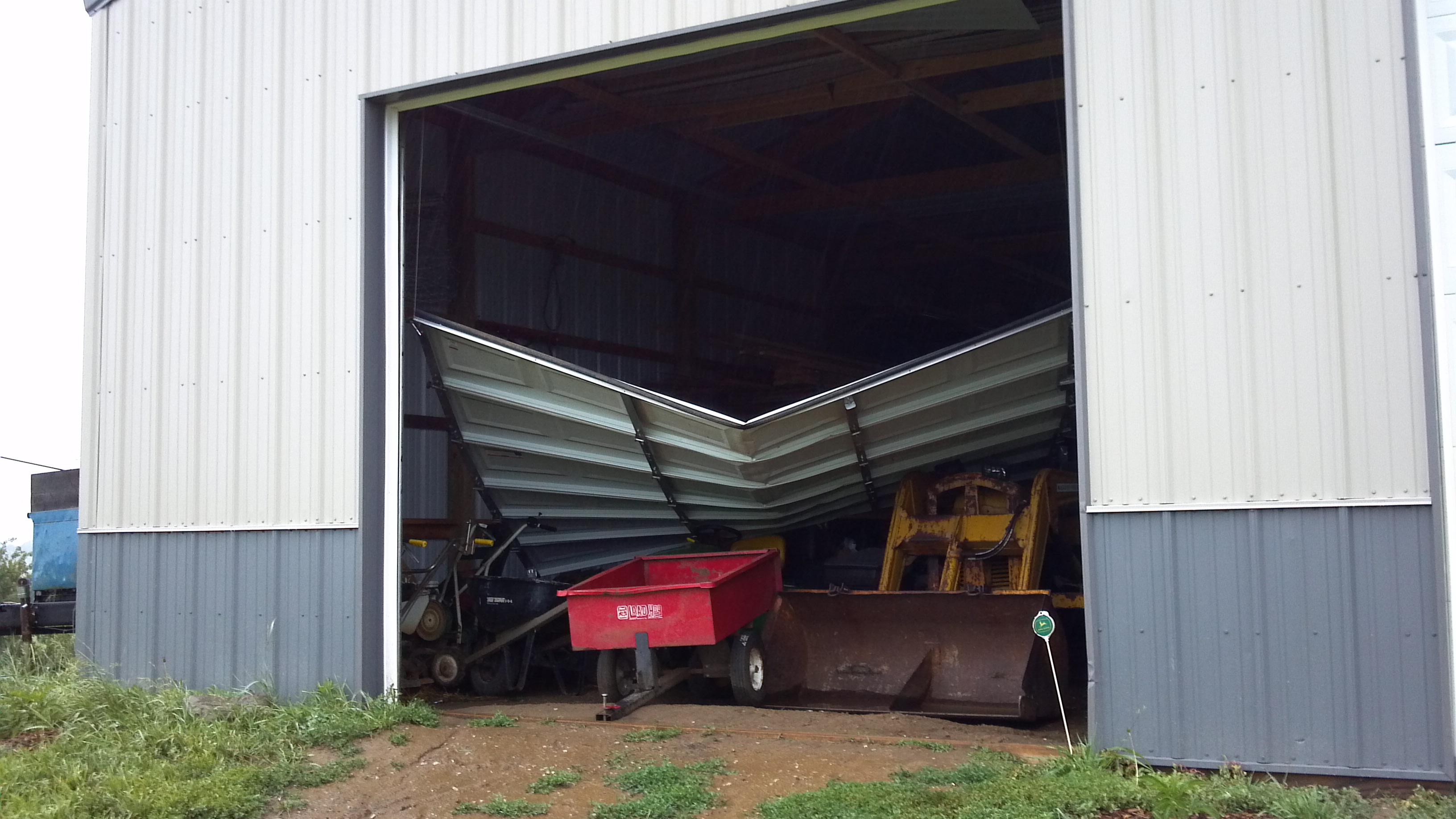

Then they got crushed when a wind storm blew in the overhead door, which then landed on the tractor and took out the lights.
So I bought a pair of these and mounted them in the same place, on top of the bumper or whatever it's called.

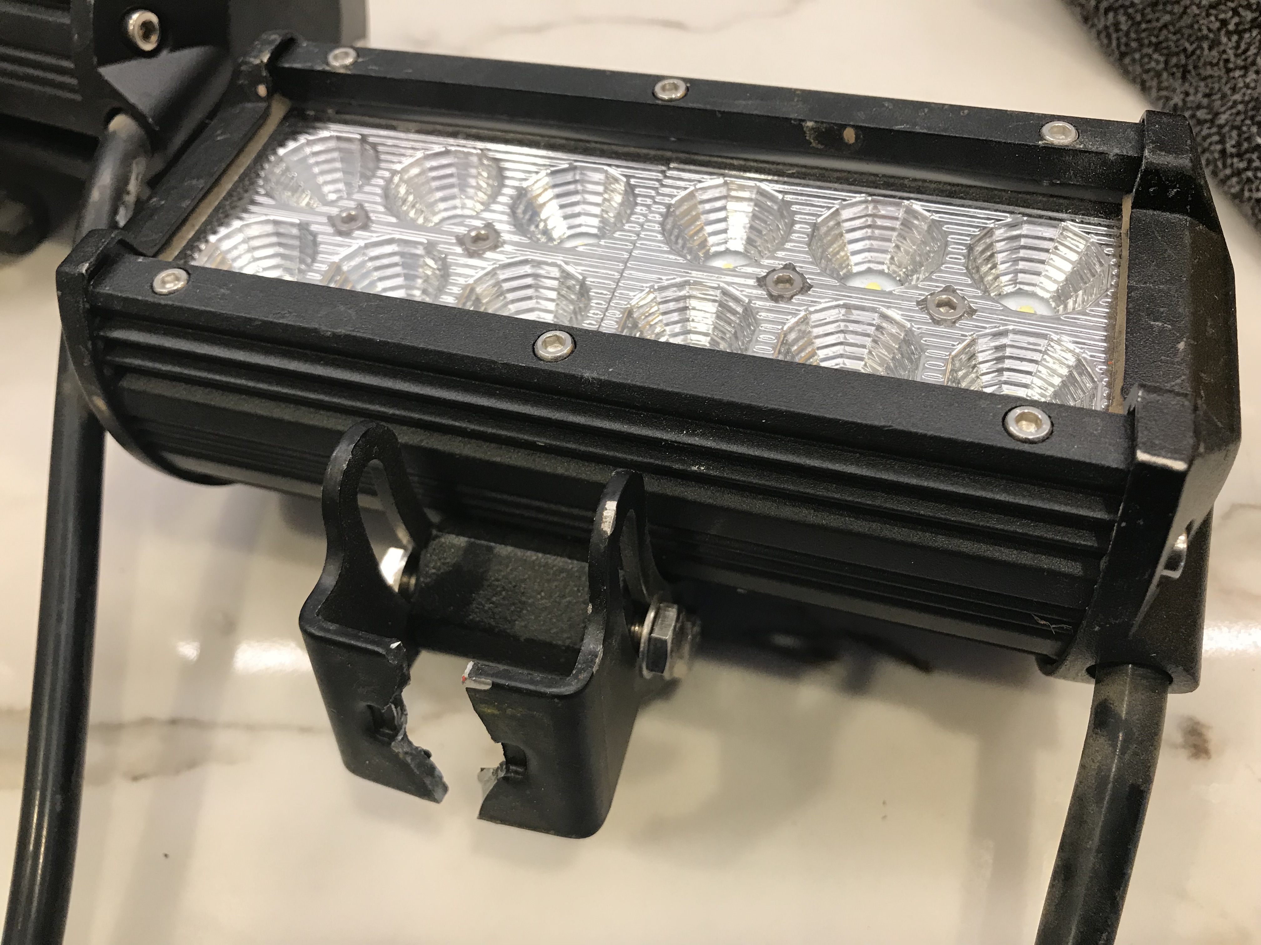

Then a couple of weeks ago I left town and it snowed here. I got a text from my son saying he cleared the driveway for me. Helpful, right? Except that when I came home, there were no more headlights on the tractor. Just a cut wire dangling in front. His explanation? "Crappy mount then fell off at same time when I was pushing snow". :eek:
The lights still work but i need new mounts.

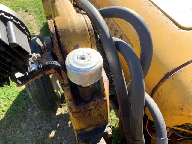

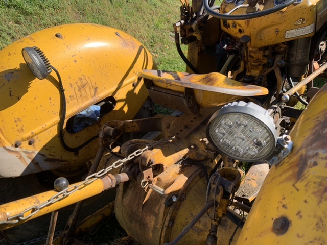

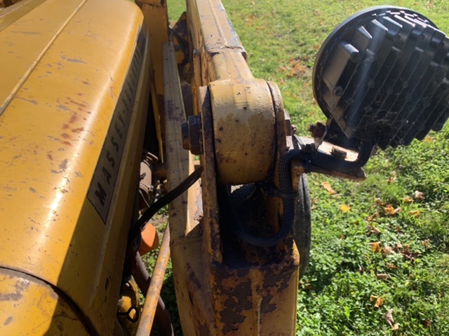

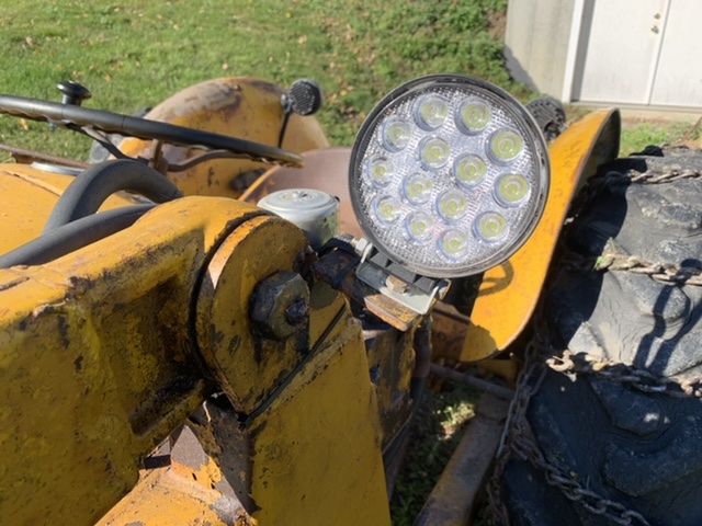

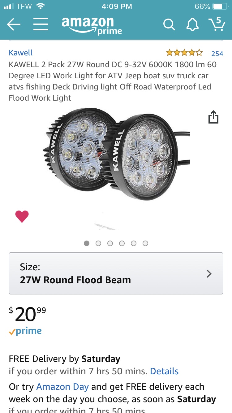

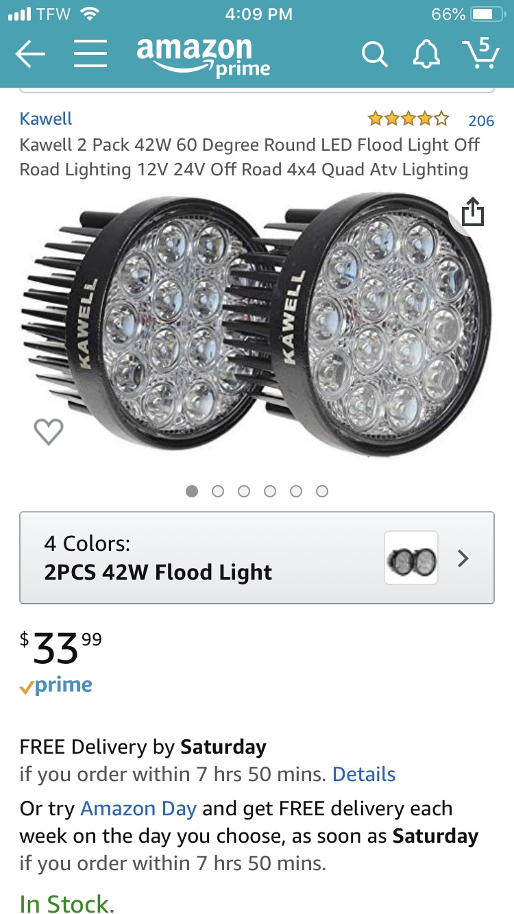

I use Kawell brand 42w LEDs mounted outboard of the loader arms on brackets. I use two 27w versions for the rear work lights. Plenty of light, looks like a UFO landing in my yard.
I have them wired on a three way switch, so up turns on the front lights, middle is off, down fires all four lights. I bought them off Amazon, they’ve been fantastic. No moisture ingress, all LEDs still work, been using them about three years.
Edit- nice thing about mounting on the loader uprights is that raising and lowering of the loader arms doesn’t block light output and temporarily blind you.

Until then- there are small “L” brackets welded to the uprights on my loader frame with holes in them. The lights come with stainless “U” shaped brackets and nut, bolt, lock washer.
I’ve clipped the lights with tree branches while brush hogging several times, the lights just flip backward, or forward. I keep the pivot bolts semi-tight to allow for movement and prevent breakage.

Here are some pics:

Thanks for the pics. Looks pretty straightforward. Just a piece of angle iron welded to the loader frame right below the pins.
   / MF35 headlight options #9
Yep, that’s it. Pretty simple and effective.
