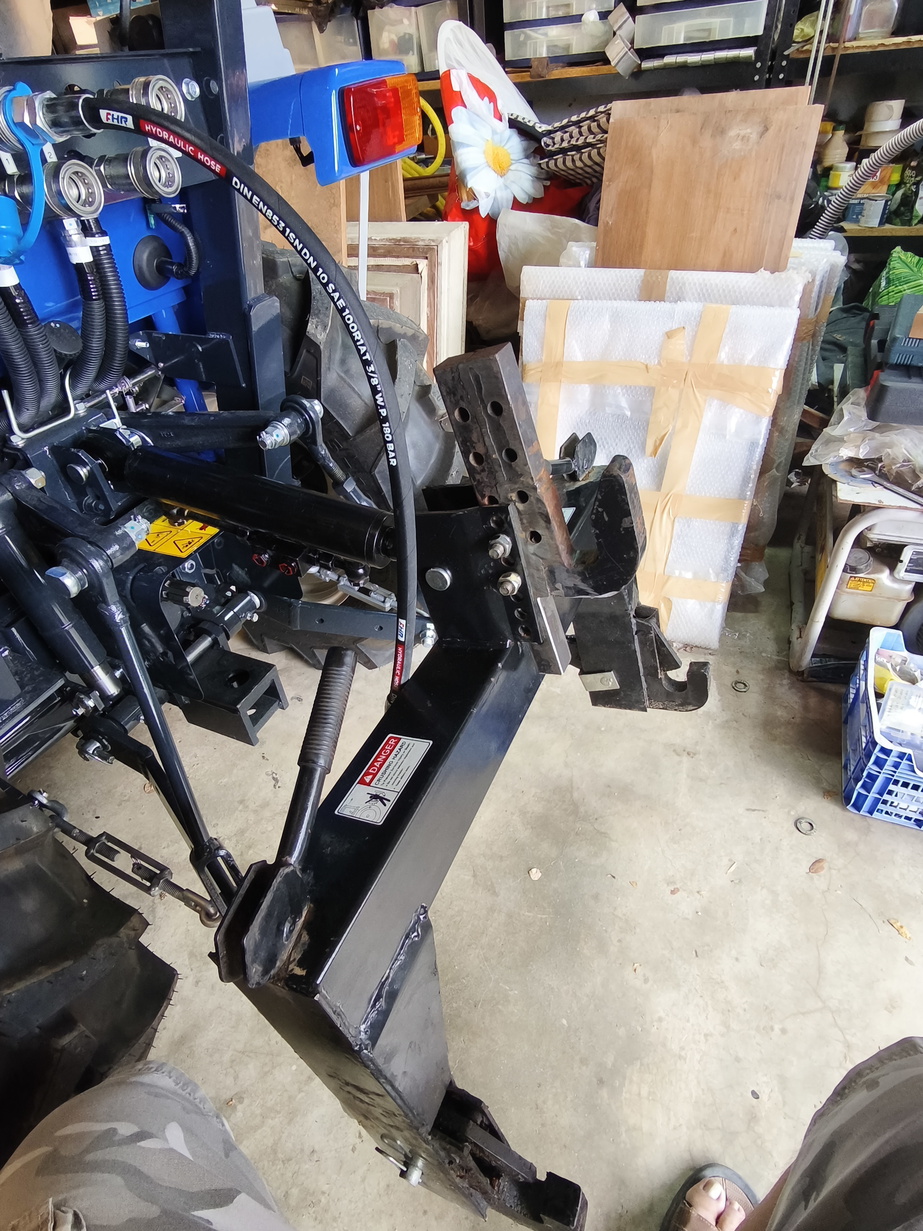

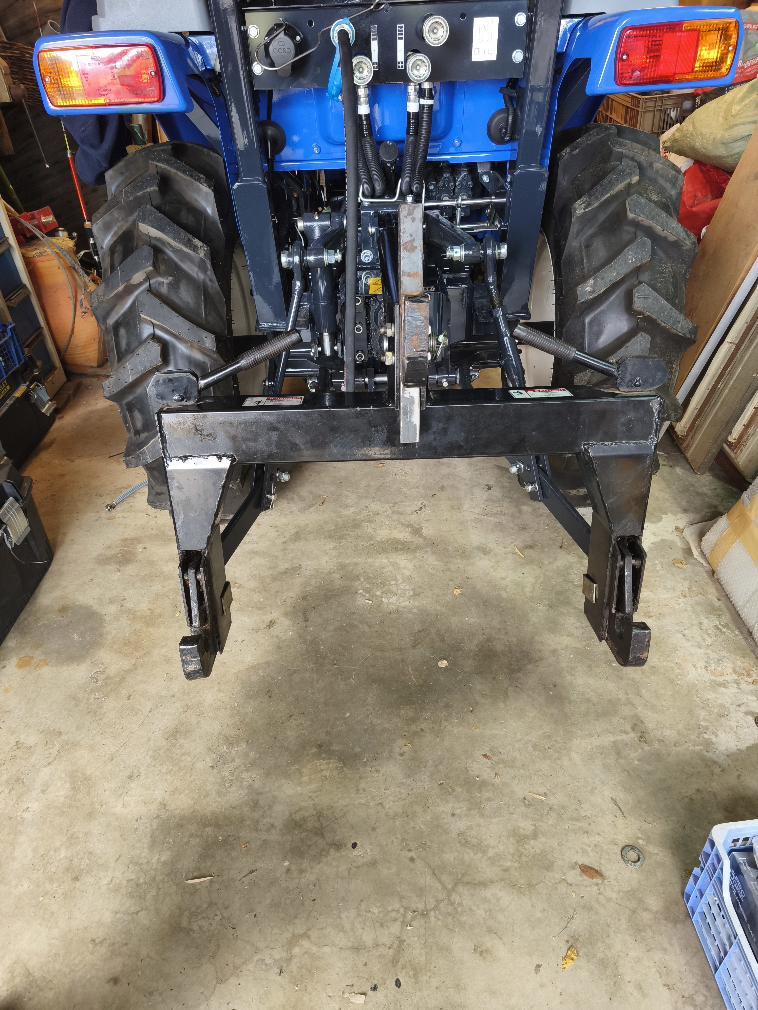

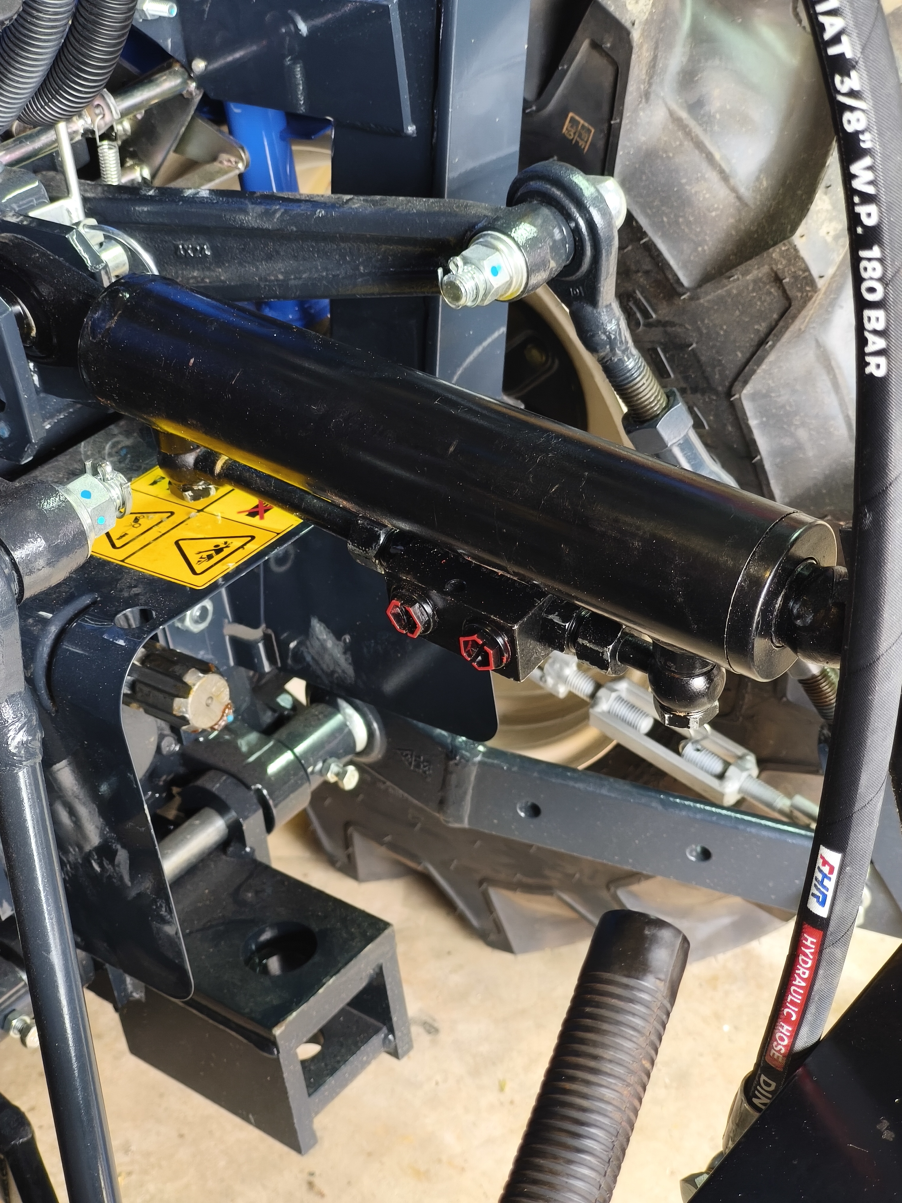

As I said on my previous post, this three components cocktail is tricky.
The hydraulic 3rd point comes from sparepartsholland.
To mount it on the tractor one need to need to reassemble the check valve and turn it horizontally so that it's as far away from the tractor as possible. If you don't do that the check valve will bump into the hydraulic fluid filler pipe. You also need to rotate it 90 degrees so that its outlets are positioned to the left or right of the cylinder. Even doing this, a problem remains because one of the cylinder's feeds comes into contact with the PTO guard if the lift is lowered too far. I'll think about how to solve this problem.
