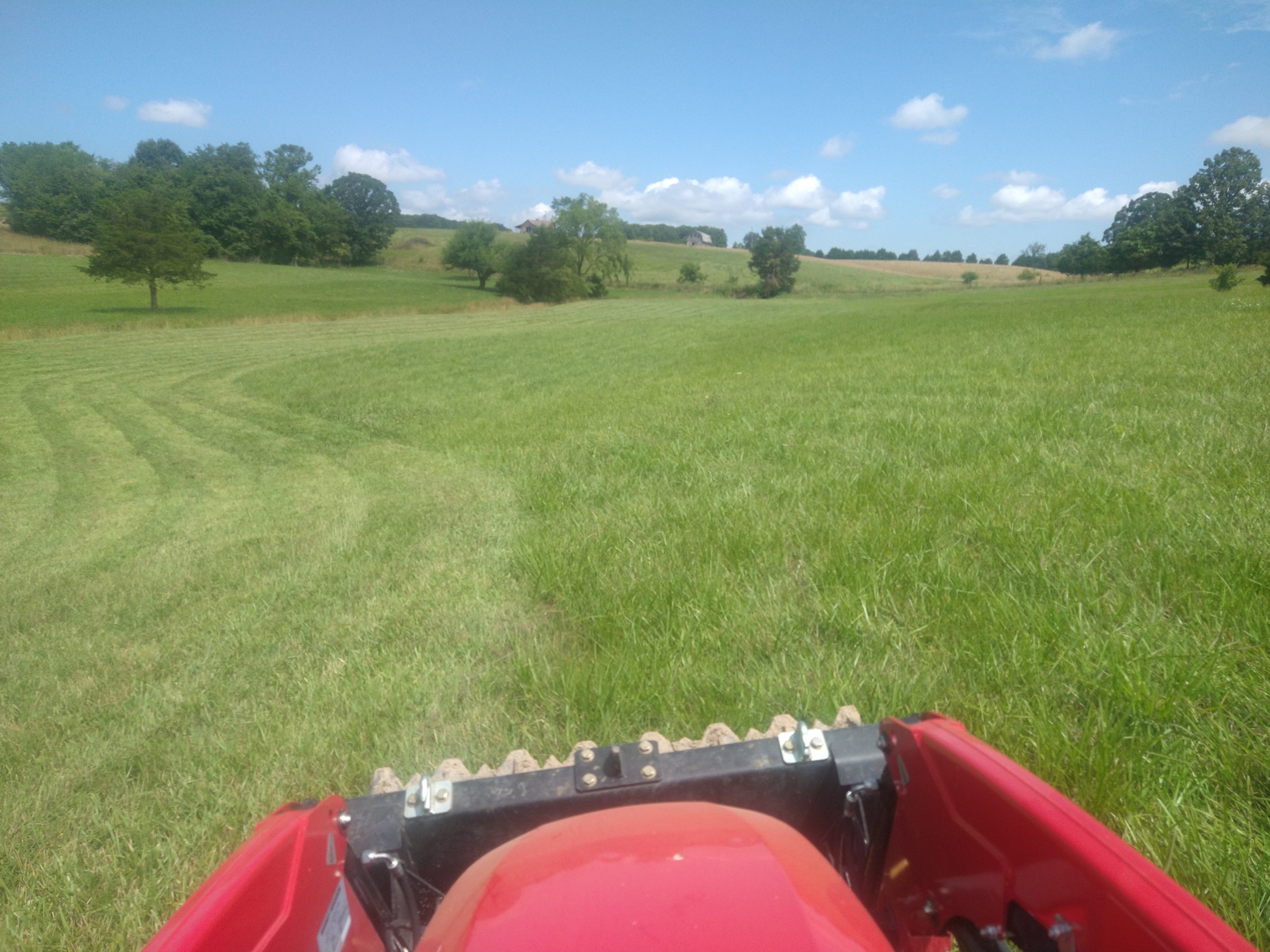

Thanks for your comments. Your terrain looks similar to my field; mine might be a bit steeper in spots. They tractor doesn't seem to have any issues with power regarding handling the hills and running the mower. I keep it in low range on the HST. Unfortunately, the temp gauge does not change color as it climbs to higher temps.
My goal is to make my field look more like yours. Unfortunately, this year spring was so wet I couldn't get the machines out in the field until the grasses / weeds got out of control. I always wait till things are dry before mowing.
