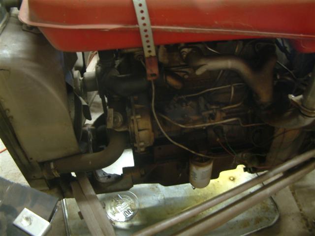

I have recently bough a 135 and realised that the temp guage is not conected to anything. I am going to try and reconect it but cant for the life of me find the sender. Can anyone describe where I will find it please??
   / MF135 Temperature sender #2
Here's the location on my 1964 MF-135 diesel. Follow the cable that loops down near the oil filter. The temp sender is screwed into a hole on the engine block right behind the water pump assembly.
