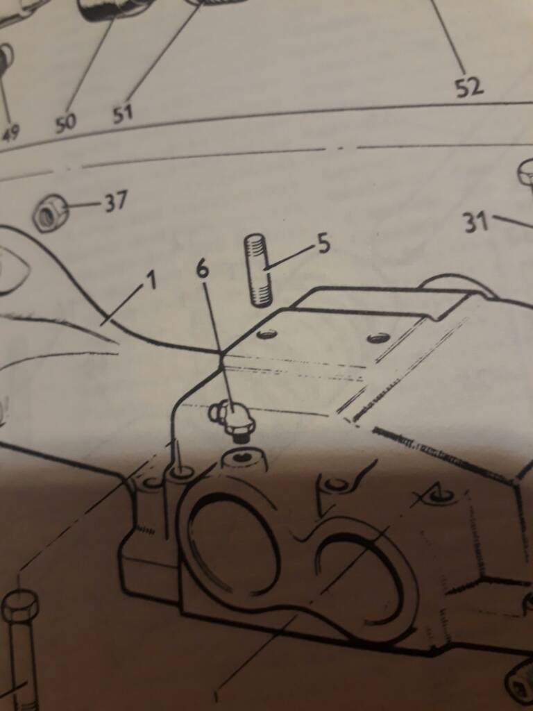

   / MF135 Seat Bolt question #5
   / MF135 Seat Bolt question #10
Can be replaced by a bolt 7/16unsx1"
The short answer is Yes - 7/16"UNC x 1" might be a tad short - from memory about 3/4" of thread in the casing. With a spring washer and through the seat frame 1&1/4" might be right. You need to extract the remains of the rear stud though - soak it for a couple days with suitable fluid and be patient. Alternatively, drill the stud accurately down its centre and chase it with a thread tap.
When you bolt the seat on again ..... grease the threads generously! :thumbsup:
