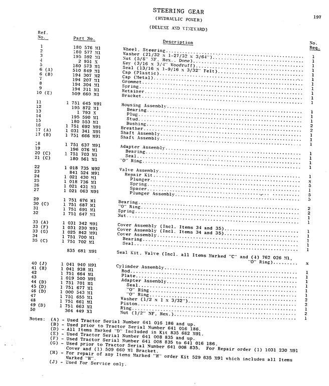

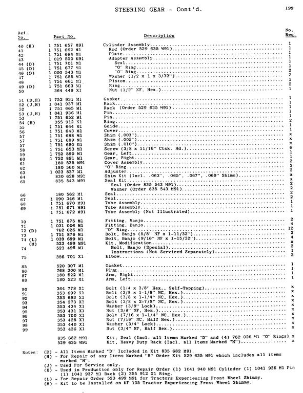

I have a 1964 MF135 diesel deluxe with PS and multipower. I haven't torn into the PS system yet, but here are the pages from the parts manual.
MF135 steering-1 (Medium).jpg MF135 steering-2 (Medium).jpg MF135 steering-3 (Medium).jpg
What you call a hydraulic motor looks to me like a pretty simple hydraulic cylinder (ram) that moves a rack part of a rack and pinion mechanism. Shouldn't be too difficult to repair in your shop. Same for the power steering hydraulic pump. I repaired the hydraulic pump on my 1951 Minneapolis Moline BF tractor a few months age. No problem.

Thanks for the info. Your repair manual is better than mine. Mine did not show the exploded view of the steering box (what some call the hyd steering motor). The steering box looks like the tough thing to tackle not knowing what part of it might be bad or what typically goes out on them. It does come appart though and it should reveal itself once appart. I have not seen a kit offered to rebuild it though. I do see the small hydraulic cylinder attached to the steering box and if that is the issue than that would be a easy fix but mine has had leakage out of the side shaft so a bearing, sleeve and/or seals are likely involved.
Based on your experience rebuilding the hydraulic pump I will try that first. Mine has the "Cessna" pump and it is pretty simple. Thanks again for the help. Hopefully someone will add to the thread regarding getting into the hydraulic steering box.

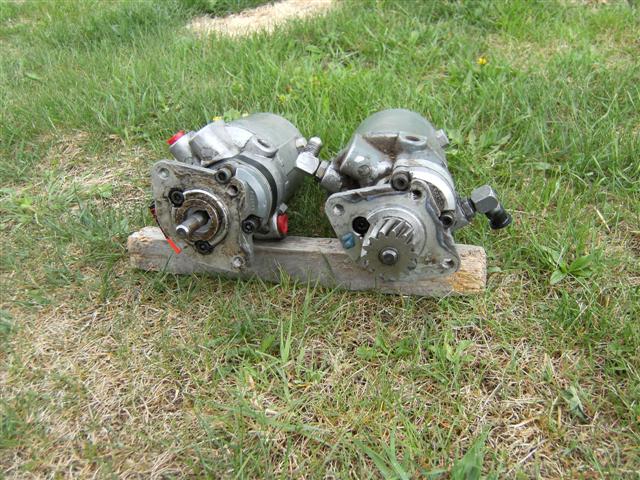

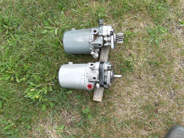

In reply to your post in Parts & Repairs about having to remove the timming cover etc:.No I highly doubt you need to do that if its anything like what the MF 165-MF 175 have for a pump they come off by removing just 3 bolts.There hard to see but there there.One is between the block and the pump almost have to do it by feel and I do belive it better accessed from underneath the pump.I've taken a couple pics of the pumps I've taken off and installed different ones back on.If your pump looks like this your good to go.I know it almost looks and seems like you need to pull the timming cover off but believe you don't.Look really close and careful you'll find the bolts.Larry:thumbsup:

I'll throw something else at you.Does the pump on yours have a reseivour as well and is it possible that you need to take the resevour off first in order to access bolts holding the pump on.I just thougth I'd mention this { I could be way off base as well} a diagram of some sort sure would help you out thats for sure.Larry

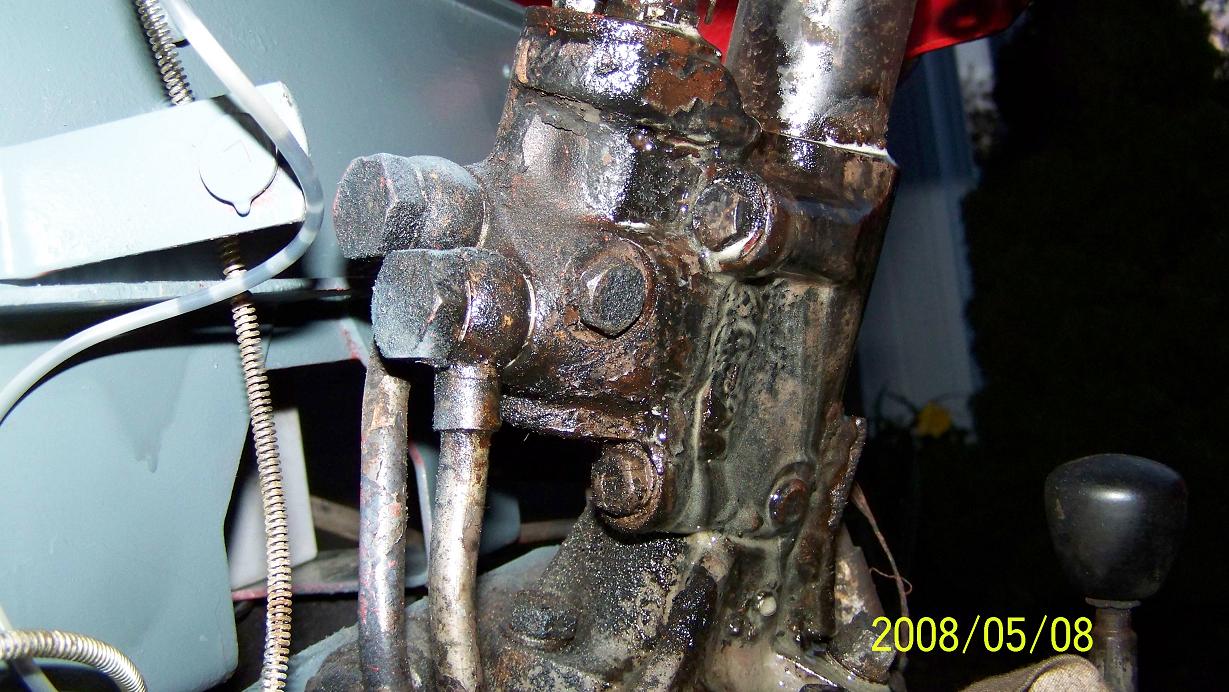

I had the power steering actuator on the steering column that connects to the steering cylinders off mine and rebuilt it. It just contains a bunch of O-rings. Buy yourself one of the large O-ring kits and a tub of white grease. It took me a couple of attempts to seal up all the leaks, but 3 years later I find that it is leaking again. All the o-rings were rock hard and fell apart the first time I dug into it. Worse off now on my 135 is something bumped my Oil filter (making trails through heavy brush) and I almost seized the motor with a major oil leak. I have a conversion kit and spin on oil filter that I will put on it Saturday. For the power steering, lube all the o-rings well with the white grease for ease of reassembly and to prevent nicking any O-rings.
This was a before shot, never thought to take pictures of dissassembly.
