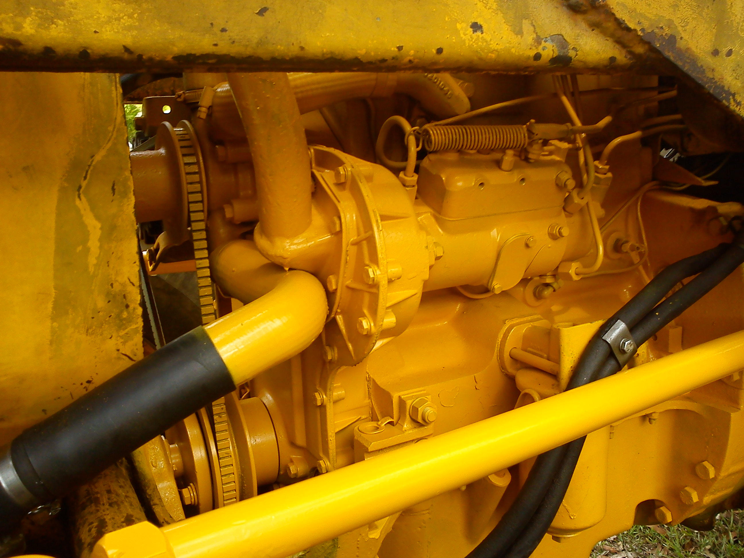

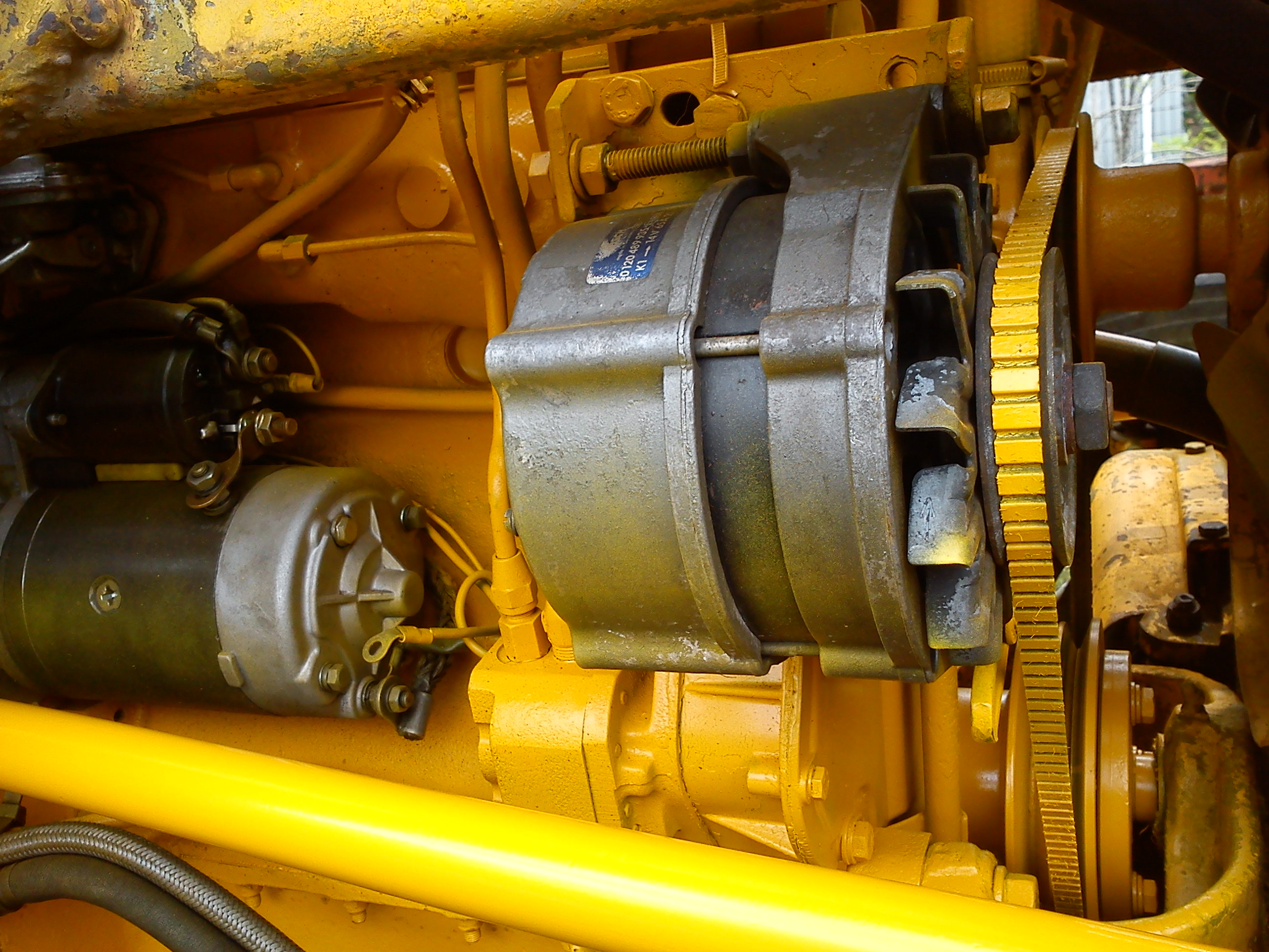

Hi, I recall very similar symptoms with the 3cyl Perkins diesel in my MF40. I had recently bought the tractor knowing it had some issues that required rectification. One was a severe oil leak from the rear main seal. I didn't fill the oil past the low mark - it only leaked out more quickly. Whilst helping a friend prepare a site on a hillside for a large plastic water tank we must have faced uphill with a high engine load for too long ... the result was a spun con-rod bearing in No1 cylinder - a result of it receiving the bubbles instead of the oil. The engine could barely run under its own power - I shut it down immediately, but the damage was already done. I removed it and dismantled it for inspection. Aside from also fitting liner kits and bearing sets, the con-rod required resizing and the crankshaft big-end journals reground. The engine today is like a new one. You can remove the sump separately and inspect the situation, but it is incredibly heavy - use a floor jack (on wheels) and a really unpleasant job. The chances of being able to repair it by simply fitting new con-rod bearings are very slim anyway. That said, as long as the rest of the machine is in reasonable condition, repair it properly.
   / MF135 Perkins Gas seized
Is there a good rebuild manual for this engine somewhere?
   / MF135 Perkins Gas seized #8
It is a considerable amount of work, but the satisfaction of having it working like a new one really does make it worthwhile.
It gives you the opportunity to sort out other engine issues as well - all in one job. I hope it all goes smoothly.
