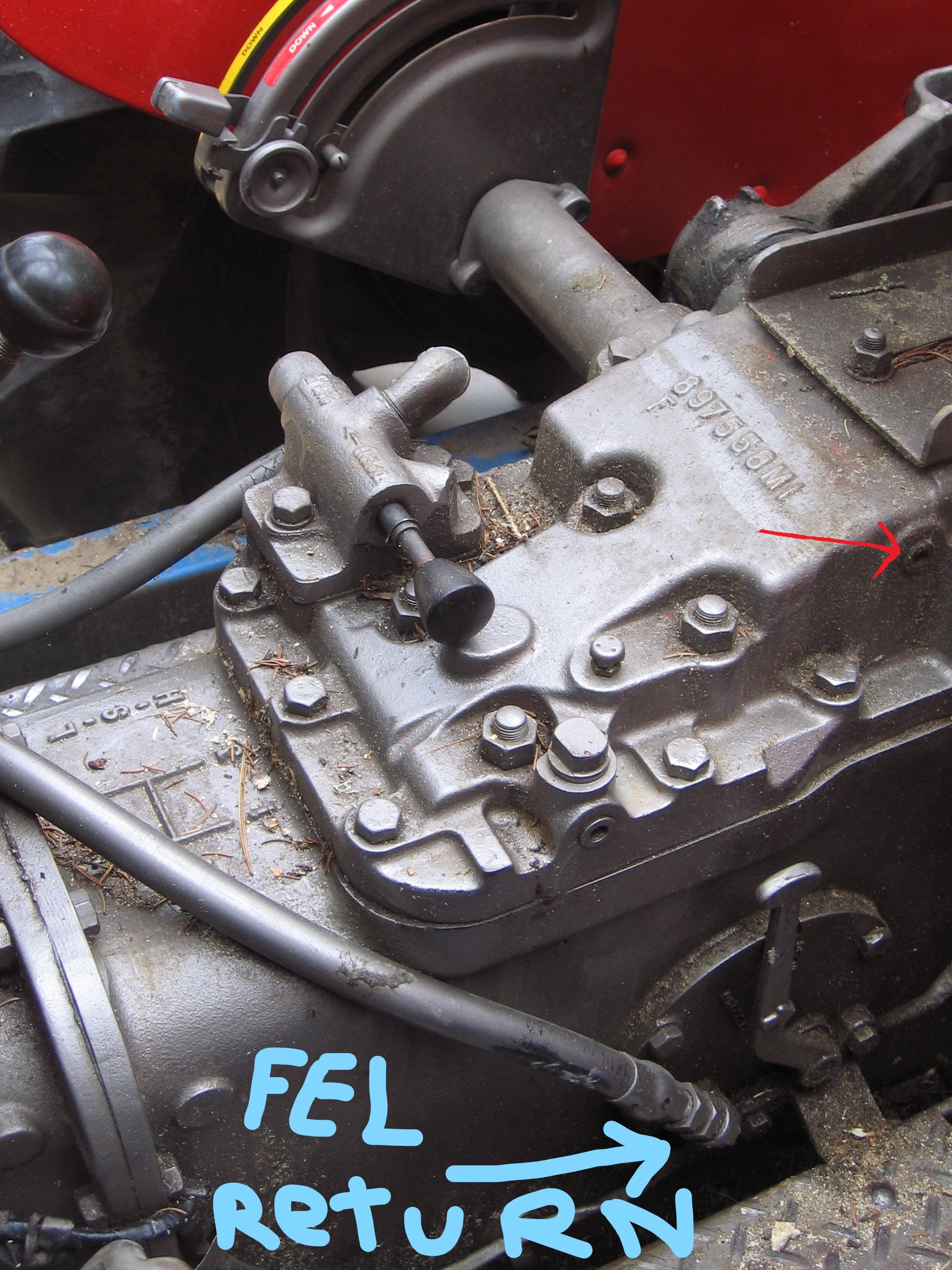

I want to add remote hydraulic at the back of the tractor. I already have a fel. Can I add a TEE where the fel return is already connected, and connect the new hydraulic return?
Is there any other option where I could connect a return hose. What about the hex nut pointed by the red arrow? I know some have modified the filler cap but that would be my last option I think.

That under the seat is made for return.
   / mf135 hydraulic return, what are my options #3
I'm not sure about the red arrow but going into the transmission fill port is one option and you could tee into the loader return.
