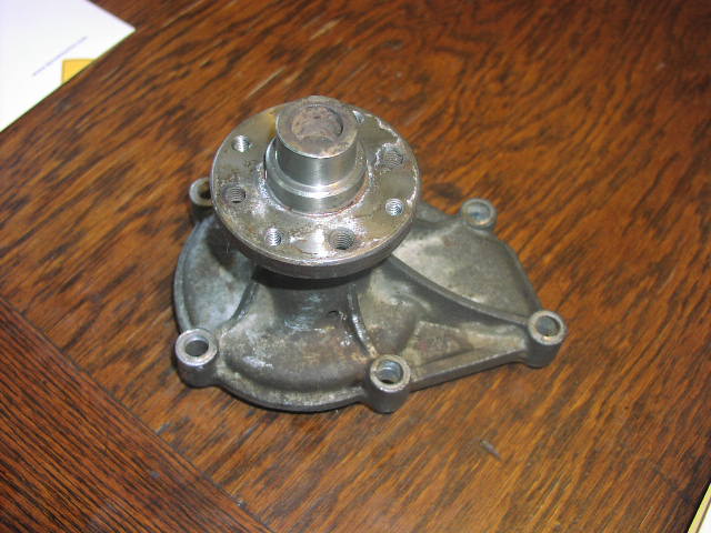

I have an Iseki TA275F, which is very similar to a Massey 1240/1250, and the water pump is leaking. I do not know if they share the same pump. I am posting a picture of the pump. If am owner of a 1240/1250 could give me an opinion regarding the smiliarity or lack thereof, it would be appreciated.

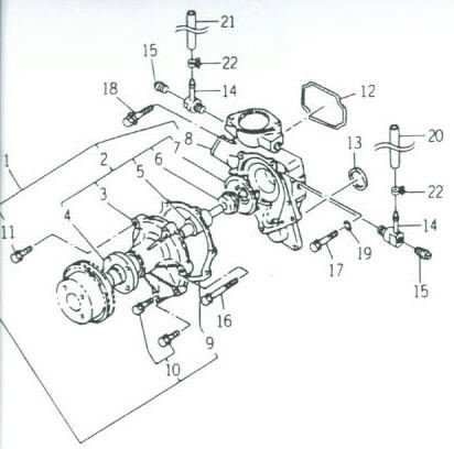

I went out and looked at my MF 1250. It looks like the same thing, the best I can tell.
Here is the picture out of the parts manual. The picture actually looks really close to the real pump.

Jerry, thank you so much! I pulled my Iseki parts book and the pages look identical as well. I would be fairly sure it is correct. My Iseki part number for the assembly is 6213-610-001-00. Do you have a Massey Number? I think I will order one of these tomorrow. Iseki has a rebuild kit, but it would be two weeks away.
Thanks again!

Pacesetter,
We were thinking along those lines as well, the seal was leaking and it allowed the bearings to get wet and they are ruined. We need bearings and the seal as well of course. We messed with pressing the shaft out for a few minutes without success. The hub pressed off OK, but the shaft is being stubborn. I'll probably get a new pump for this one, and rebuild the old one for stock. By the way, the Iseki TL1900/2100/2300/2500 seems to have the same pump.

The MF part # for the pump assembly is 3704181M91.
