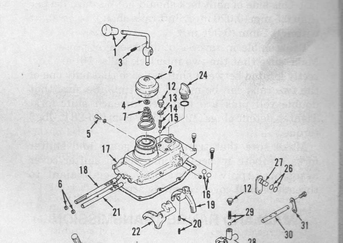

Hey Lambs-
The 1020 is different from the 1010. When I ordered a 1020 owners manual, I was told that the 1010 was used for the 1020. The shop manual, for both models, seprates the models a varrious points, including the manual transmission.
MF1020 Transmission.jpg The attached drawing of the 1020 shows only a screw on fill cap (at 12:00 from the shift lever). The 1010 has a fill cap at 1:00 and a dip stick at 11:00. Where to check the level on the 1020 remains a mystery. The parts manual dosen't help finding an overflow bolt.
You are correct that the fuel pump uses the same motor oil as the engine. The owner's manual says to put 6 1/2oz of motor oil in the pump, but says nothing about checking the level, ant mark, or over flowing into the crank case. The shop manual ignores the pump oil.
Well let me know if you find the overflow source. In the mean time;
Keep plowing,
Fred

Funny how that diagram you posted looks like the one I would have seen had I consulted the I&T shop manual for the two tractors! Of course you are correct. I cannot find a reference to it, and the only operator's manual I have is for the 1010, so I can't see the 1020 procedure. I'd be guessing, but perhaps the technique is to unscrew the fill cap and just look down into the trans housing to see the level of oil.
I bought my 1010 Operator's manual off eBay several years ago. You might want to see if you can find a dedicated 1020 manual there and buy it. The other option would be to find a forum that covers the other brands of this tractor. I know Allis Chalmers, Simplicity, and Hinomoto all sold the 1010 under other model numbers of their own. This may not be true with the 1020.
I had occasion to remove the gear shift assembly from my 1010 and I think the oil level was just over the bottom of the gears in the trans so it would be picked up as the gears turned under power. But don't hold me to that one.
Of course you could call a dealer I guess and ask. My local dealer used to have an employee there who owned a 1020.

For all those with an MF1020-
Transmission level. On the side of the transmission there is a bolt about half way between the shift lever and the floor boards, a inch or so in front of the fill plug. This is an overflow plug. Fill the transmission until it overflows from this hole.
Fuel pump level. Remove the fuel filter and the plate that is held in with two bolts. Below this opening is a drain plug. Drain and refill through the plate opening. HOW MUCH you ask. There is no reference, but 2 rumors; 6 1/2 oz and overflow goes into the crank case. If you have a for sure answer to this, please let me know.
