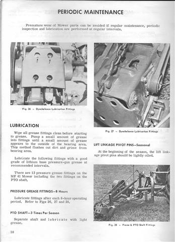

I have a MF31 sicklebar. Got the guards/ledger plate assemblies at Tractor Supply as well as sickle sections and nuts/bolts for the sections (which I refer over rivets).
Here're some photos of the MF41 head

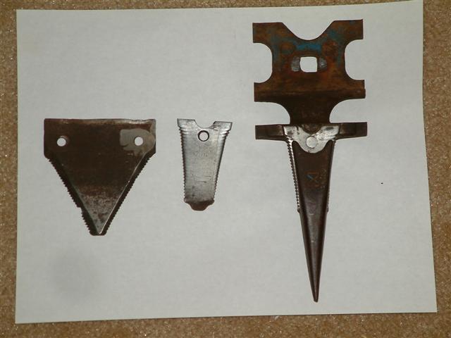

Another option--use the guards you have and replace the ledger plates.

Sorry, but I'm new to sickle mowers.
What's the ledger plates??

The ledger is the removable cutting plate on the guard. In this photo, left to right, sickle section, ledger plate, rock guard
