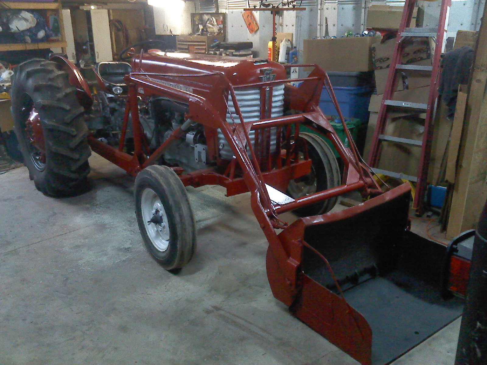

Here is a picture of the tractor done. thanks for all the help .:thumbsup:
