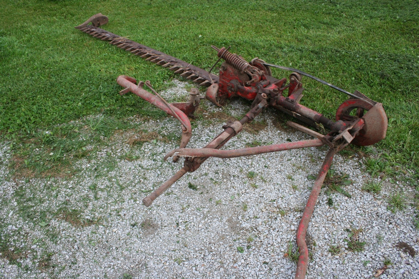

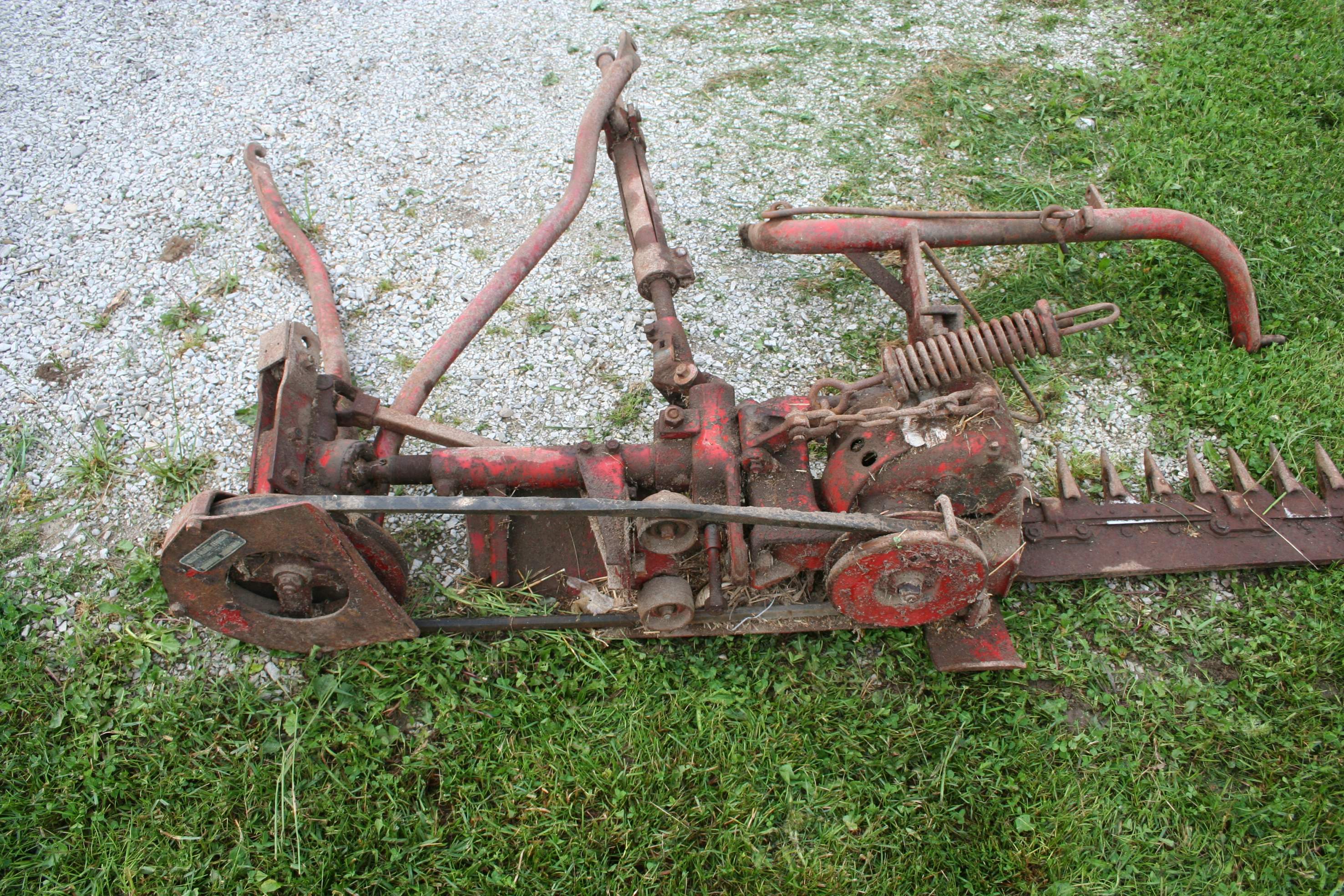

I scored this MF sickle mower at an auction this aternoon. I believe it is a #41 but not really sure. It's missing a few parts but i think it was a deal for $20. Now to clean it up and get it ready to cut some hay.

Sorry I cant help with the ID, but it is definatally a deal for $20. It's worth more than that for scrap price:thumbsup:

Not a 41, it has a similar "cast" 31 head on it and looks to be a belly mount model? What does the ID tag say? Ken Sweet

Thanks Ken, The tag is too worn to read. I know nothing about sickle mowers. The guy standing beside me at the auction said it was a 41.

The 41 has a weldement housing around the cam and gears and the older 31 has a cast housing around the same. The 2 big cam needle bearings are $90+ each. Ken Sweet

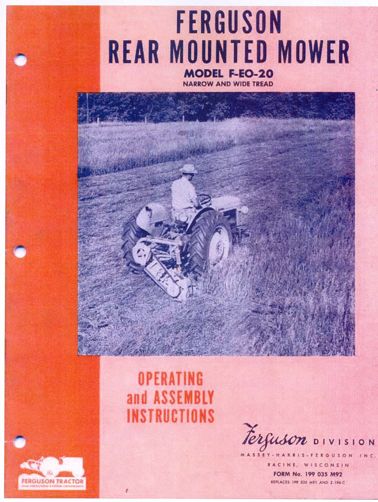

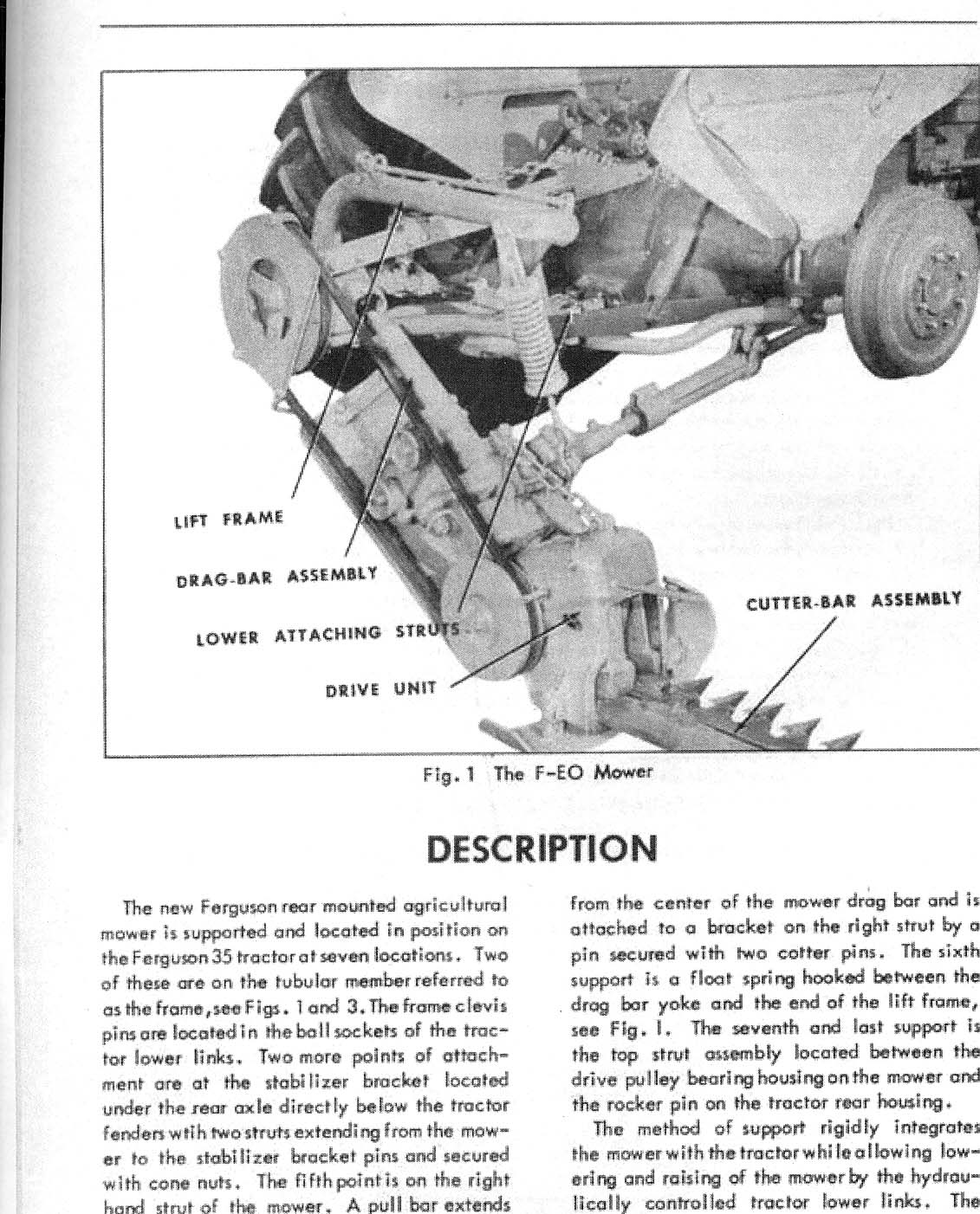

I think I have found the manual for this mower. i believe it is the F-EO 20 Mower. It may be a lot of work to convert to 3pth.
